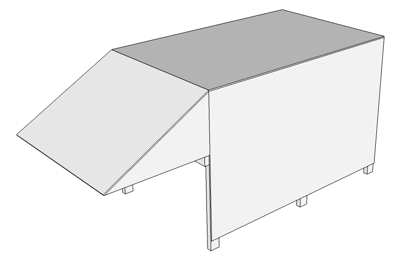

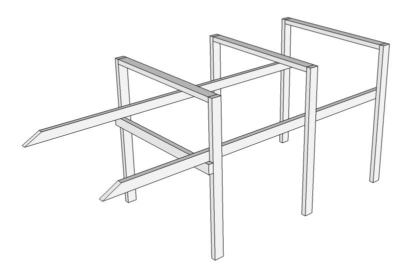

My impulsive sketchaholic tendencies prevailed, and I've drawn a picture to illustrate my point about the sloped front. I really don't think it would be hard.
Build a skeleton like this...
Then skin it with OSB or plywood like this...
If you made the sides 4 feet high you could use full sheets of plywood on the sides without having to cut them. Or is your bed shorter than 8 feet?

moving to warmer weather, getting too old for the cold.
So for ease of construction and rainproofing I just built 4x4x8 boxes, with rain detailing. gives me 256 cubic feet, which should take care of a lot.
Great sketch though!
