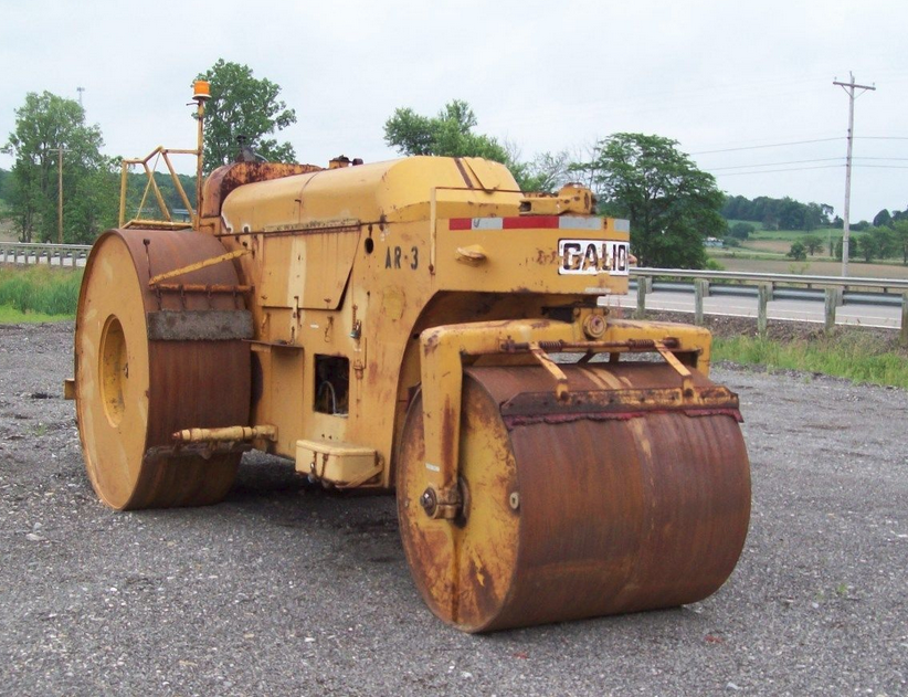

Here is a rebuilt one listed on 20-wheels. A John Deere.
My neighbor has an 8N and a small wheel-roller too.
Be sure to find a machine that does STONE. Not all can do stone.
In the 20-wheels site, do a search on WHEEL ROLLER and see if something is near you.
Galion 3 Wheel Asphalt/stone Roller, W/ Rebuilt J. D. Diesel, Hydrostatic Drive

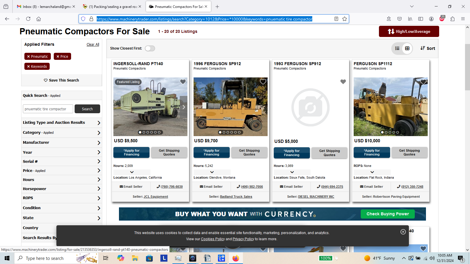

This type would work well,
