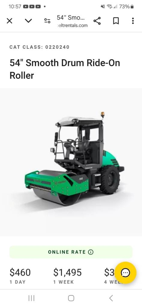

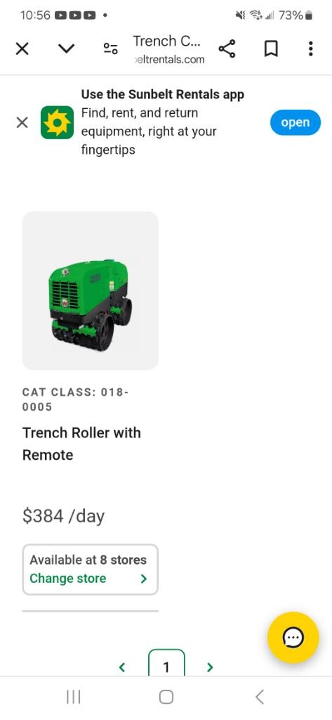

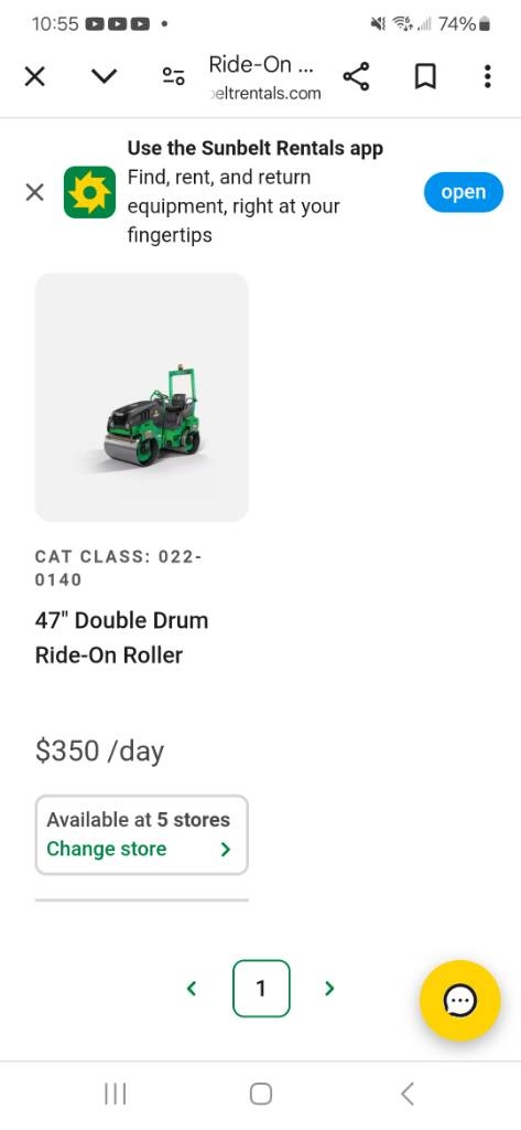

So, you can watch auctions, and look for vibratory rollers, as well as traffic rollers. Traffic rollers do an excellent job, but aren't in nearly as high demand, and often sell pretty dang cheap when a paving outfit is selling them off. I do agree that a double drum roller is not ideal.
The ones you've seen on diesel creek on trench rollers,
So, I know it's not the question you asked, but it addresses the over all issue; what is the source of the erosion? Do you have massive sheet flow going across/down the roadway? Have you considered having the rock primed and sanded, or chip sealed? Is there swales/ditches? If so, do you need to add ditch blocks to slow the water?

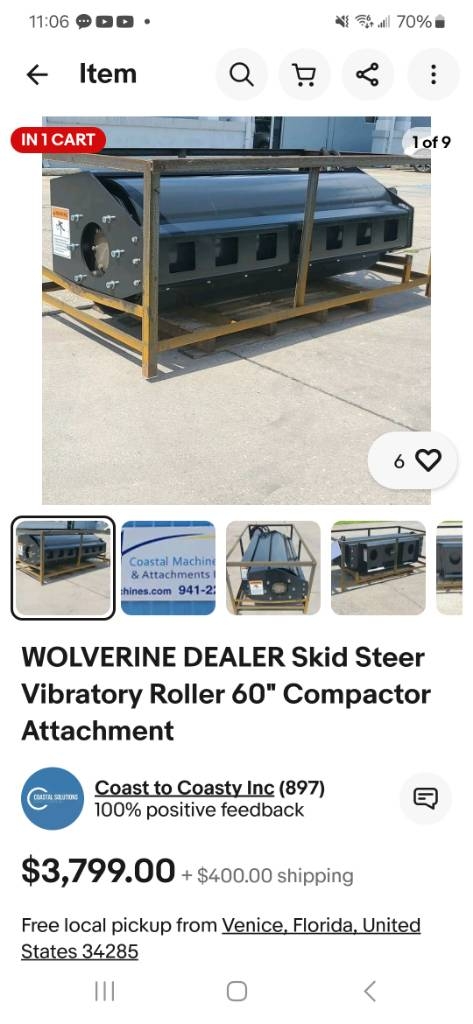

You mentioned skid steer rollers. I dont think i would mount this to a CUT SSQA, but if you do have a skid steer, imported vibratory ss rollers are available. I dont know how isolated the roller is from the SSQA...
   / Packing/sealing a gravel road after 'resurfacing' / land plane #14
They are not isolated, it will do the same damage as the jack hammers and other vibrating devices do to the attached equipment, rapid pin wear, accelerated hydraulic wear, and just general vibratory wear and chaffing.
