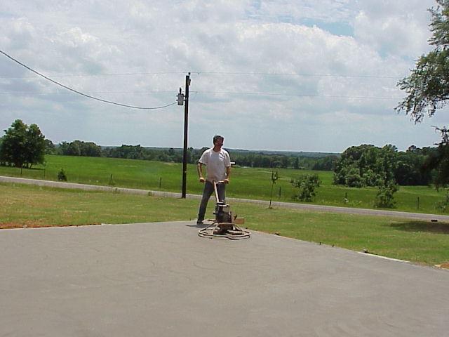

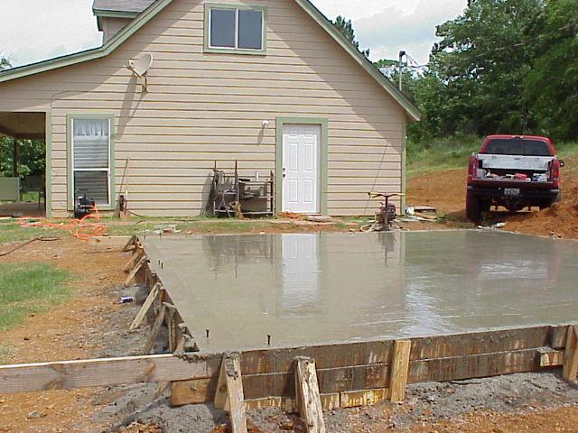

patrick_g said:
Tip #1, if you are not an experienced concrete finisher at least one of your help should be.
Read this as you will need to rent a trowl machine. If you broom it or just bull float it then what's the use, it'l be rough to walk on bare foot. Trowl machines are not that hard to run once you learn how to move them...like an old floor buffing machine. But the key is when to start trowling. To soon and you make a mess, to late the stuff is to hard. I went over my garage 3 times and it is nice and smooth. But I still like walking on a deck better. :D
Rob
   / Pad site for travel trailer on rural property? #20
Rob, Excellent suggestion! I have lots of hours in my log book running floor buffers (USAF where everything has to be shined no matter what your actual job was, instrument flying instructor on computerized flight sim) and found that the skills developed, like riding a bike are not easily forgotten and do transfer to similar devices. My concrete guy let me try my hand with his big unit. Beats trying to do in on your knees, especially when there is very much to do.
