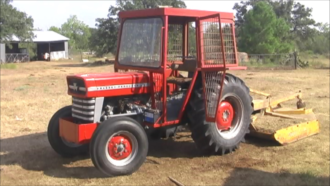

Here's a few pics of various year 135's. Sorry I can't help with colors or hardware. I do remember seeing spray paint plus quarts and gallons at the local tractor store that actually say Massey Ferguson Red or Gray. I'm sure you can also get it at a MF dealer. I think if the can says MF paint the color will be pretty close to original.
