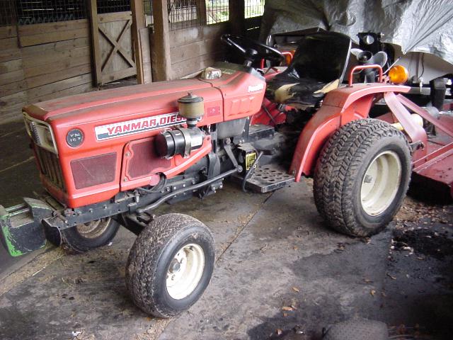

   / Paint #15
Gerg:
Thanks for the info, here's some pic's of my future painting job
The grass is slowing down and I don't use the tractor much over the winter (if that is what you call it here in fla.) so I plan on painting this thing over the winter. Some question for you guy's out there that have painted tractors before.
(1) I'm not bad with a rattle can or my Wanger 305E spray gun and I'm going to call Wanger today see if the little spray gun will will be able to do this kind of painting I've only used it for staining decks and fencing any comments ???
(2) I'll take off the sheet metal to paint but what if I want to paint the motor and body what kind of prep. is involved in that. sheet metal is one thing but all the nooks and cranys of a frame and motor maybe just a little over my head. Does the frame and motor need to be primed before painting?
(3) If I do paint the frame and motor, do I just use a gloss black engine enamial <sp?>
(4) Anyone have a clue on a close match for the off white for the grill and rims
my other thought is just towing to to the local tractor shop and cough up my hard earned cash and say "here you paint the thing" /w3tcompact/icons/smile.gif
thanks
Whiskey

Under the hood shot. It's lost the glossy shine

Whiskey, I wouldn't paint that tractor. At most , just wash, touch-up, and wax. Engine enamel would work well on the black, and fercryinoutloud put a seat on the poor thing. You will never get anywhere near the quality of the original paint with a rattle can, or anything else for that matter.

Whiskey,
I think I have to agree with others. Don't paint the sheet metal! I would bet that a good wash and wax would bring that paint up to a beautiful shine. Unless there is some rust that is not visible in your photo, I wouldn't paint it. I painted my hood and other parts around the hood because there were some really bad rust spots 4-5" in diameter and larger.
The engine and frame is another story, though even there, unless there is rust - I wouldn't do it. It looks like the paint coverage on the engine is pretty good. Again, I would just try to give it a good wash - water and mild soap under the hood won't hurt a thing. If you have some really grungy places - use some of that engine cleaner gunk. Even some enamel thinner/reducer can be used for the really hard to clean areas. It shouldn't hurt the paint since it is a laquer based paint. The thinner will get the oil/grease off, but leaves the dirt behind, so you'll have to get the soap and water out to get the dirt - maybe even with a toothbrush.

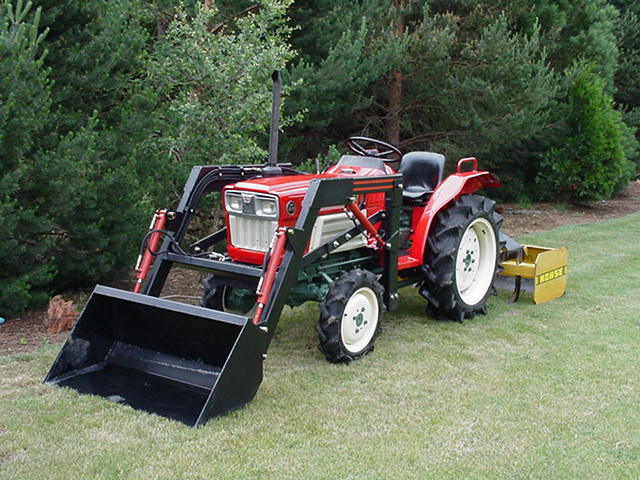

I may be off the conventional wisdom here a bit because I have painted all of my Yanmars that I have owned. I paint them because I wanted to stop any rust that was occurring and to generally keep it in good-looking condition. I like many people try to just keep my stuff clean and well kept.
Here is a photo of a little 1610D that I painted with a rattle can. I think good results can be had with spray cans. If the user is careful with the prep work and apply the paint according to the directions, good results can be had.
I painted the entire tractor, frame, body and loader. it took me a couple of weekend nights because I sanded all of the rust and primer all bare metals.
Perhaps I went overboard a bit on "just" a tractor, but again, I care about maintaining my equipment.
Thanks,
Cameron
