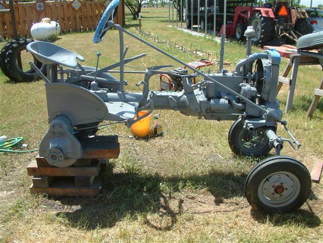

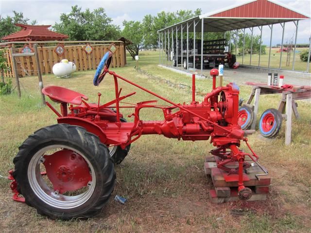

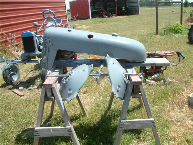

Here's the 1948 Cub I'm restoring now.
Used Valspar paint and primer from Tractor Supply. The silver paint on the rear rims is Rustoleum. Used an HVLP spray gun from Harbor Freight.

The tire on that Cub is okay- The Cub tractor has 4 different ways the wheel rims and centers can be assembled to allow for variable widths.
   / Painting and working on old tractor #10
-tire backwards?
Good eyes :thumbsup:
I'll reverse the tire on the rim when I get around to it.
The other rear wheel is on correctly.
