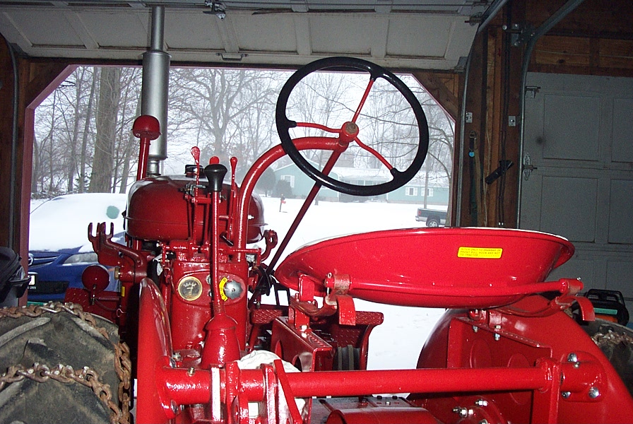

Good Evenin Code54,
On the tank issue, I just poured a box of locknuts and a couple quarts of kerosene into the fuel tank and then let it spin on an old paint mixer. You could also strap it to one of your tractor tire rims and let it spin slowly for a couple of hours. The inside of the tank came out like brand new. I then washed it and flushed it with water and let it dry. I have never had rust return...
It could be a cheap way out for you... ;)
