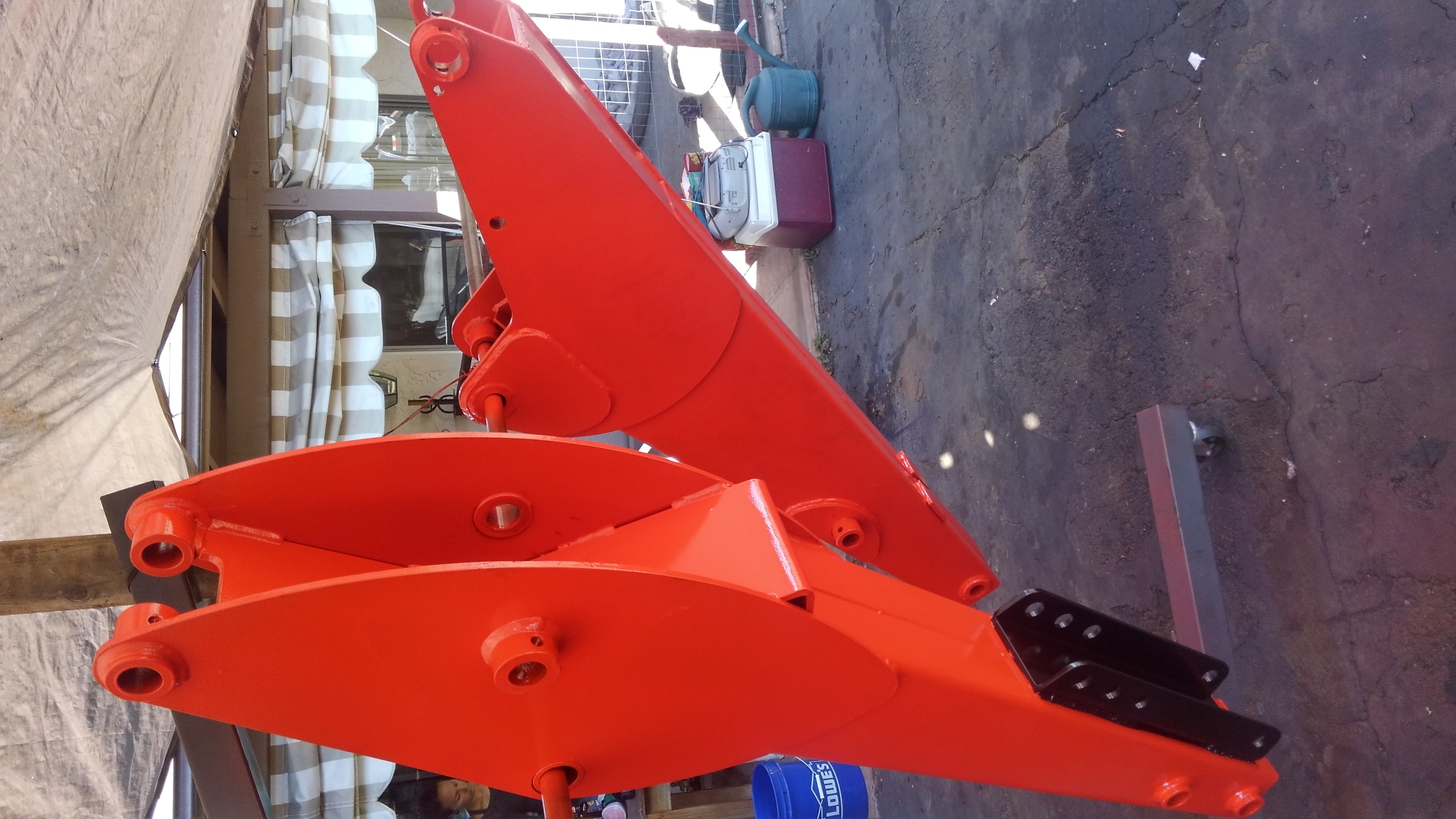

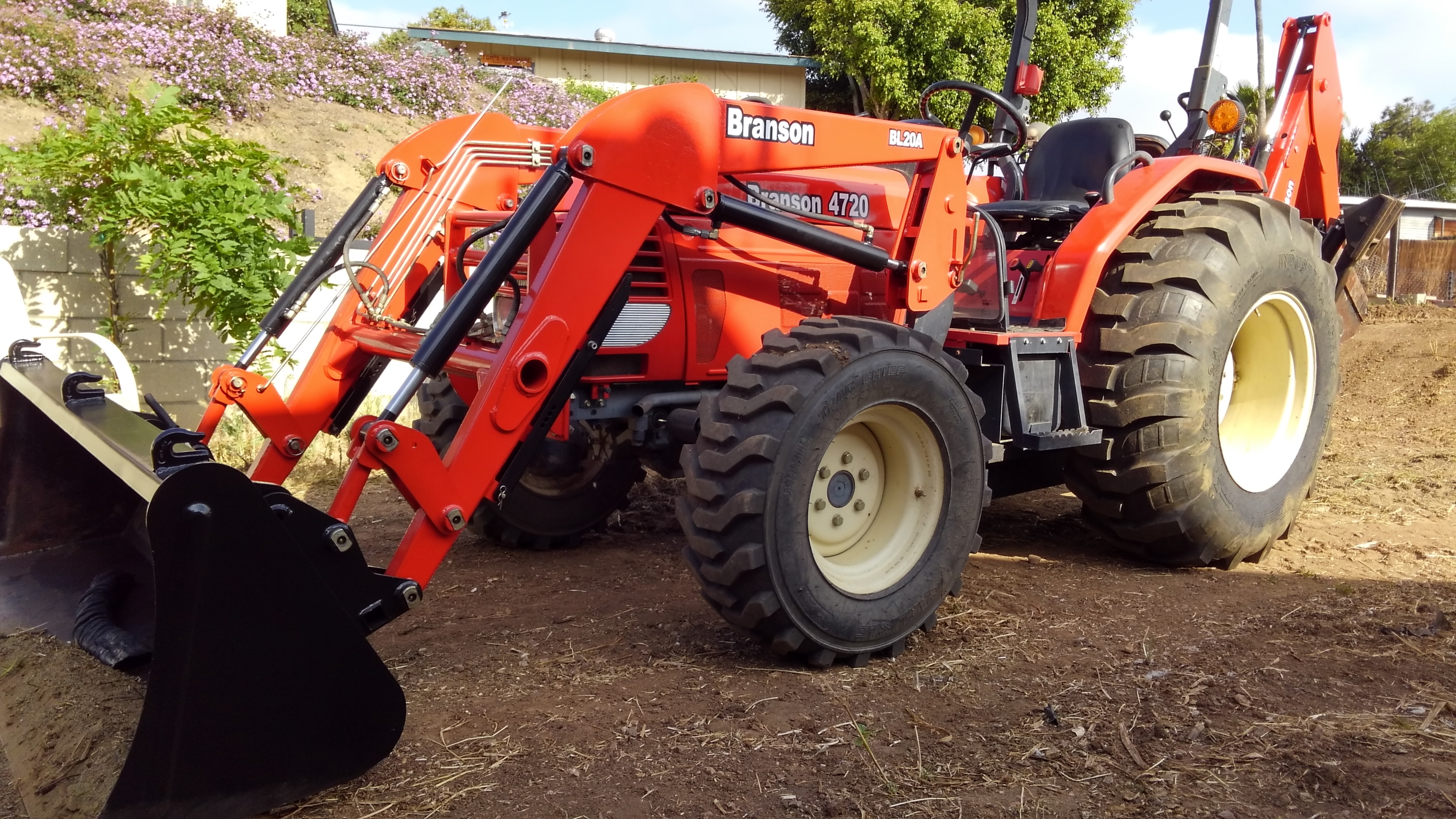

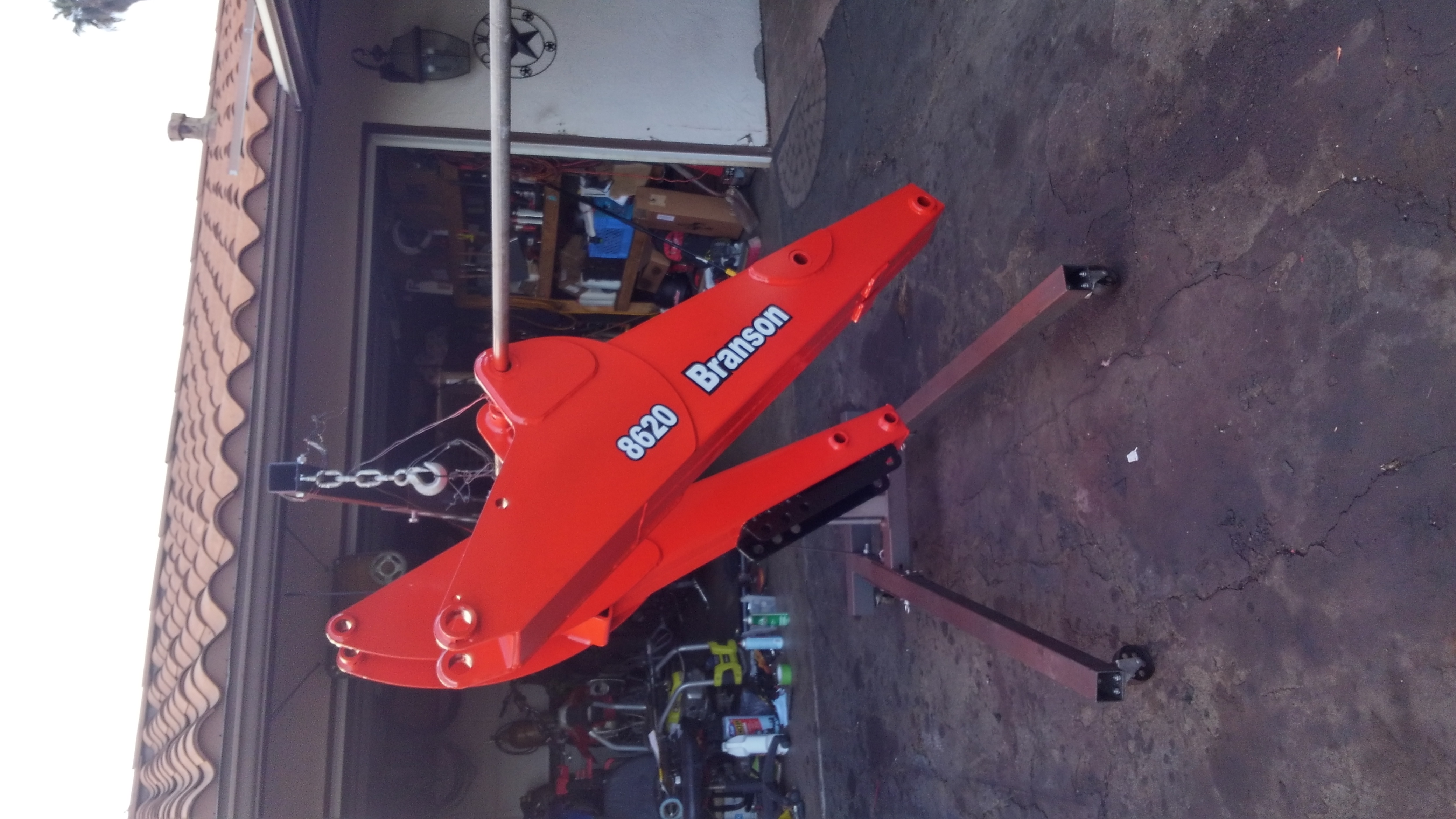

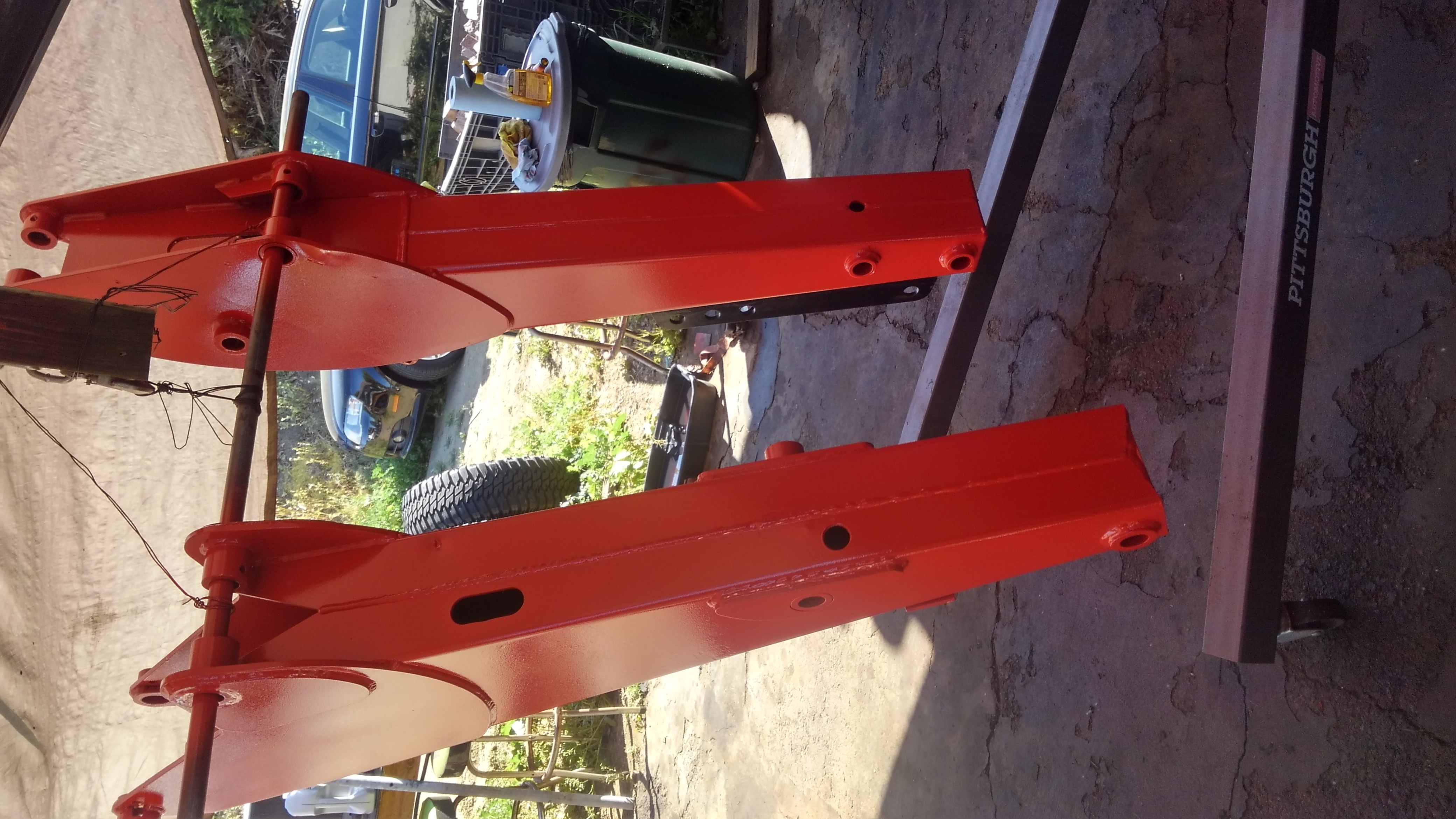

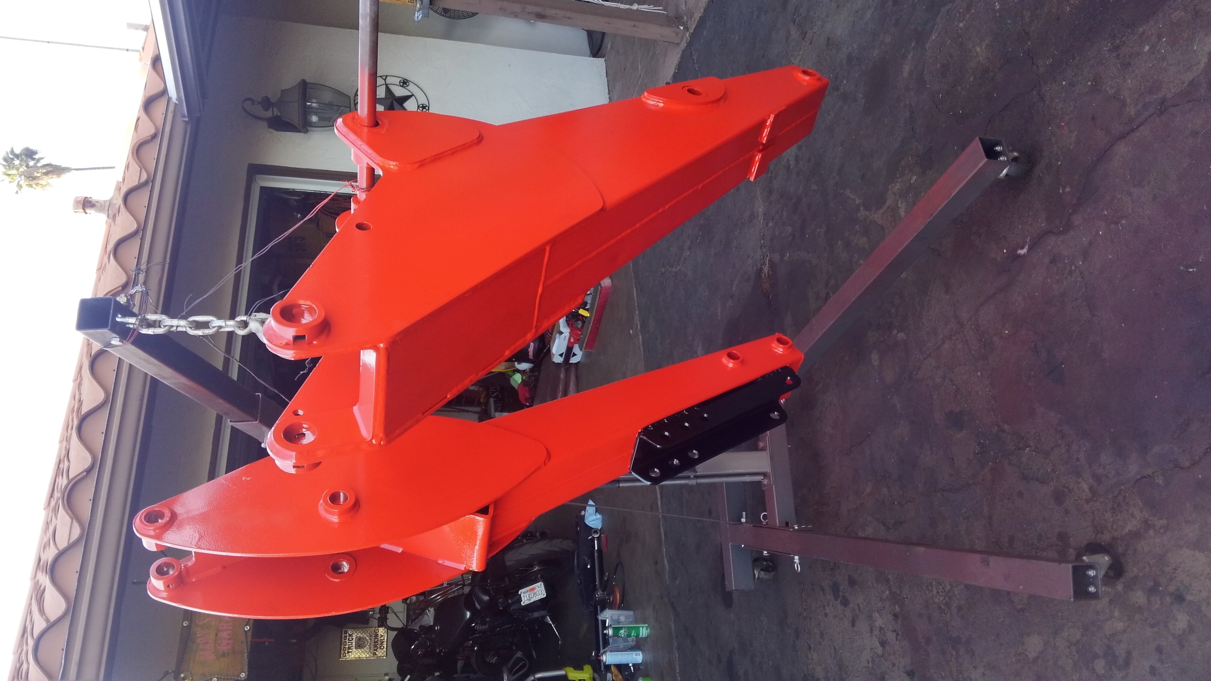

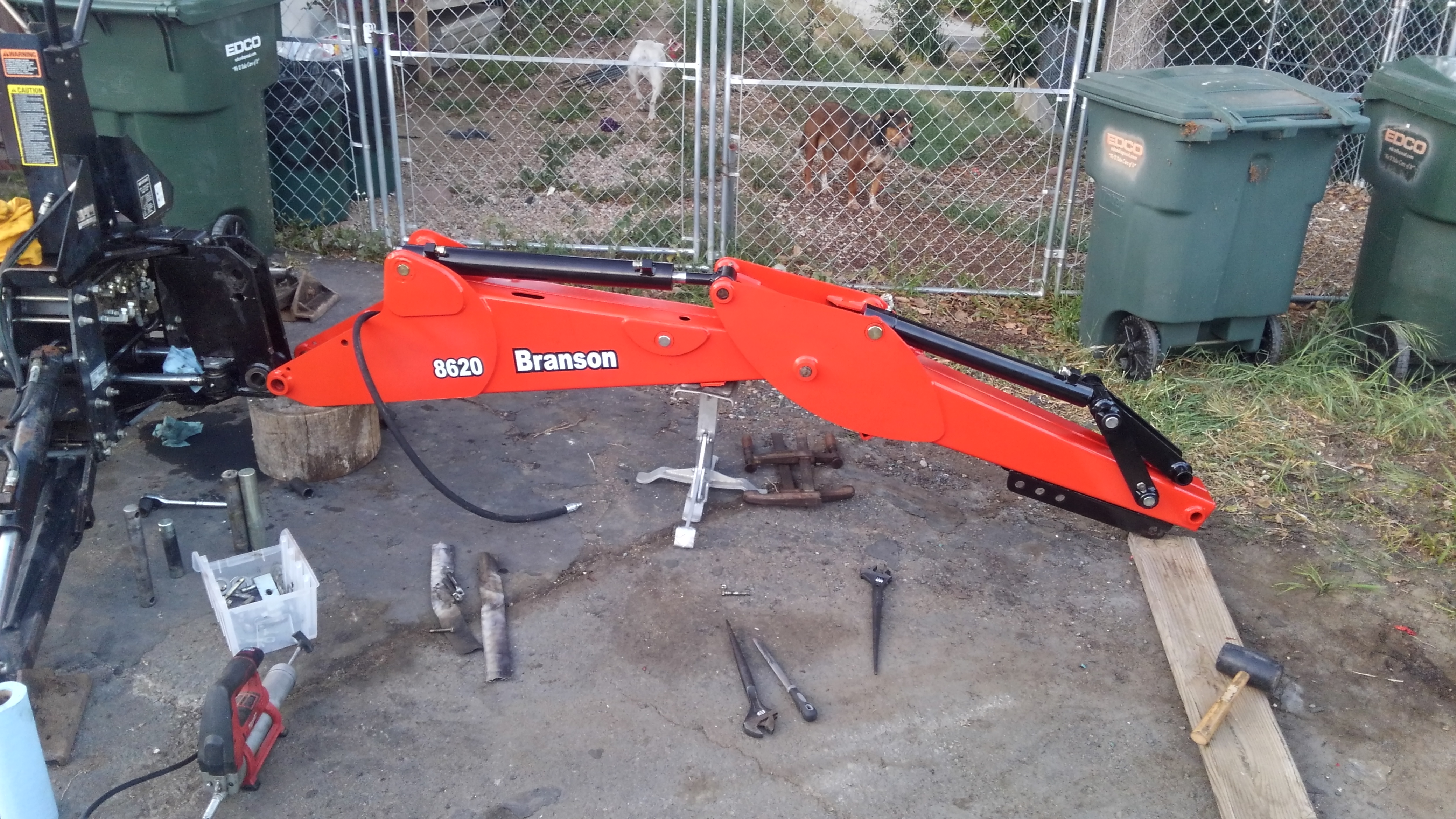

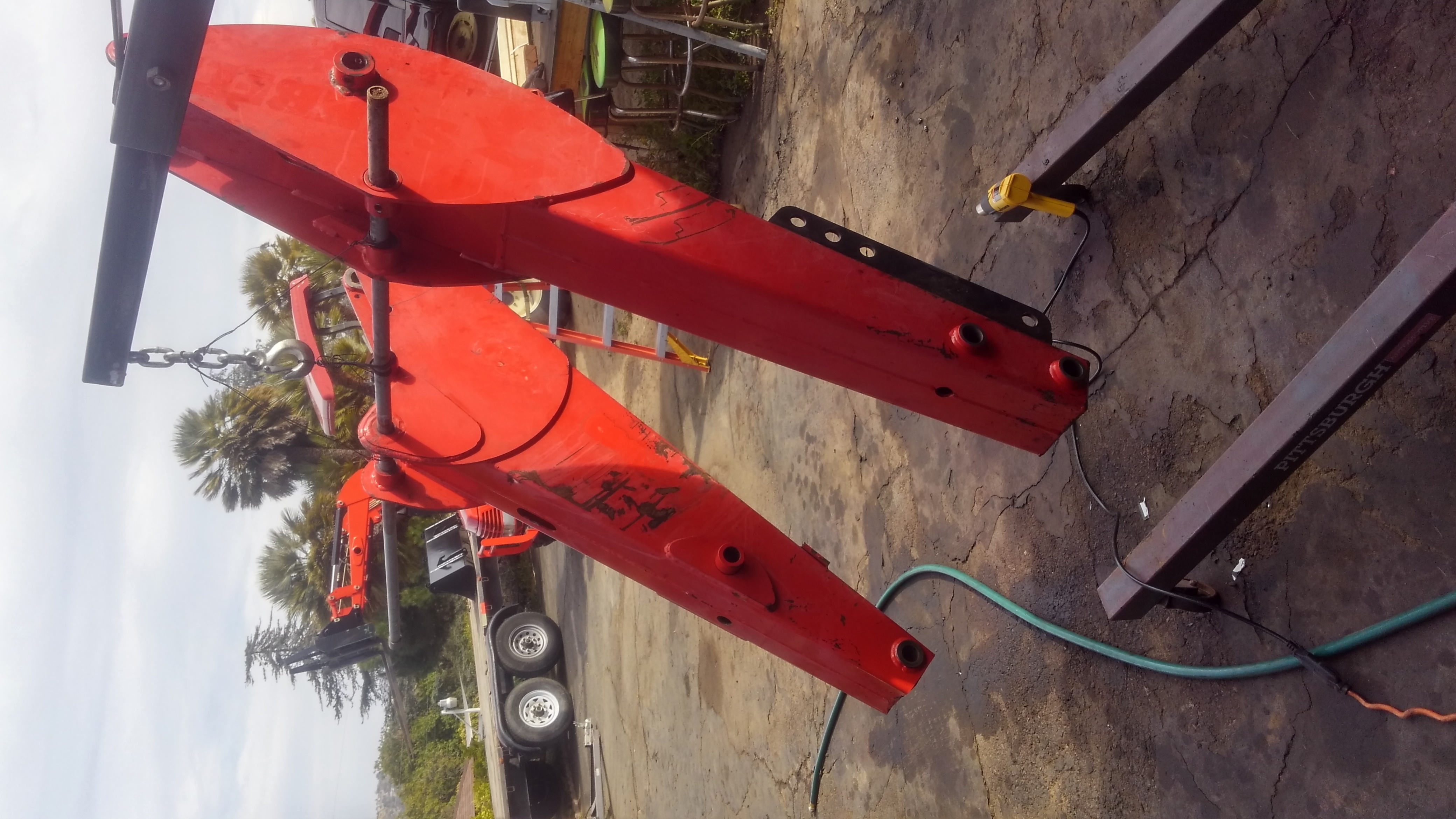

Sorry fellas, I was in a hurry to head out of town when I finished this all up and I didn't even post pictures of the backhoe and finished product.
So here it is all done:
KIMG0641.JPGKIMG0643.JPGKIMG0644.JPGKIMG0645.JPGKIMG0646.JPGKIMG0649.JPGKIMG0650.JPGKIMG0653.JPG

What did you use to all clean the grease off with?
   / Painting my 4720 (have paint code)
#14
Fabulous job!
Used a lot of foamy degreaser in conjunction with my pressure washer using hot water. Then rags and brake cleaner. Then after it got sanded down and wiped off right before paint, I had some final cleaner/degreaser the paint shop gave me to do the final wipe with. Then 3-4 coats of paint. Should hold up I am guessing.

Rustoleum "Cherry" rattle can paint from WW is an exact match for me. I added some wheel weights and it was a perfect match. Otherwise the dealer can get Branson OEM rattle can paint. I have what's left of a can of that and Charcoal which I haven't been able to find a match to suit me in Rustoleum or Krylon. The OEM paint ran me $16 a can...yes pricy.

did you happen to find the color code for the white rims also?

Thanks!... Unfortunately that appears to be the yellow wheel paint for the JD line they make in Europe. I may have to eyeball it.

No I was actually looking for the WHITE that Branson uses on the tire rims. It's kind of an off white. Almost a cream color I think.
