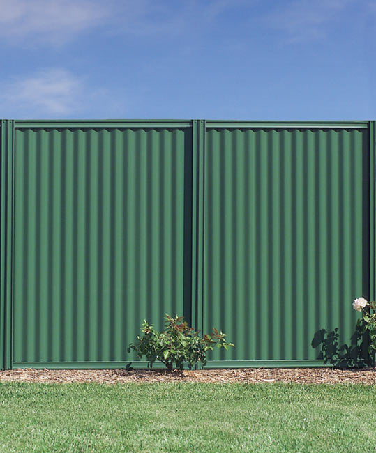

How do you put up sheet metal fences without railings?
They come in pre-framed panels that fit between posts that have a particular channel. Pretty expensive too. About $60 per yard for materials I think. I'm surprised you aren't already familiar with this stuff. Its everywhere over here. In many suburbs its the only stuff you are allowed to use for fencing. Fortunately I'm not building in the suburbs.

The pre-framed panels make it look better. They used to put up metal roofing as fencing around drive-in theaters years ago here before they all went out of business.

Actually, the metal fences that Alchemysa showed are pretty nice. I really like the ones with the heavy posts and rails. I guess they wouldn't be much more susceptible to wind damage than our wooden fences for the same post and support structure. I'm thinking also that the rust areas might be wire brushed and treated with one of those rust converter/stabilizers so that the progression is stopped. As far as I know, most painted corrugated steel is not galvanized. Our steel buildings are either painted steel or galvalume. Galvanized metal is always designed to be an unpainted surface, so anything you do to make it hold paint is an afterthought. . . I think.

Like Jim said, around here when we paint over galvanized metal we "etch" it first with vinegar. Wipe it down, let it dry and paint. I've always used latex and have had pretty good luck. I've seen some done and it only lasted a few years as well. About 12 yrs ago I put metal on the outside of a well house i built and painted it with latex. About 30% of it was galvanized and the rest was already finished to a color. So far all it has done is faded. Good luck.
