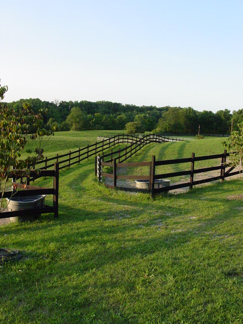

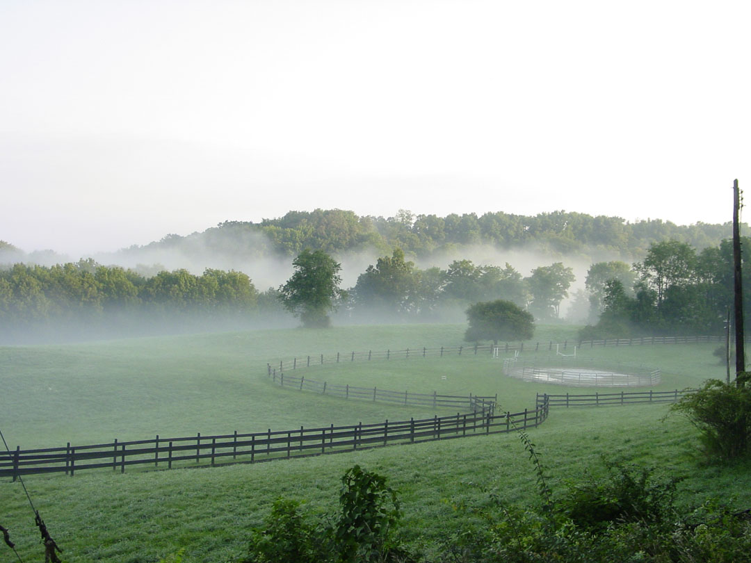

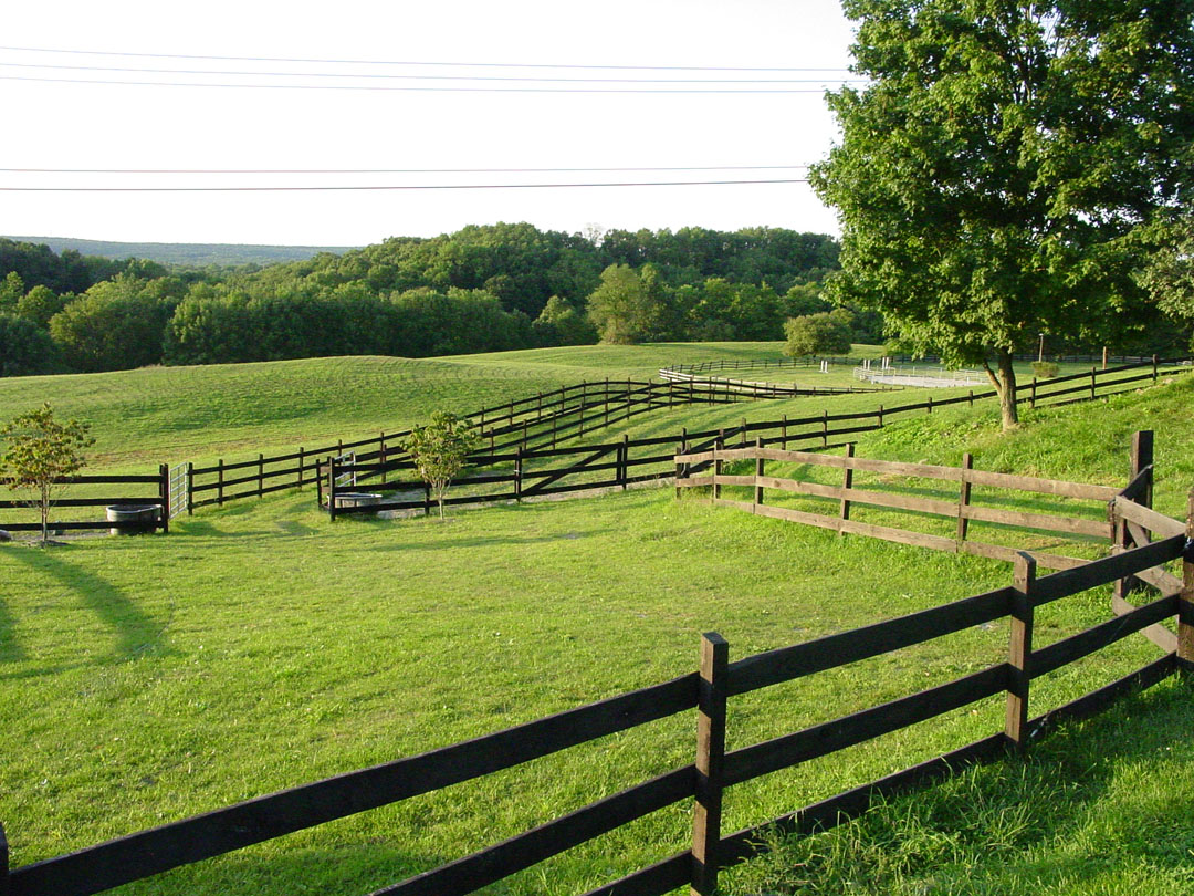

I have been intalling PT wood fencing on my place for the past 7 years. Instead of white we went with black. Personal taste. We have been using foundation sealer, which is a tar like substance that goes on thick but dries. I have also cut it down with gasoline to thin it out. This acts more like a stain but fades in the sun faster. For deep black, don't thin it. I guess it's similar to using kreosote as they did in the old days...which is banned now. The real difference is in the price. 5 gallons of paint or stain is about $75. 5 gallons of foundation sealer was $12 up to a few months ago. It has now doubled to $24...I guess because of the price of oil these days (it's an oil based product). Only draw back is it comes in one color...black. I don't wait for any drying time of the wood. I have even been caught in rain while painting. Hope this helps.

A few pics to give you an idea...

Actually I got the idea from SoundGuy. I am fencing approx 3-4 acres with 3 rails plus cap rail. We are using acyrlic based driveway sealer. 5 Gallons for $17-$20. I brush or roll it on. We have used different manufacturers - some are better than others - blackknight or bakers. I went with acrylic after checking whmis sheets for the coaltar - too toxic for me.
Under the cap rail I paint the top of posts with roofing tar and add a layer of tar paper on top of post prior to laying cap rail. We also painted all the posts with coppertwo preservative - relatively safe stuff. We allowed the copper treated posts to dry prior to painting.
