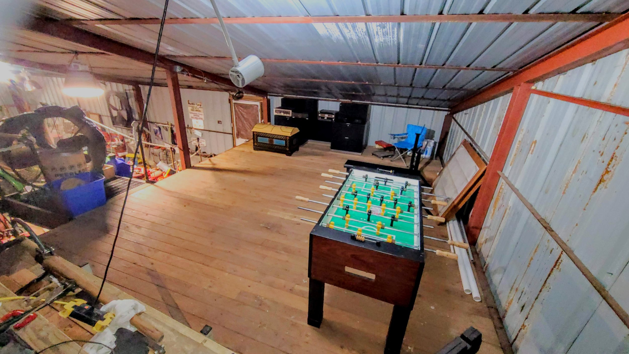

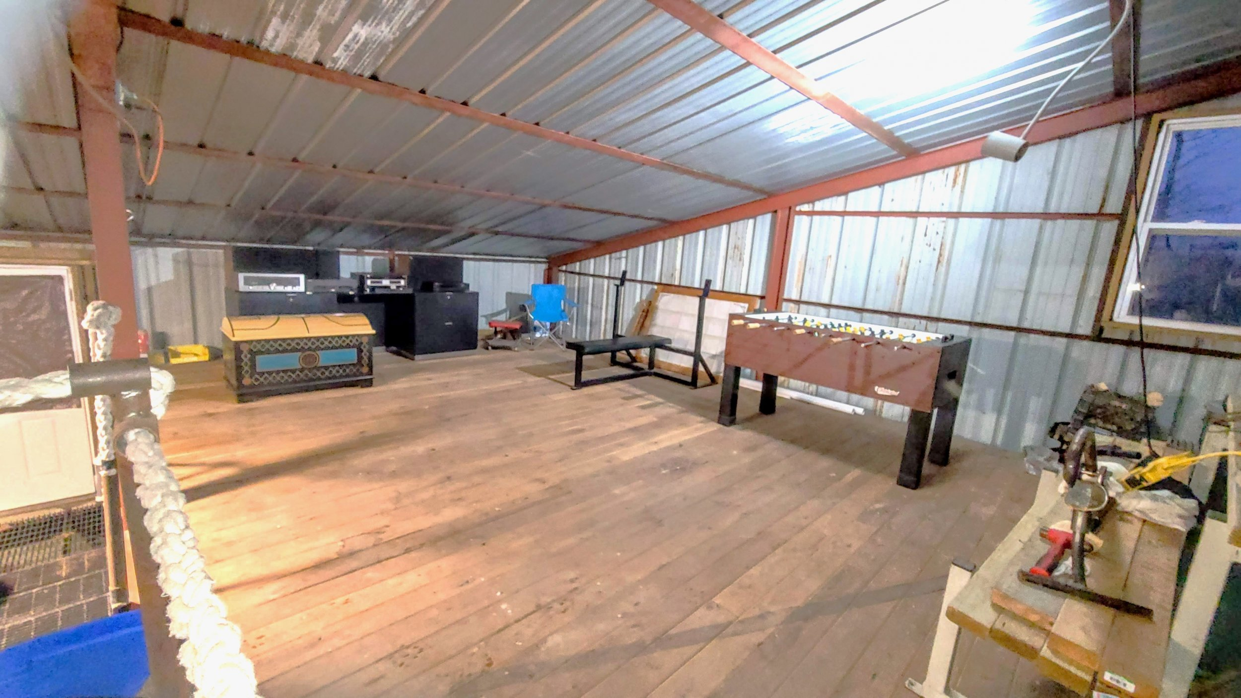

Also, here are a couple pics of the 16X27 foot area of the mezzanine,, the entire building is 57X45 and up to 22 feet high.
What Would YOU Do??

There may be just enough gloss on that sheet metal that you'd really need to carefully determine what needs to be done to make another coat of paint stick to it without peeling. I tend to agree with the idea of leaving well enough alone. It looks so much better than so many other shops already.

No opinion on what to do, as that is all personal preference, but if you elect to paint, then an airless sprayer is the way to go. Trying to roll with all the corrugations in the steel will be a nightmare. You can get long sprayer wand extensions so you can reach high up from the ground or at least from more simple scaffold or platform.
