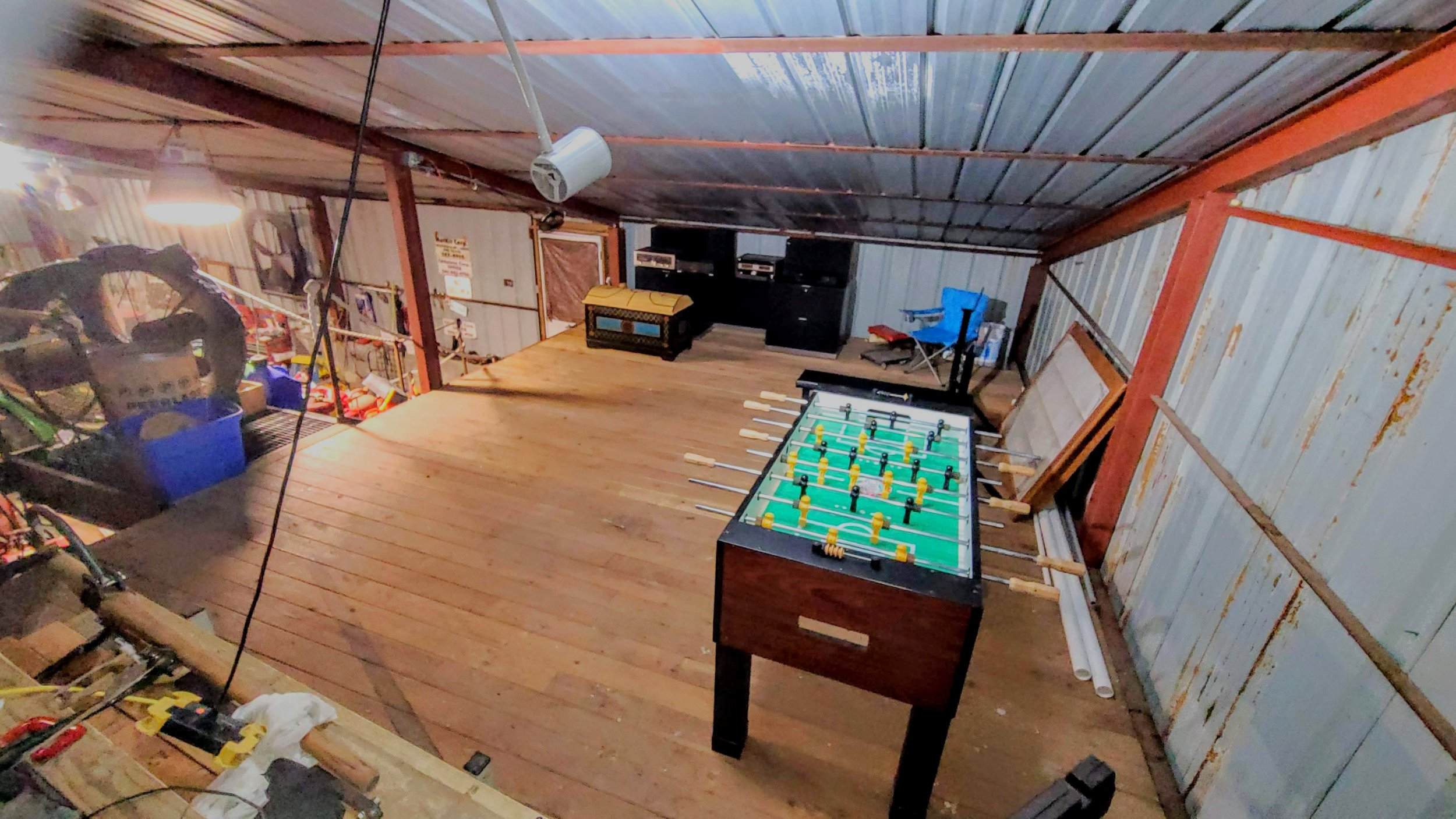

I built my shop back in 1999.
I got a really great deal on all the steel, including the siding material.
The reason for the great price was that the siding had sat a while, and some rust had formed on the inside surface of the steel siding.
I put the siding (and roofing,, all similar material) on the building, but, I never got around to painting the inside.
Now, over 20 years later, the inside still looks like the day I put the siding up,, some rust..
The main reason that I never painted is that
1) painting buildings is not my favorite job
2) in the summer, it is usually too hot to do that type project.
3) in the winter, it is usually too cold to paint.
4) it is just a shop,, it does not "need" to look too pretty.
Well, I have been cleaning up the shop lately, and Hmmmm,, some paint would look nice on the walls.
I was thinking that rolling on Rust-Oleum, or Tractor Supply paint might be best,,
So, I have some questions
A) is rolling on the paint the best way to apply the paint?
B) is 45 to 65 degrees F too cold to apply paint?
C) should I use Gloss, Satin, or Flat paint? And what is the advantage of each?
D) maybe I should "leave well enough alone", and not paint,, it may be worse than it is now??
E) should I use japan drier? It is supposed to make enamel dry faster, Hmmmmm.
F) what brand of paint should I use?
View attachment 773716View attachment 773717
Also, here are a couple pics of the 16X27 foot area of the mezzanine,, the entire building is 57X45 and up to 22 feet high.
What Would YOU Do??

OP your going to roll paint on 4,400sqft not including all the ribs?
