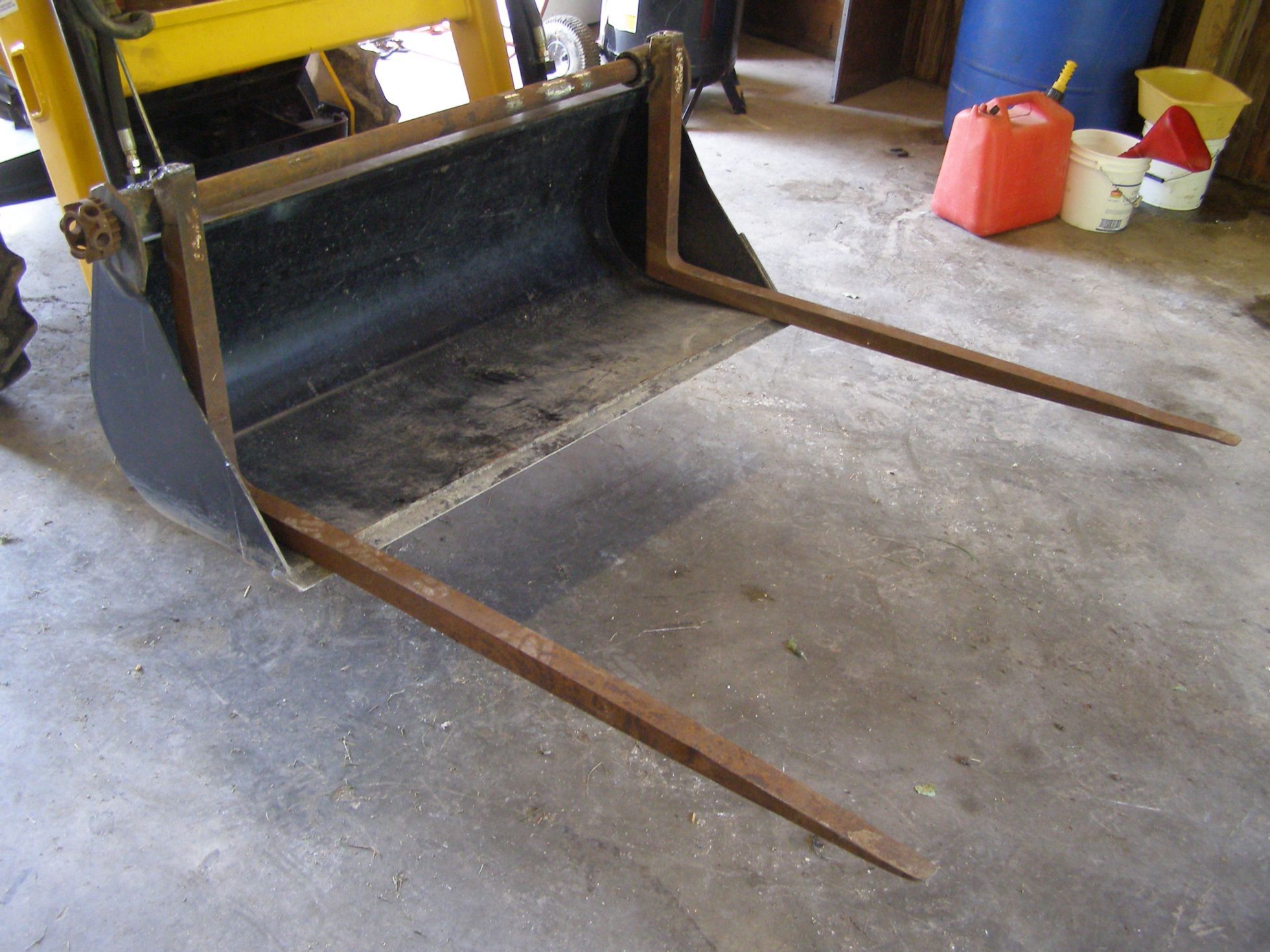

Greetings,
I've had great luck with the Molly Forks off of e-bay.
These slip onto the bottom lip and have a chain that goes around and over the bucket and secure with a boomer.
They work better than the clamp on type as they don't move side to side as much.
I have used them on round bails without problem and last Friday, unloaded a skid of paintballs from a truck which weighed 1850 pounds.
Granted, I would love a set that hooks on top but can't justify the dollar$$$$.
The type that use the skid-steer quick change are nice too but $ame problem.....too expen$ive.
I use mine on a L35 for everything you can imagine and it's nice that they don't fall off or swing when you dump the bucket.
Hope that helps!

Gotrocks, that's exactly what I'm after. However, I would like to be able to pin them on the bottom, or sides to keep them from swinging if I need to dump the bucket.
I'm going to see if I can find a set locally. Good excuse to buy a welder too :)

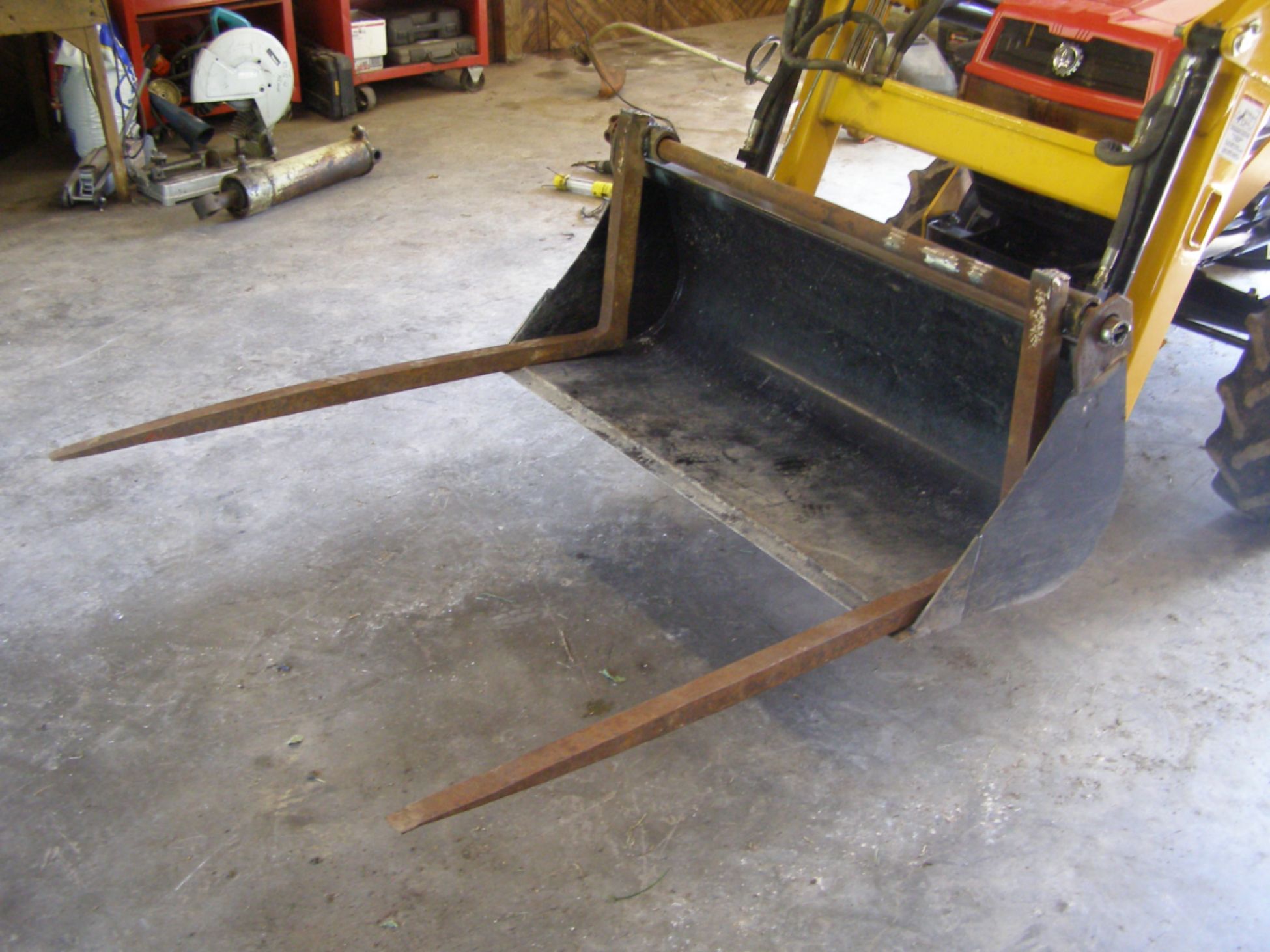

here are some pic of how i added forks to mine
