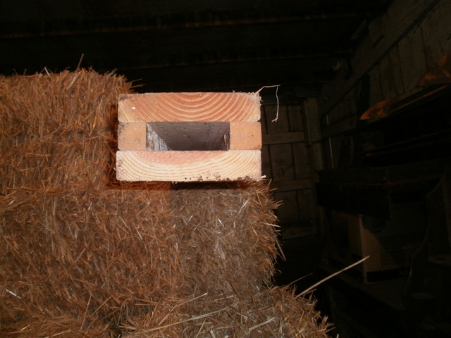

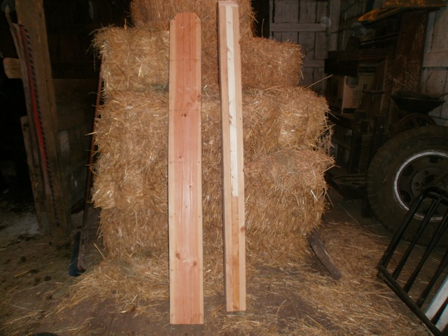

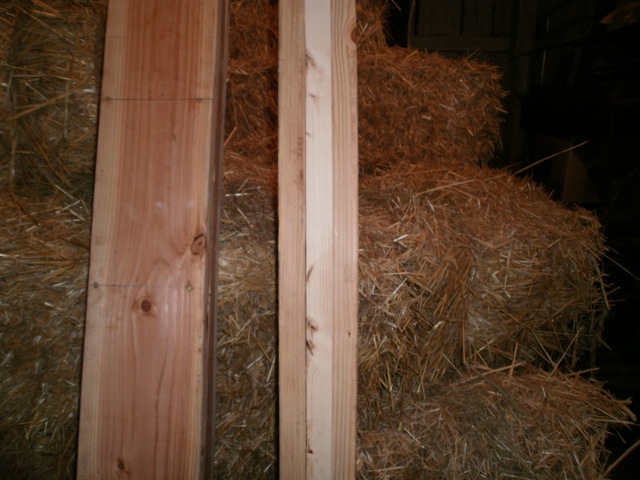

/ Pallet Fork Extensions? #16
I made a set of wooden extensions to make the entire fork 6'. Used a 2x6 on the bottom, then ripped a piece of 2x4 to act as a spacer for height beside the fork, and then cut 14 5 1/2" pieces of pallet to go across the fork, screwed into the spacer and bottom 2x6. The lumber was scrap, the pallets were free, and the screws I had in the garage from previous jobs.
They lifted my Skidoo Tundra lengthwise, but had to do my wife's snowmachine sideways, with one fork under the skid and the other under the belly pan.
Highly recommend!!!!
Will try and get photos up later.
