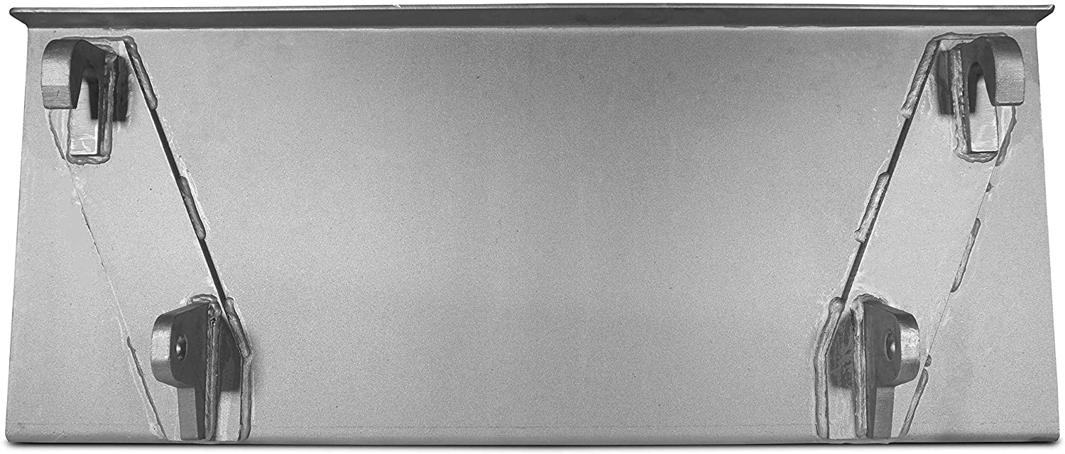

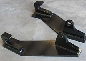

I also have these but I would need to figure out how to attach it to my euro/global system.
Remove the pin on brackets and buy a weld on plate:
Or brackets:
