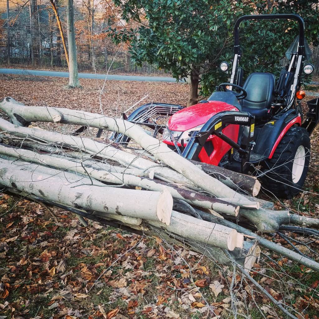

Yeah, I was very surprised. I'll post some pictures of the forks once I get them. No word on when they'll be finished, probably a few weeks. They're a busy shop. Out of curiosity, do you know if your tractor and the 424 with YL210 FEL have the same mount system/size?

Well, I got the new forks but there's a problem. They don't fit. They hang just fine from the top hooks, but the pin holes are slightly too far back. The fabricator said they'd fix. Kind of a pain.

Well I finally got the forks, the shop fixed the mount at no extra charge. It seems that their Yanmar mount was somewhat outdated, hence the poor initial fit. That's what they said anyway. I pulled my mount off the FEL and let them borrow it for the fix. Should have done that the first time! Anyhow, now they work great and I'm really happy with the quality. Especially for $500 instead of nearly twice that from my dealer!

532194[/ATTACH]
Wow, that is a pretty big fork frame for that size of tractor. 48", right?
The 42" Titan frame I ordered has been installed on a Bobcat CT335, and it fits well.
I just love the color scheme on those new Yanmars.

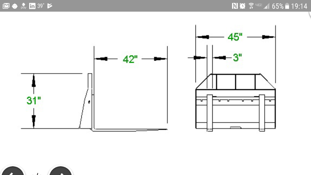

Actually these are 45 inches wide with 42" tines. I double checked the measurements with my tape and they match the drawing from the fabricator's website, attached below.
These are actually "compact tractor" forks. I agree about the colors, I think the 424 looks awesome .
