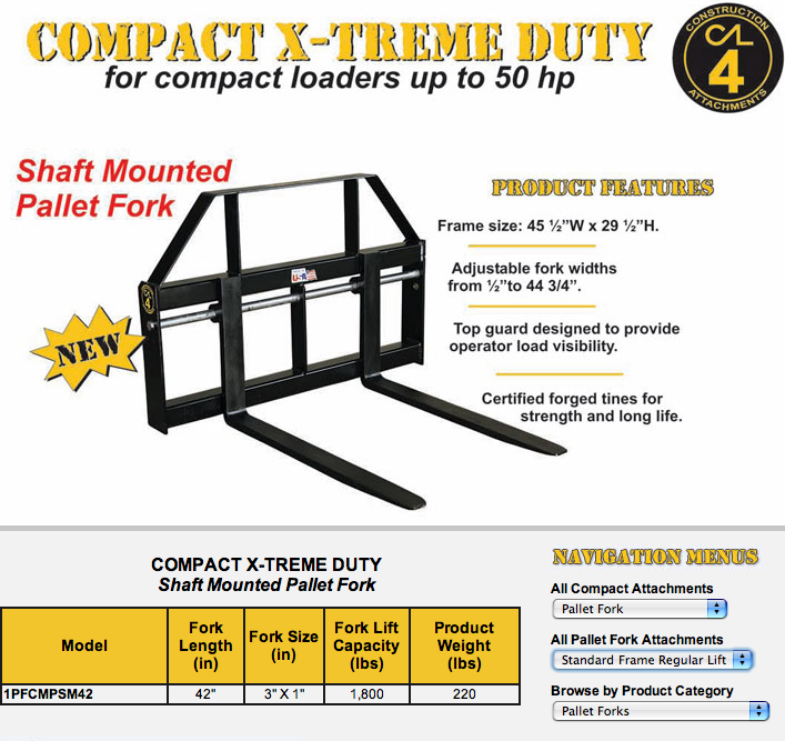

Hi,
Yes, as others have said the Kubota brand B3200 (LA504 loader) Q/A bracket will bolt right on the B2X20 series LA364). The bracket only weighs about 30lbs. and works great! UPS delivered it via my dealer. The bracket is very reasonable for how well it works.
The problem with using SS Q/A on smaller tractors is weight of brackets and that style of forks (and cost).
After looking at most brands of Q/A forks (calls and e-mails to various manufacturers) and waiting for back ordered Kubota forks for 6 months, I looked at many other brands and settled on these Cal manufacturing ones with which my dealer (JT's favorite which I agree) also had an account. I'm glad the Kubota brand forks were BO'd.
The Kubota forks weighed in at around 335 lbs (via Kubota tech support). and the CAL's are listed at 220lbs. These are US made and $300-$400 less than Kubota's set. What also is nice about these compared to some other after market fork sets is that even those these look like the floating type forks (that would swing forward when you tilt forks down)...they are not! They lock to the frame and are a breeze to adjust the forks and the frame is light enough I can shove it out of the way when they are detached.
I would recommend if you look at this brand that you do not be tempted into the larger size sets unless you have a much larger FEL because a set was initially delivered here by accident and though they hooked on tractor they were huge! About 450lbs!
I had clamp on forks with a previous tractor and going this route is night and day improvement in function, speed, uses, etc.
If you are seriously considering...I just can't recommend this system enough.

Tompet, thanks for the link...I hadn't considered anything aftermarket but these look like a winner. If the QA only weighs about 30# I might as well go ahead and get that setup.
