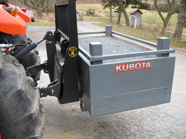

The carry all from TSC is quite handy. It will hold quite a bit more than the 1,000 pounds rated but I don't recommend doing it on a regular basis. I had 6 almost new railroad ties on mine. I was figuring whether or not it would be too much weight for tractor 3 pt hitch and never gave it a thought about the carry all limit. I figure it was around 1,400 pounds and it didn't bend the carry all or break anything.
Note to self: Calculate limits on everything before moving as the project is only as strong as the weakest link.

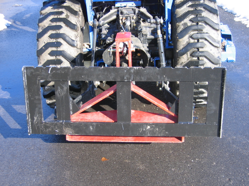

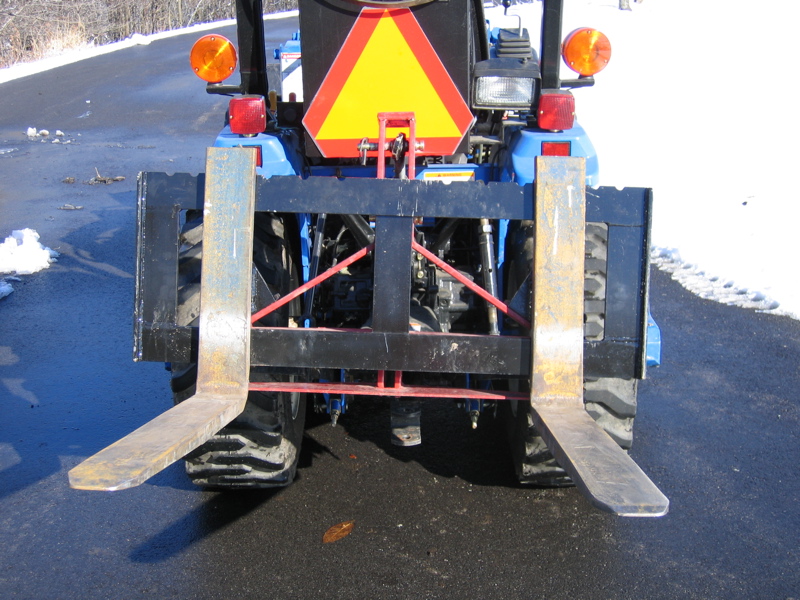

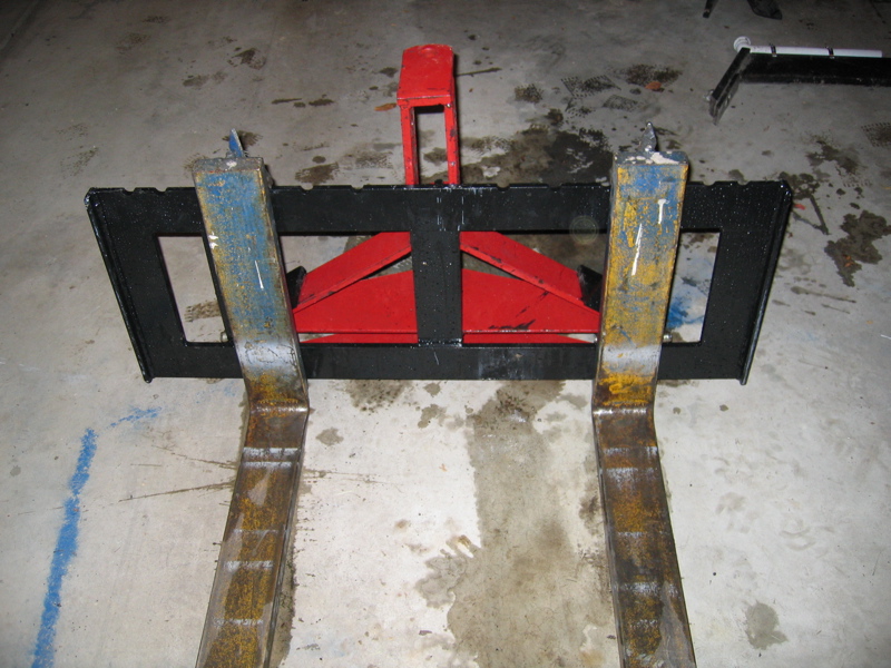

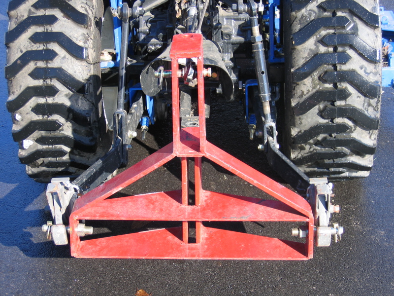

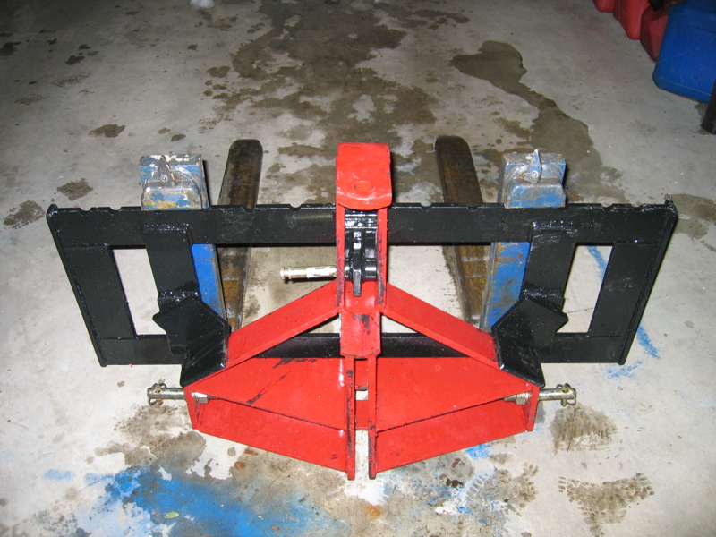

Here is mine, made from an old set of forks and capable of lifting far more than any of my tractors can lift. I designed this as a modular unit and has 4 major components so it comes apart easily and despite the total weight, each part is easily lifted and stored. It can also be stored nearly flat against the wall so it doesn't take much room when not in use.
I should point out that a hydraulic top link is STRONGLY recommended when using a 3pt pallet fork.
