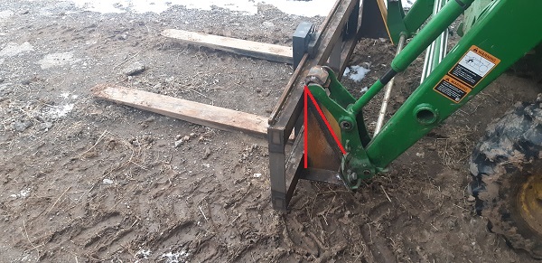

My B3030 came with clamp-on-the-bucket forks. They are very handy. Several hundred percent better than none at all.
But you lose a LOT of lifting capacity because the COG moves so far out front. I didn't have SSQA, so I bought an adapter and a set of SSQA forks and what a difference!

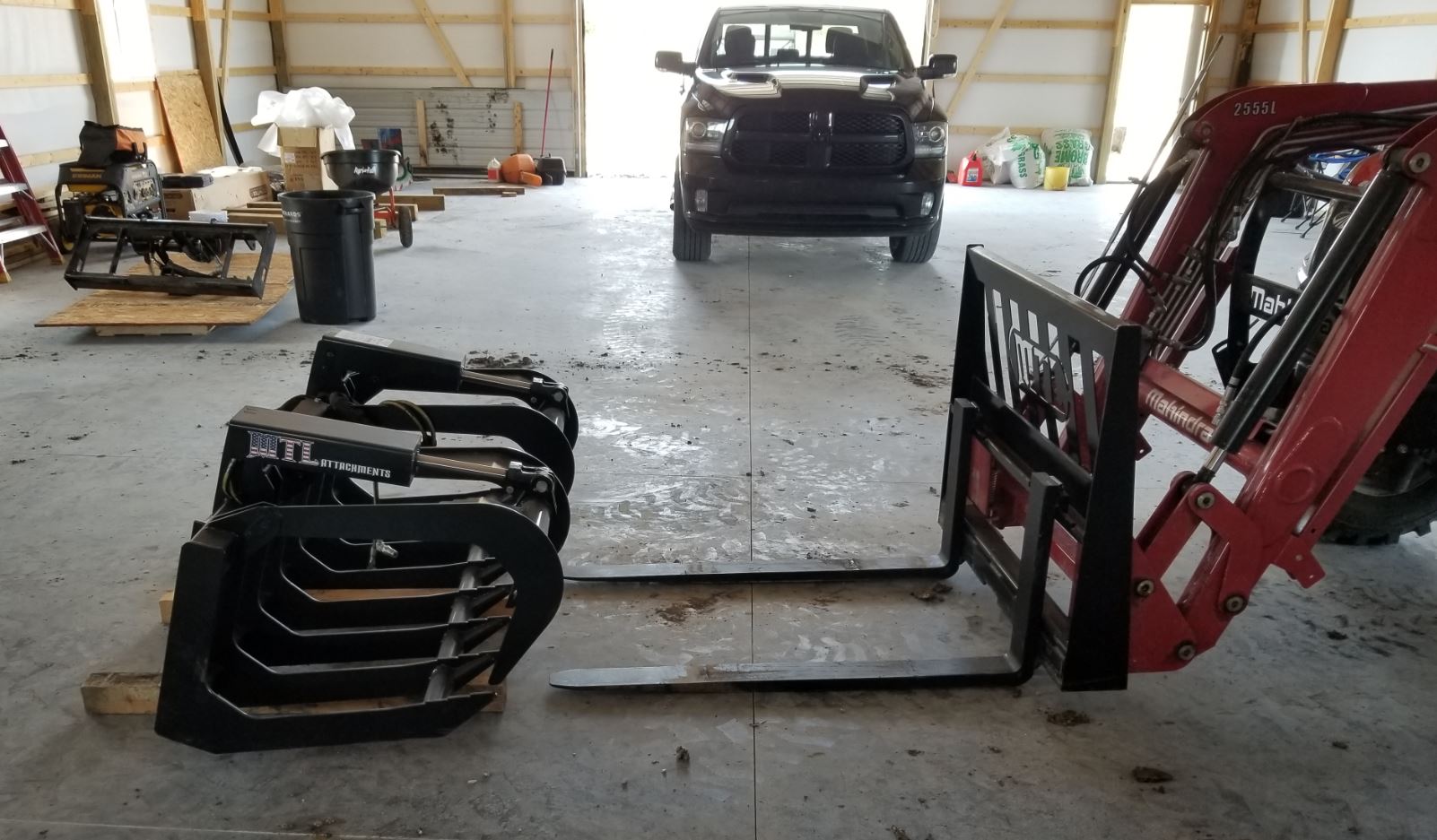

Just got these toys yesterday, and thought the price was right. Paint job sucks, but I expected that going in based on earlier reviews. I'll let it flake off for a while, and repaint at some point if I ever care enough.
I got the grapple and 48" pallet forks for $1500. May not be EA quality, but I bet they do everything I need from them. I was able to get both of these, plus 40 feet of pallet racking for considerably less than the EA grapple I originally considered.
Kind of been a big couple weeks. Got the grapple, the pallet forks, pallet racking all yesterday, and a couple weeks ago I ran into that HD25 post hole digger in the background for $1K, barely used. Already dug a handful of posts with it, works great until it hits the limestone rock bed under everything around here... :(

I bought the same setup (well I got the 60” grapple and orange) a few moths ago from MTL. I have been pleased for the money. I have had a Wild Kat grapple on my Mahindra for years with zero problems and it has been used hard. I just didn’t see paying twice as much for a grapple. I figure if something bends or breaks I will just have it welded back.

I don't know what the OP finally decided but I'm another who will advise against the bolt on units, especially for a smaller tractor. Aside from the fact they are a royal PITA they also will bring your load out farther from the pins. I have a set of el cheapo Titans which need a new backing plate; and am looking to upgrade to a better quality SSQA set.

Fact: you have 1000# capacity at the pins.
Assumption: you have 800# capacity at the front of the bucket, which is 21" from the pins.
Therefore, at a COG 24" in front of the bucket (standard pallet is 42" wide and 48" deep) you have a 500# capacity.
Or in another scenario, you have an SSQA set of pallet forks, the back of which are a generous 8" from the pins and a capacity of 950# at the back and 800# 24" out.
So the SSQA forks give you an additional 60% lifting capacity over the clamp-on forks.
