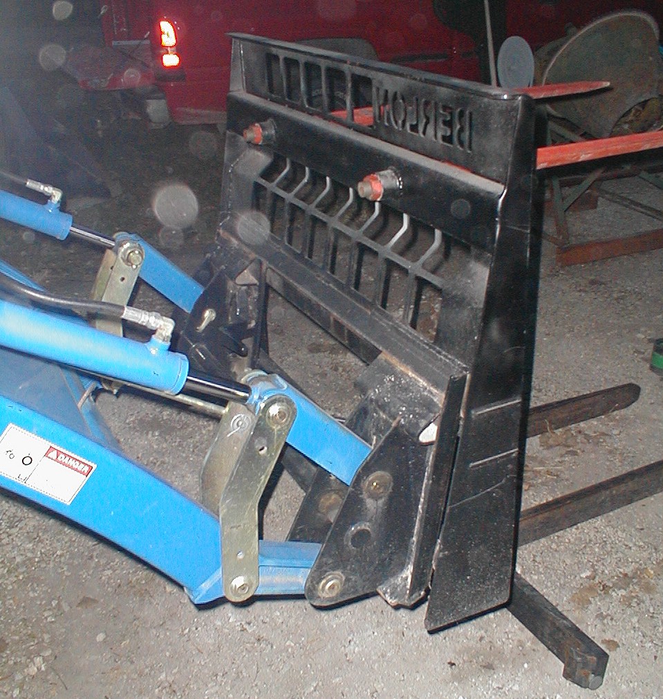

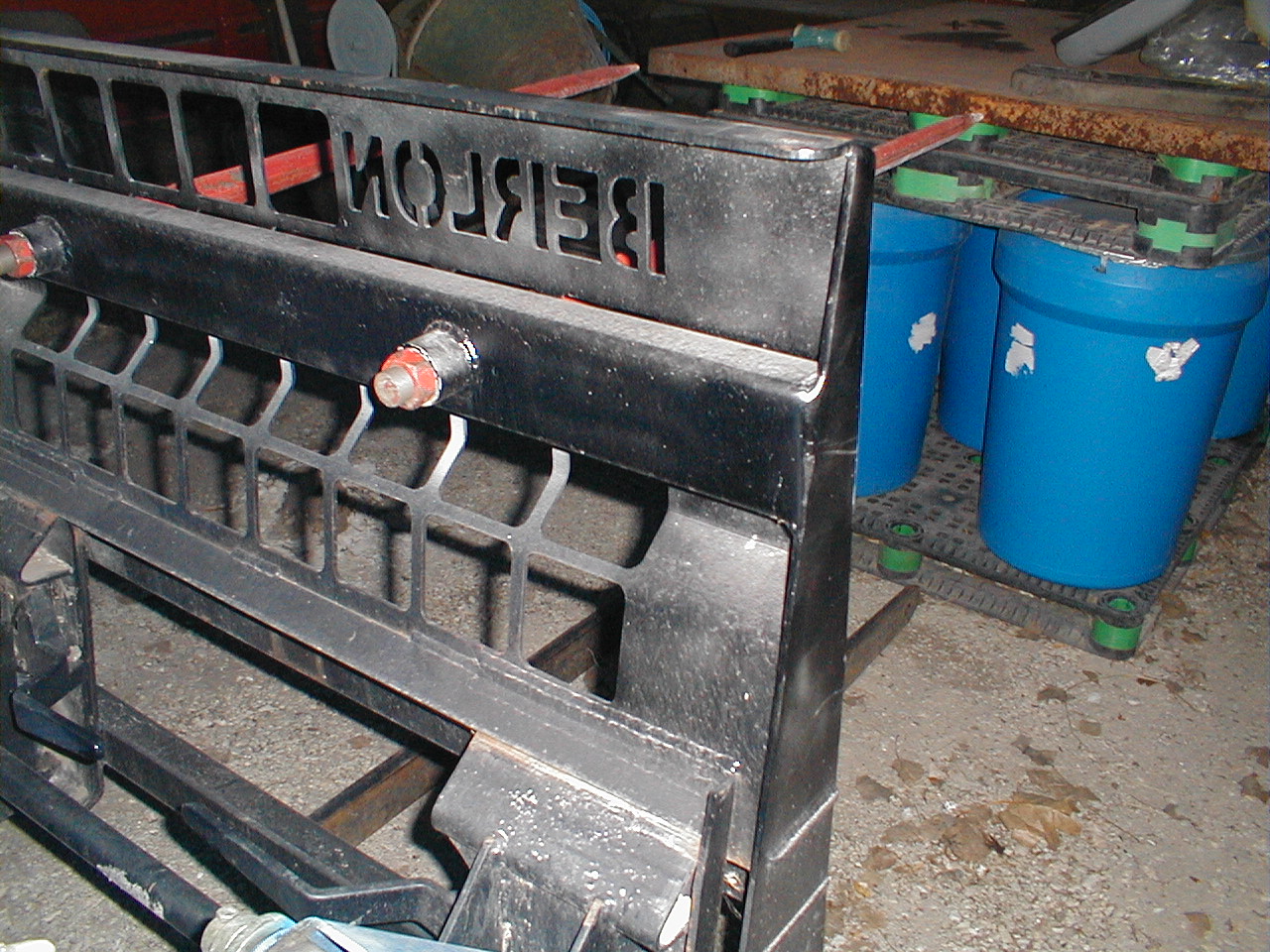

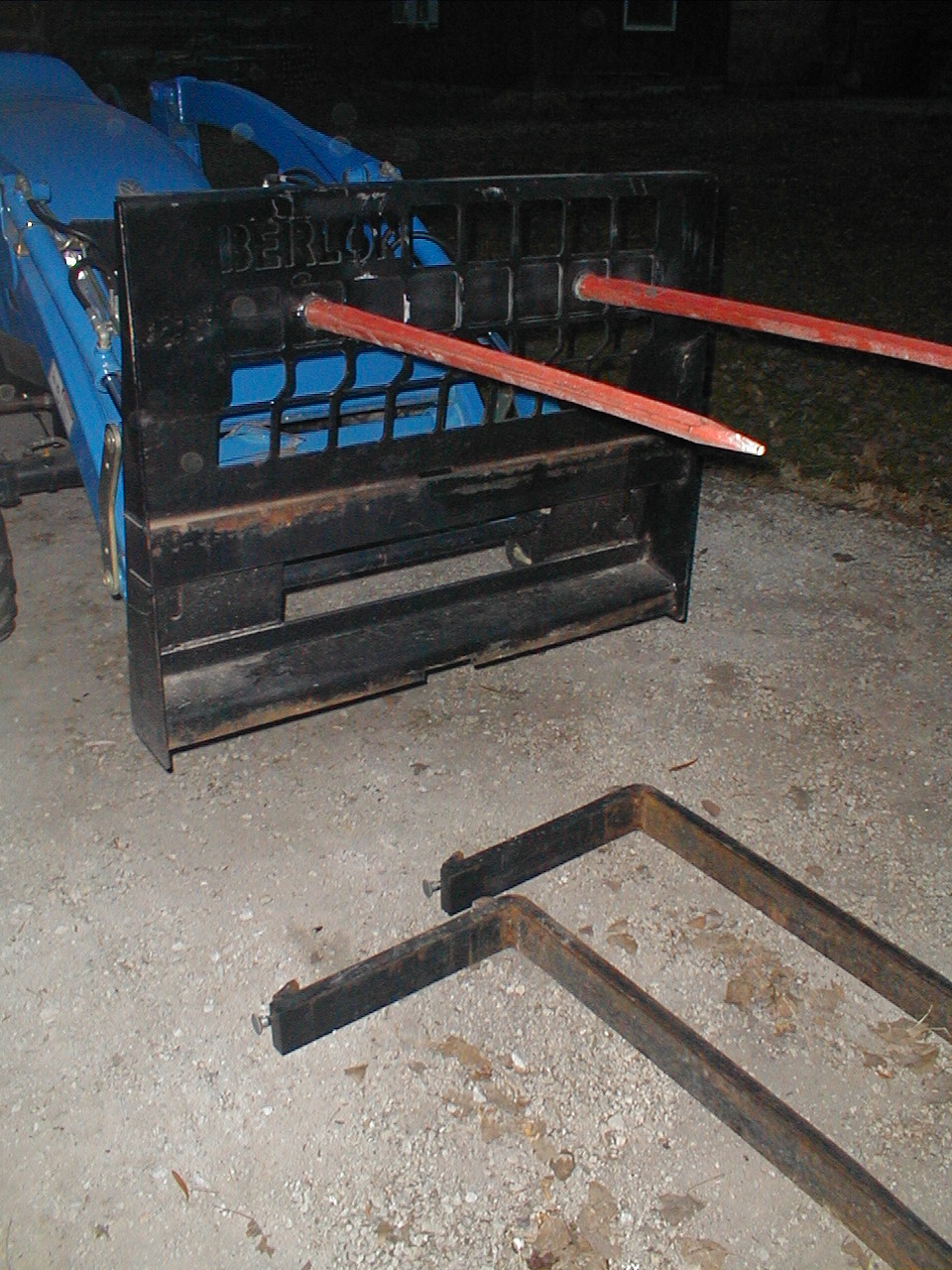

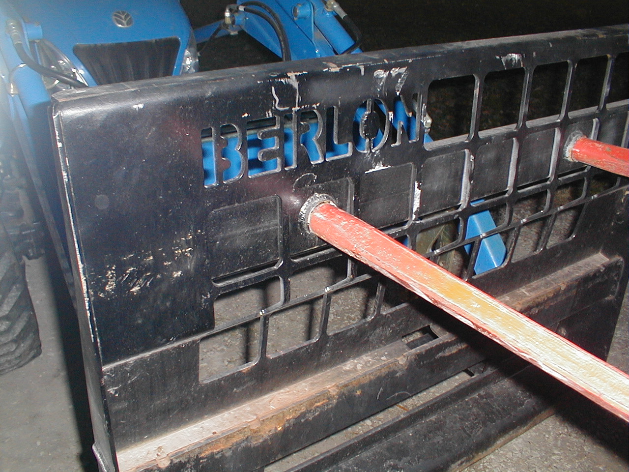

My wife and I got into the beef "business" earlier this year and figured round
bales would be the way to go. I have a New Holland TC 40DA with a 17LA
loader. After looking at the prices for bale spears I investigated making my
own. I have a full machine shop and welding capabilities. As I have more
projects than time I like to keep things simple.
I was looking at spears as they are medium to high carbon steel and heat
treated, I figured I would purchase the actual spears, my local implement
dealer had exactly what I wanted spears with weldable sockets.
Next I was going to build the back plate out of steel I had and was looking
at my pallet forks for ideas on how to build it so I could use the quick attach
feature on my FEL. When it dawned on my I could just modify the forks and
have it do double duty. I can pull the forks off and have the spears on in less than five minutes. The reverse is also fast.

The steel is 2 x 4 x 1/4" rectanglar tubing, cut and beveled to fit and then
I drilled and bored the holes for the sockets on my mill. The whole project to
less than an hour to build.

How do you take the spears off, undo the nuts on them and pound them out of their conical sockets?
Basically, I unscrew the nut to where it is even with then end of the spear to
protect the threads and use a dead blow hammer to knock them out. I do
not torque them too tight on installation as I only move one bale every other
week, all the bales are outside on the ground and no high lifting is required.
If I needed to lift high for some reason I would torque them down tighter.
