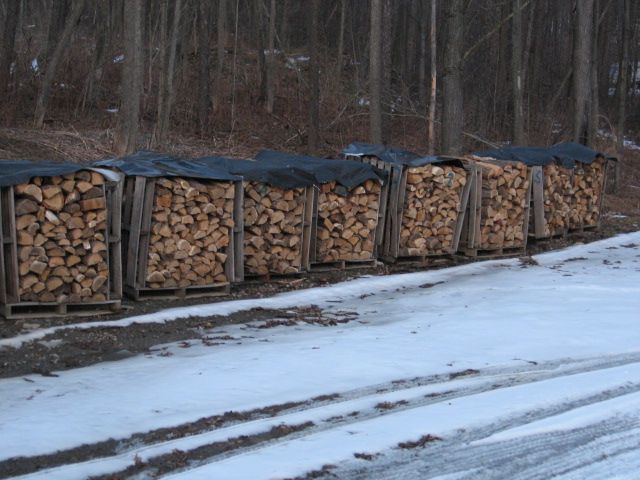

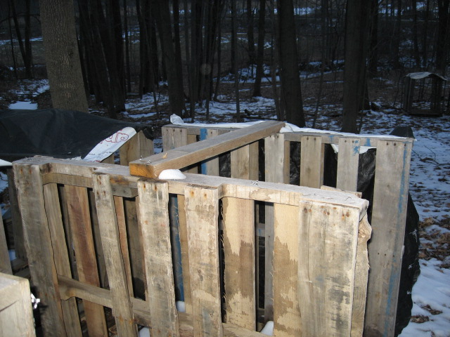

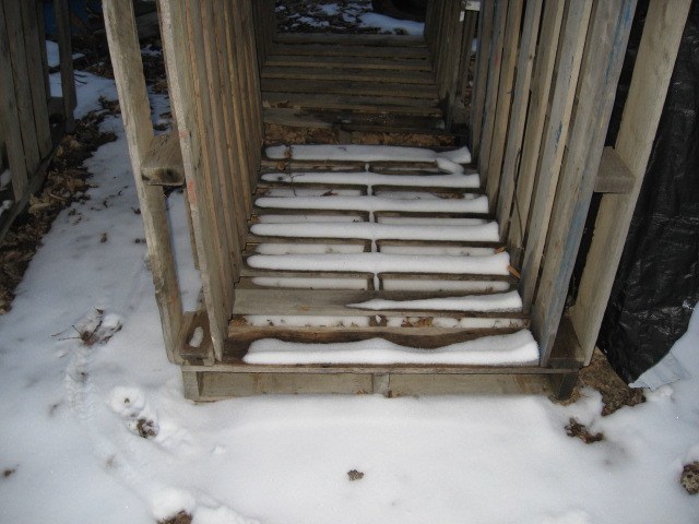

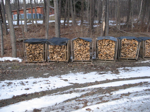

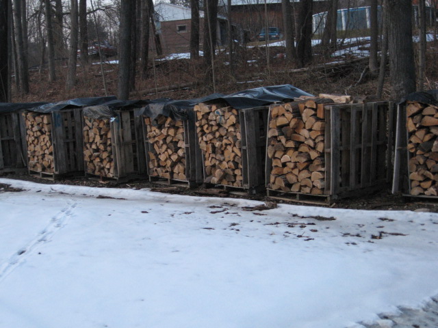

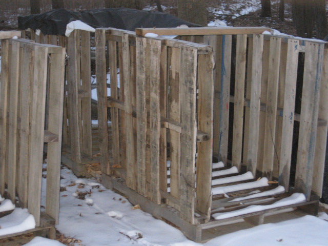

Good afternoon, Bob --
Yes, they were pressure treated and nailed to each other and then nailed to the pallet. The pallets were 48 x 40. The wire in the fencing, I don't know the exact size but you cna probably look at Tractor Supply's site and it will tell you. It is probably a 1/16" in diameter or slightly larger and it was attached to the wood at all points with 1/2" narrow air staples . . .

We learned years ago that we use pallet forks much more often then a bucket. Our barn is outfitted with racking, and firefood is in cages made out of special skids that were used for conduit in an electrical warehouse. They have corner posts that are maybe five feet high, and I welded wire mesh on three sides. These baskets stack too, with the flanged legs nesting on the square corner posts. I just hate double handling firewood! The only glitch is when on occasion I have lost a basket because of terrain.

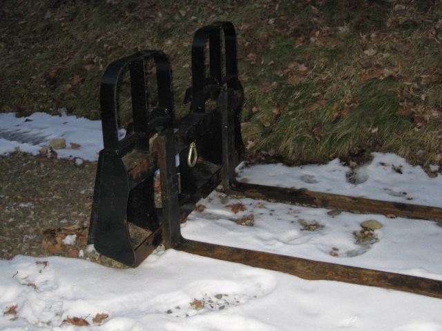

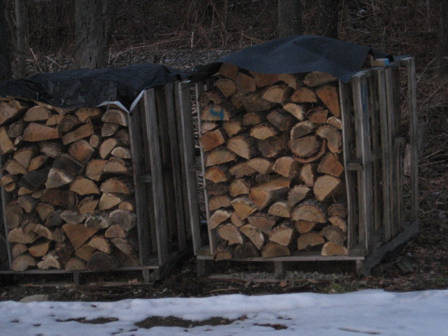

this is how i do my wood 3 40x48 pallets nailed together w/ 2x4 on top to keep from spreading w/ lumber wrap on top staple on and trim also these are my forks horst pretty damm good but i did manage to bend one of the tines
already but not bad tell me what you think about the boxes i have a lumber yard so i have lots of them Img_0063.jpg
