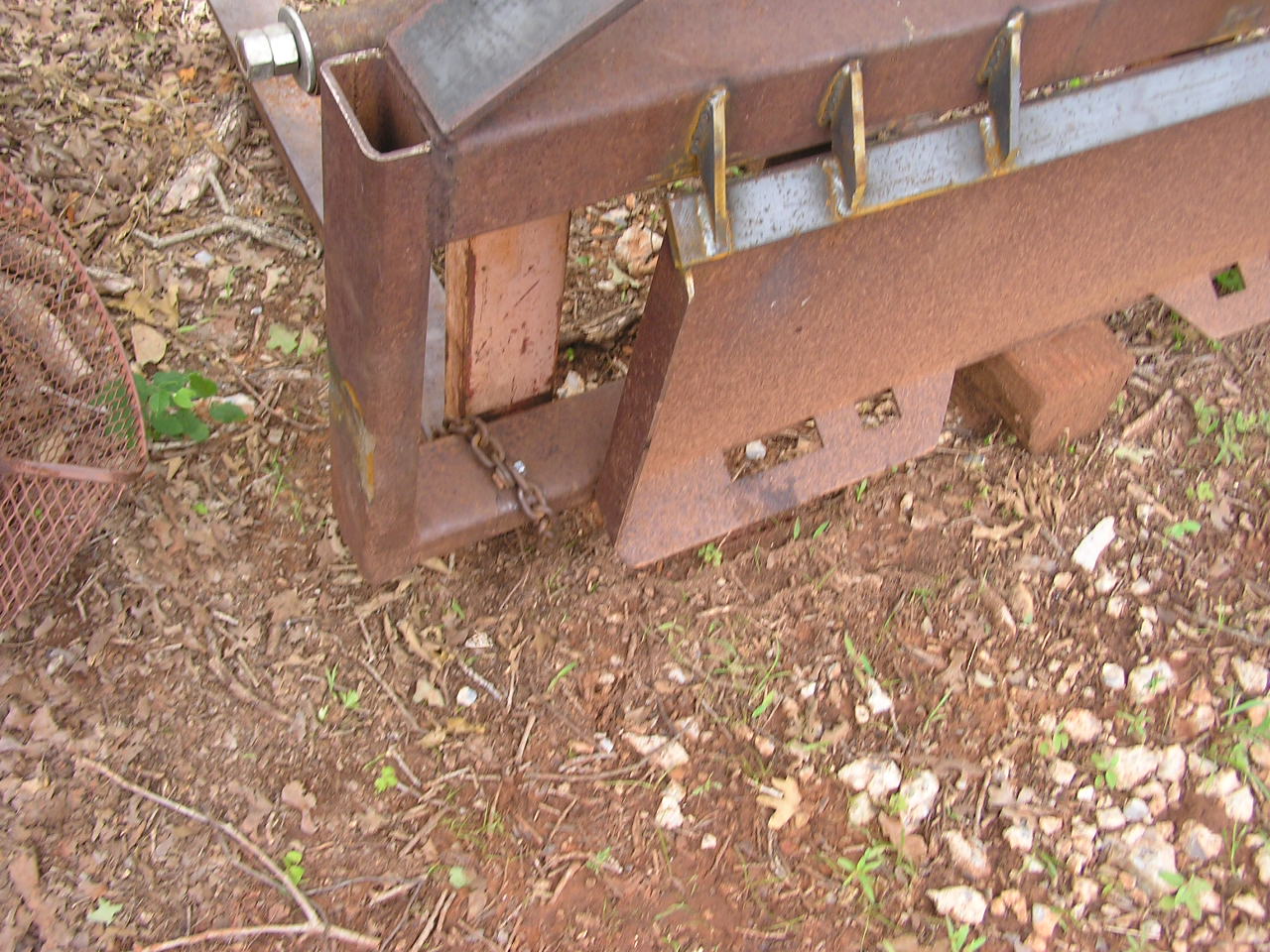

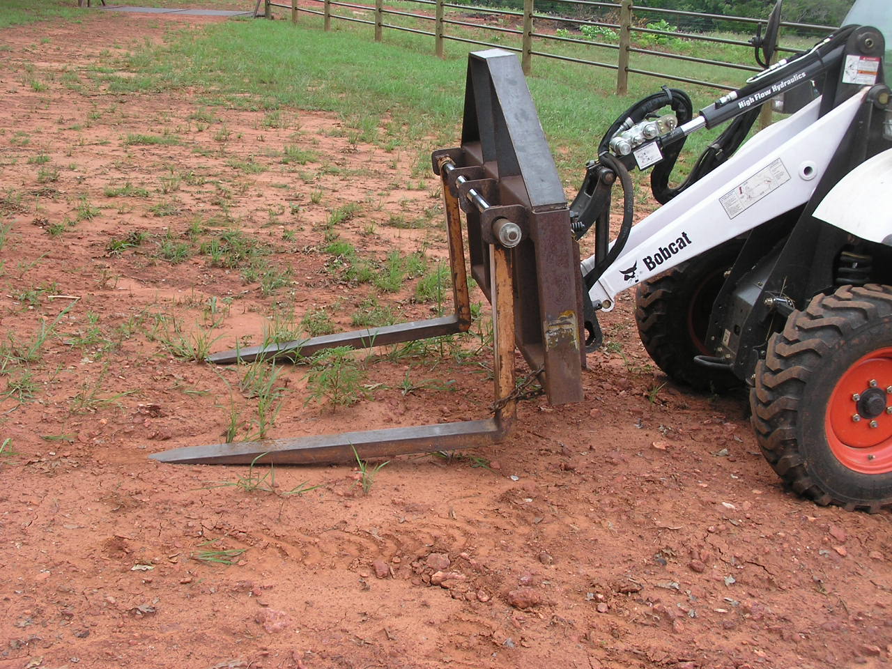

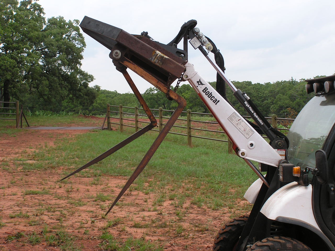

Put some hose clamps or U bolts around the rod, to keep the forks in place. For moving brush, I use a short piece of chain with the ends bolted together, around the fork and the outside of the frame. That allows some flexibility on uneven ground and will allow max dump angle.
Chain on one to show the difference at max dump

Well the forks on mine don't swing out like that, it is just that they will slide. The hose clamps would take more time to put on each time, and require readjustmet for each fork width than I would care to invest. This is not much of a problem, only when moving fast on hilly terrain and after you grease the rod:). So it is no big deal to me. I think my vertical weld beads on the lower square tube bar Idea would work to solve the problem, but it is not enough of a problem for me to get my lazy..... out there and actually do it.
