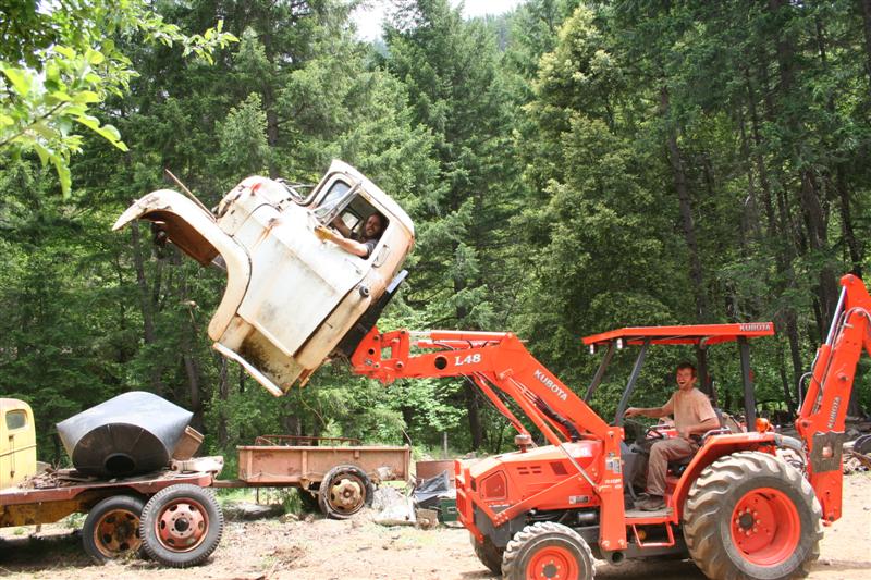

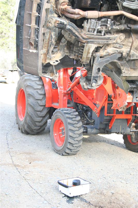

I do alot of heavy lifting with forks just keep it balanced and maybe use your BH as balast on slopes,be ready with your hand on the FEL stick to drop the load. You and your friends will love them! you can even use them to change your oil!
I would and will recomend a quick attach type as your lift ratio is rated at your link pins and not the front of your FEL bucket. So if you want to lift heavier things or have a smaller tractor? it will help considerably also when lifting(very important!) place your forks under the load fully then curl the forks/load then lift. remember you ratio is at the pins and the closer to them the easier the lift. its much easier to lift heavy loads when you curl first.
I use Gearmore forks and am very satisfied.
good luck.

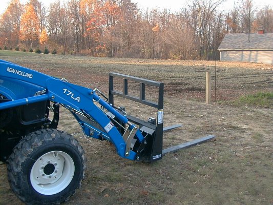

We picked this set up from the NH dealer when we made a package deal. I use them quite a bit, and they have stood up well so far.

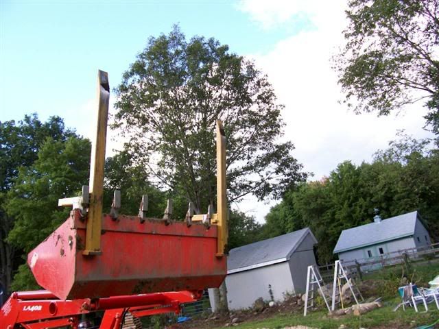

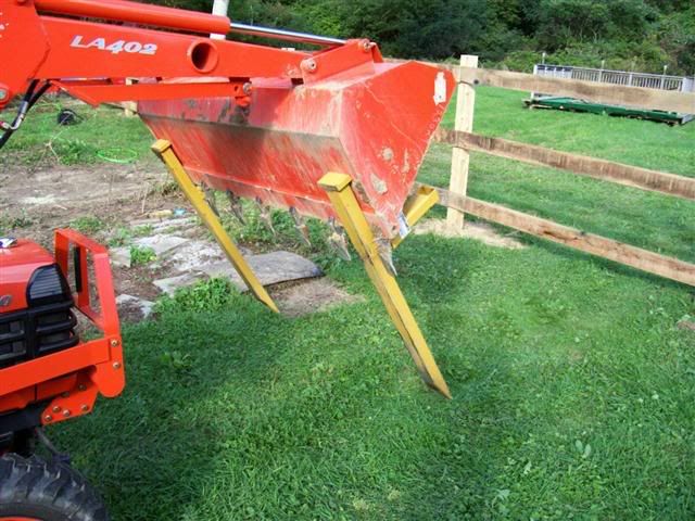

I know the ones I have work fine on the bucket alone. I don't use any binders to hold them up at all. They go under my bucket more than 1/2 the depth and bite inside behind the tooth bar. Your right though they would be a great help cleaning up your barn. Did you have any insurance on that also the old weather veins are worth quite a lot if its an antique. I'll go take some bottom pics for you so you can see were it sits on the bucket
I have them all the way to the edge of my bucket because I have been laying fence so I wanted a stable load I hope this helps
