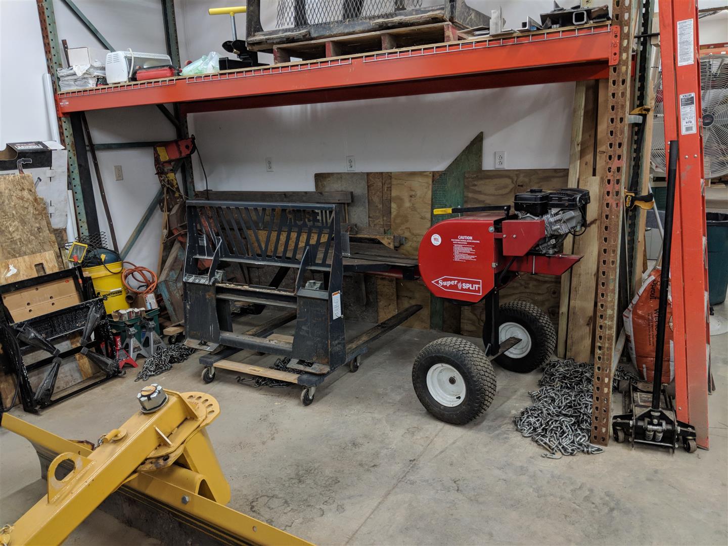

I would not suggest that you can pick an implement off the rack with the SSQA directly. You need a lot of vertical space to be able to get it hooked, lifted up and curled to make sure it doesn't fall off. If you only have one pallet rack at eye level or so and nothing above it (or at least say 3' clearance above any implement), then you might be able to directly pick it. I put my grapple on a pallet and up in the rack with the forks. The forks are on a dolly below. You can barely see the grapple in this pic and the forks below. I only have a few inches clearance above the grapple and the forks are a lot more flexible in picking it off the rack
You could always come up with a way to stand the bushhog up on edge. I've seen it done with mower decks, but haven't seen anything as large as that done this way. Could work, especially if it is a very rare thing for you to use.

How many shelves ?
I would only do two shelves on each segment, so four shelves total. I might make the lower shelf relatively high up, even above the hood of my truck so that I basically can't hit the shelf (though I could hit attachments below it). TBD. So one implement on floor. One on the first shelf. Second shelf implement TBD. Times two bays.

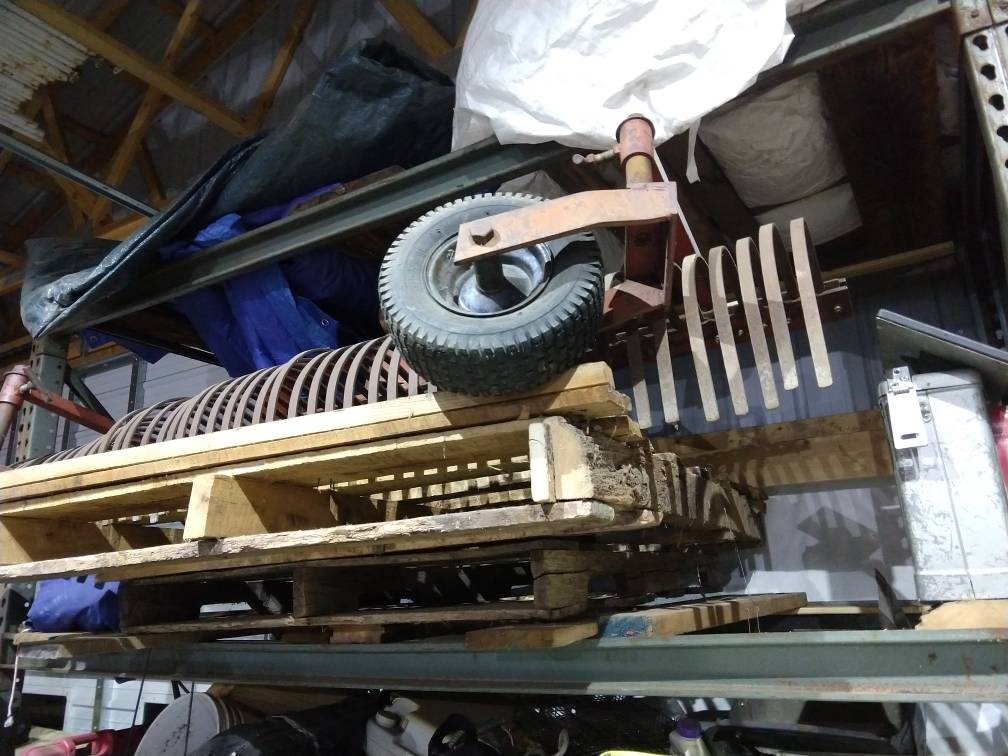

I have pallet racking in the shop in an L shape and keep the landscape rake, the bakblade and a couple of mower decks on it.
We ended up picking up a walk-behind electric forklift to put stuff on and off which makes it far more convenient than trying to use the tractor on the side that is not straight in from the door.
For what you're doing, it sounds like a tractor should work fine.
If you look around you can find pallets that are different than the normal size, I have my landscape rake and backblade on a wider/deeper pallet than a standard one which I picked up someplace, might have been a place that received in equipment on pallets. Can't remember off hand.

Your picture certainly looks something like I was thinking of. It looks like your entire fork fits underneath the shelf, what are the rack dimensions?
I don't think I would ever try to stand my rotary cutter up. At 745 pounds that sounds like a good way to kill myself, or at least break a lot of stuff!

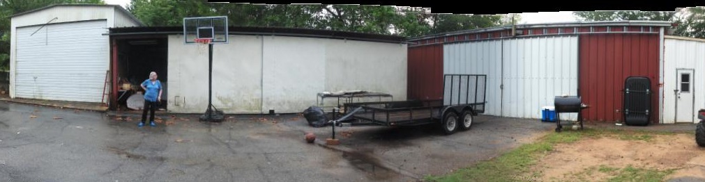

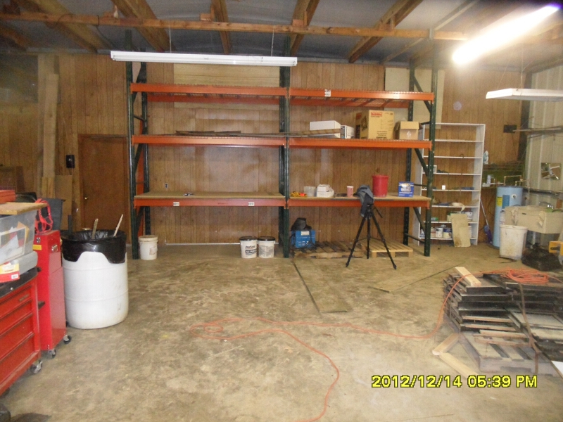

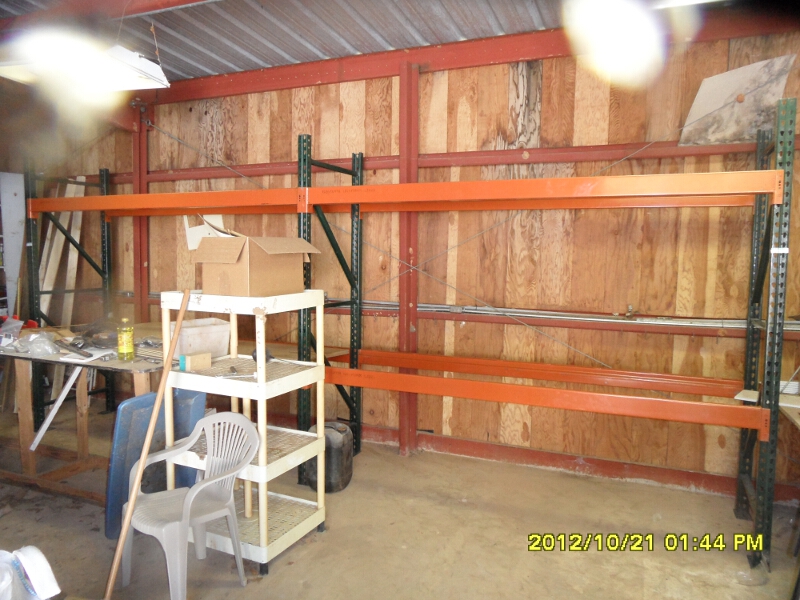

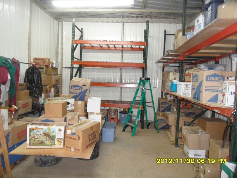

I've 4 workshops with a few feet of racks:
646385d1584766182-pallets-racks-attachment-storage-not-outside-shops-cropped-jpg
646381d1584766044-pallets-racks-attachment-storage-not-8x6sam_0727-jpg
646382d1584766044-pallets-racks-attachment-storage-not-8x6sam_0773-jpg
646383d1584766044-pallets-racks-attachment-storage-not-8x6sam_0768-jpg
646384d1584766044-pallets-racks-attachment-storage-not-8x6ford-rv2-jpg
plus 8 more units not pictured and 2 sets of beams for 12' shelves, 3 layers that I need to get teardrop uprights for.
So all told I'll have about 200+ linear feet.
Pallets racks are like tinkertoys for big boys. I've set up several sets and then a year or two later taken them down and moved them around. They are heavy but a lot easier to reconfigure than anything else that will hold a few tons.
I store things like my 5' tiller and rotary cutter on 2x4's resting on HF's $8 furniture dollies for rolling under the first layer. So they can be pushed partially under.
Most of my sets are built so I've got the first level so with a sheet of 3/4 plywood topped by a sheet of 3/4 MDF it comes about elbow height and makes a good standup worksurface that I can mount a vice on etc. And plenty of storage underneath.
Then on many of them I set the second shelf up so I can fit a 30 inch high kitchen wall cabinet on my HF's $8 furniture dollies. Thus I have a loaded cabinet I can roll to the back, but if needed (because it's hard to reach) I can pull it forward. I've got a bunch of kitchen cabinets free from a remodel.
I'd recommend you be flexible with the height of the uprights, I've trimmed off some 12' to fit under a 11' rafter, because I got a bunch of 12' uprights for $10@, but try and get the longest beam you can afford.
You don't mention cost or availability.
Most of my racks I bought for about $150 to $200 for 3 or 4 sets of beams and 1+ uprights, but I had to search for about 3 or 4 years to get the 12' beams cheap. However with the economy crashing there will probably be another flood of bankruptcies and sales of cheap pallet rack.
Some people are able to get them free.
With the stock market crash I expect another buying opportunity.

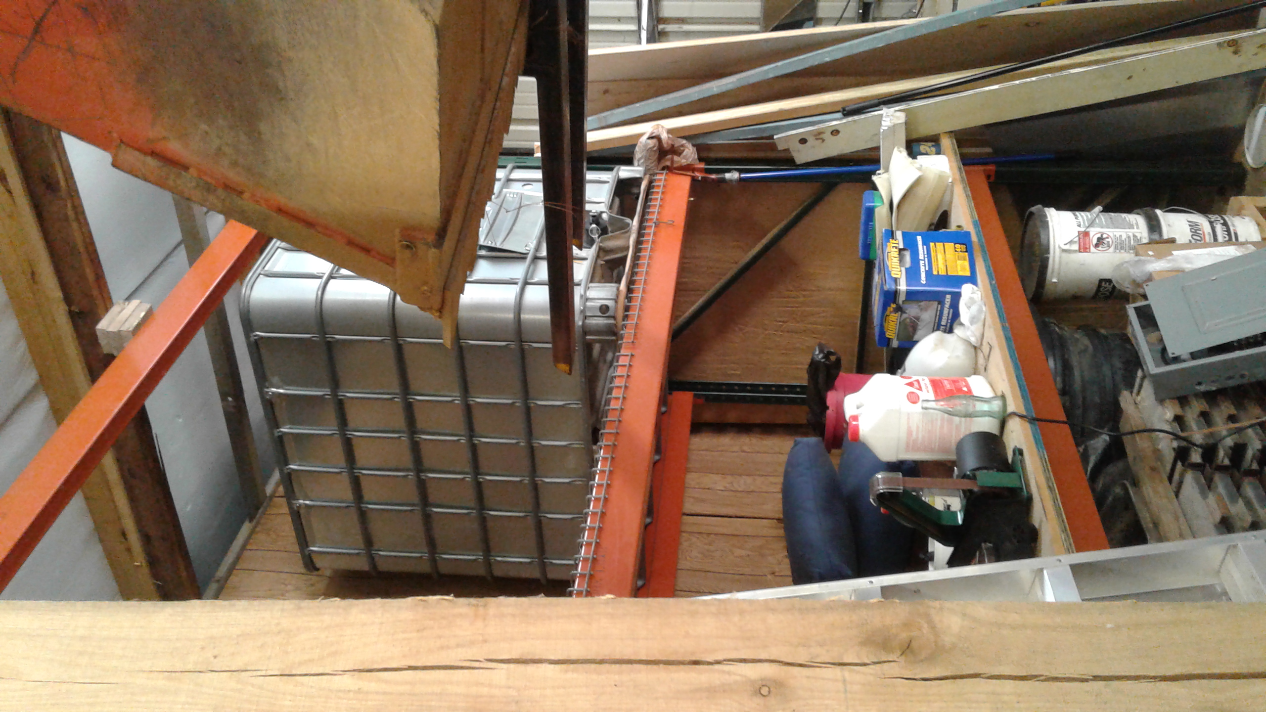

I don't currently store any attachments on the racks. But I do store a full tote of water (see pic).
