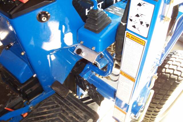

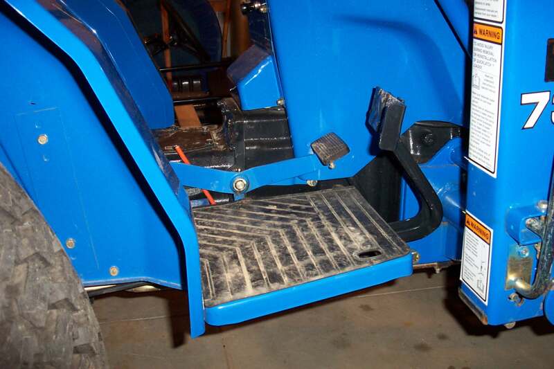

Well, I use my parking brake quite a bit so I can leave the tractor running when I climb down to attach implements, a chain, clear my path, etc. On the NH TC30 the parking brake is set by reaching down and pushing forward on a very short lever. You must simultaneously push the brake pedal with the right foot and reach 'way-down' and push on the little lever next to your foot and then release the brake (with your foot) while keeping hold of the little lever so the teeth will engage. /forums/images/graemlins/blush.gif I'ts a real pain /forums/images/graemlins/confused.gif I don't bend so much in the middle anymore and arthritus makes it hard on the hips. My old John Deere 650 had a spring loaded arm that you set and then sat back up. You would then push your brake pedal and it would 'click, click, click' into a locked position. This was much simpler. So, I'm trying to figure a way to move this locking lever up or automate part of the process like on the John Deere. See photo, the orange lever sets the parking brake.

I can't tell from your picture, but can you hold the brake pedal down with your right foot and engage the parking brake with your left foot? Another option might be to slip a piece of metal tubing over the lever so it sticks up further so you can reach it. A longer lever might get in the way when getting on or off, but maybe you could bend it so it's in a position that doesn't get in the way. It's difficult to reach the parking brake on my TC40 with my hand, but my problem is more like too much pizza, cookies, pie......... /forums/images/graemlins/tongue.gif

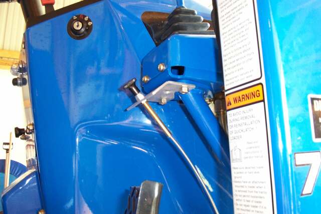

Here is what I am working on right now. I drilled and bent a 1/8 in thick piece of aluminum and attached it to two existing studs under my selective control valve. I then drilled a hole to mount the control knob assembly. The hole is not centered, but favors more toward the tractor for clearance reasons. See picture.

View from below. /forums/images/graemlins/laugh.gif
The control comes a little closer to my foot than I would like. I will leave it in place and test it for fit a bit this week. I can always readjust the position.

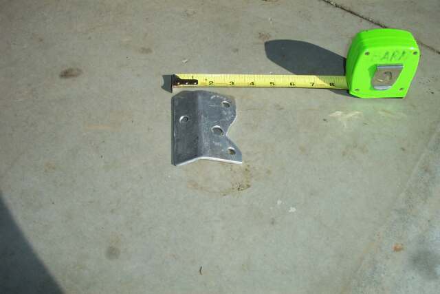

Picture of the bracket. This was a piece of scrap so it has an extra hole that serves no purpose. The notch provides clearance for the loader valve 'down tube'. The holes are 3/8. /forums/images/graemlins/cool.gif
