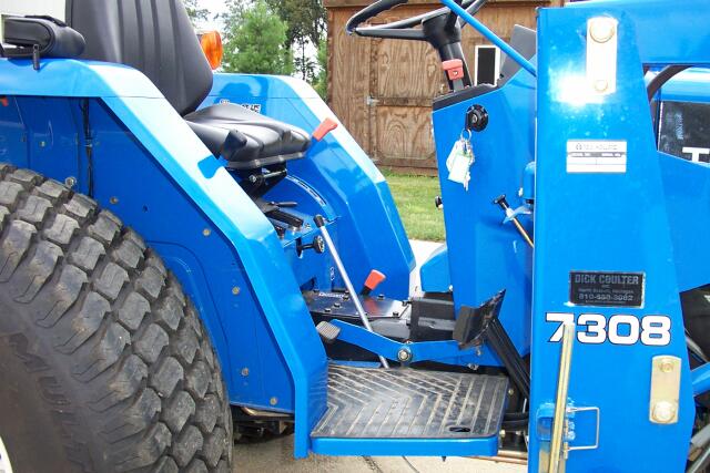

OK Mike, I think I have decided on your low-tech solution. I installed a piece of aluminum tubing with a chair tip placed on the end. The first photo is the lever in the locked position.

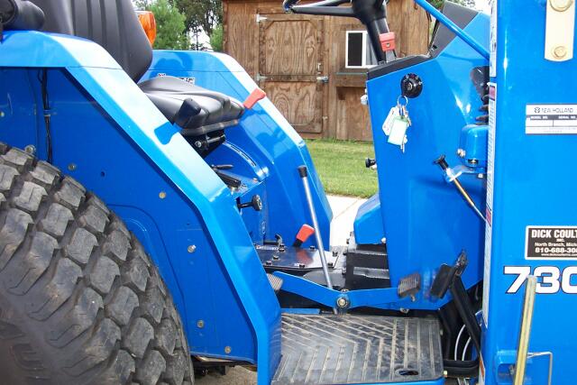

   / Parking Brake Pain in the Back !
#28
This photo shows the lever in the retracted or 'unlocked' position. I think I understand why NH made this lever so short. Extending it defeats the 'step through' 'open operator station' design. Extending it would have eliminated a marketing feature for them.
   / Parking Brake Pain in the Back ! #29
Jerry,
I think they made it so short for a "step thru" platform. I can see where if yours is locked, It may make it a little difficult for a big booted person to step thru.
Jerry
   / Parking Brake Pain in the Back ! #30
I'm still a little confused why an extention is needed. Don't you use your left foot to set the brake lever?
--->Paul
