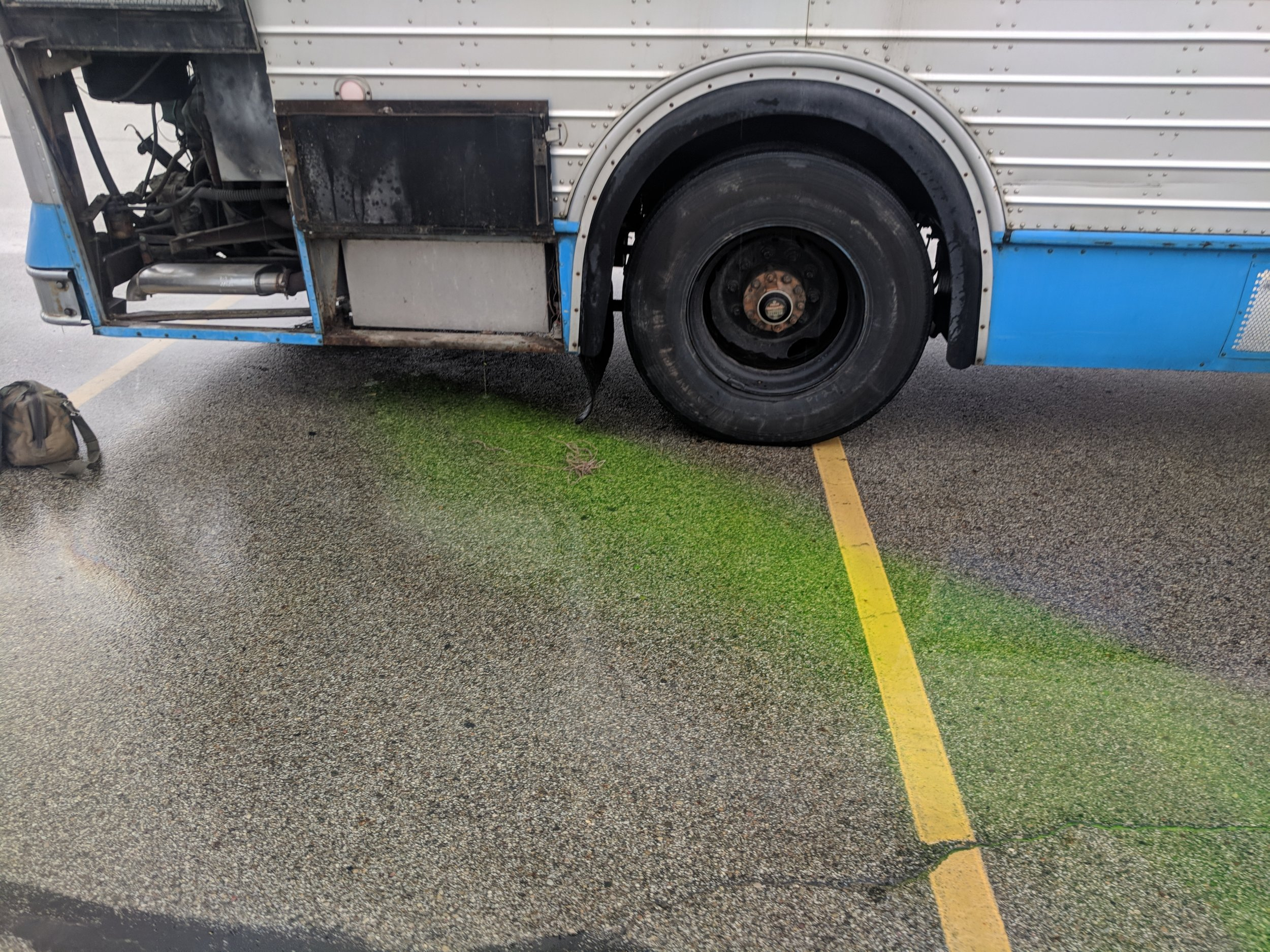

Yes, I could arrange an engine coolant heater if I want. That is why I didn't worry too much about getting rid of that monster diesel-fired heater.
FYI this was the day I finally got tried on that monster and all its extra piping:
And yes ether works if needed so I could probably get it started in the winter. But that is an awful lot of trouble for preventing a possible problem that only happened once in the last 10 years of parking it most of the year.
