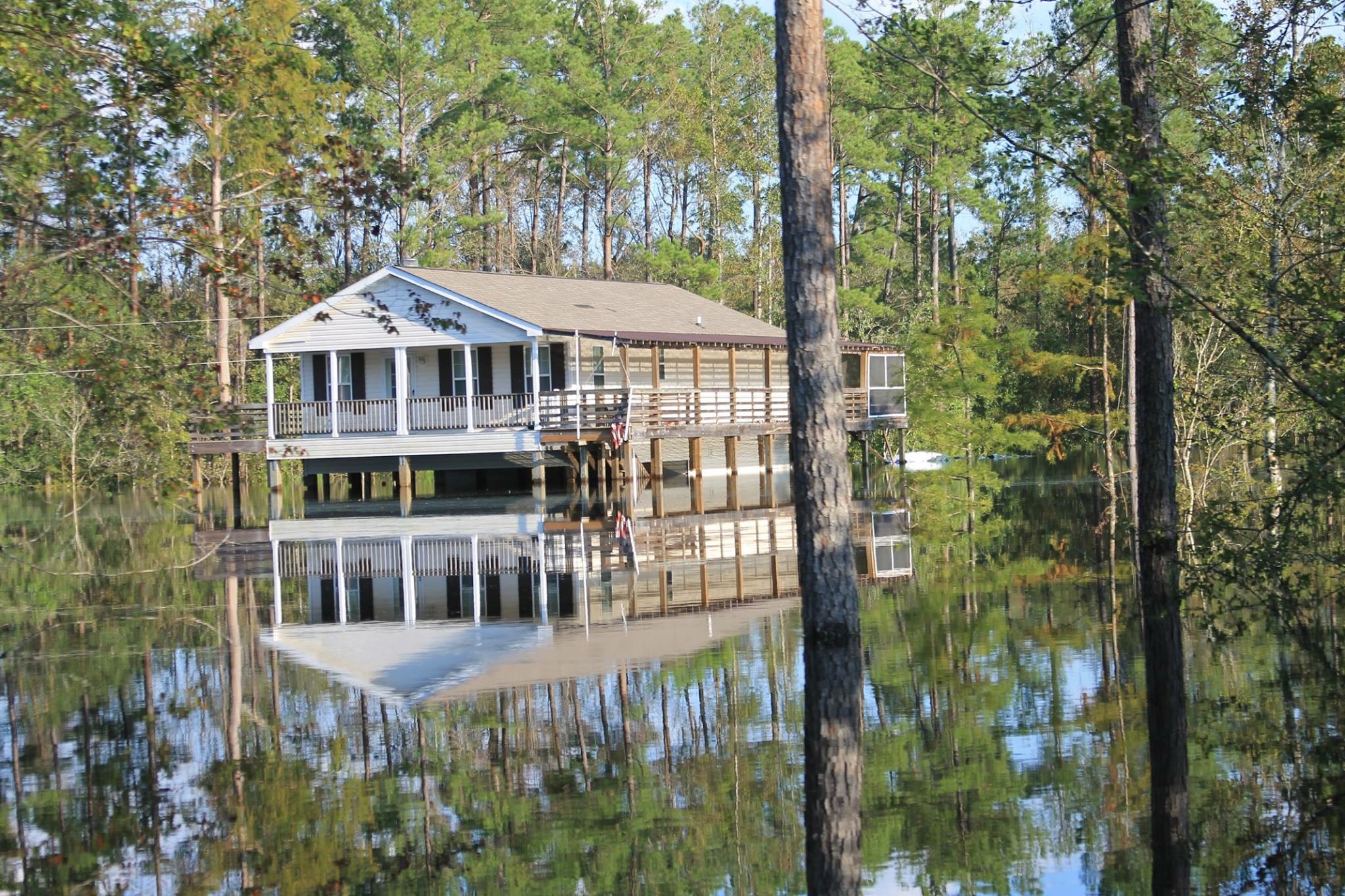

Bought my well used Kubota L5030 about 5 month ago. Had just under 3000 hours buts fired right up every time. 4x4 needed repair, and there were some small issues as well but worked. Well, Hurricane Florence decided my dirty tractor needed a serious bath and submerged her under water for about 10 days. Not expecting that kind of flooding the battery was left attached and the wiring harness is junk as are all the fuses, starter, and most likely the dash and other things. I am hoping to turn the engine over next weekend to get water out of the cylinders. I had just bought brand new tires for it, has a loader with bucket. I don't think I really have time to part it out since my house was badly damaged as well and need to work on it. Would I make significantly more parting it out? Since people want pictures here it is.

Think this will be the best plan at this time. I really don't have the time to fix it and it's paid for so having it sit for a while won't cost me anything. Might just throw it up on craigslist and see if someone wants it.
