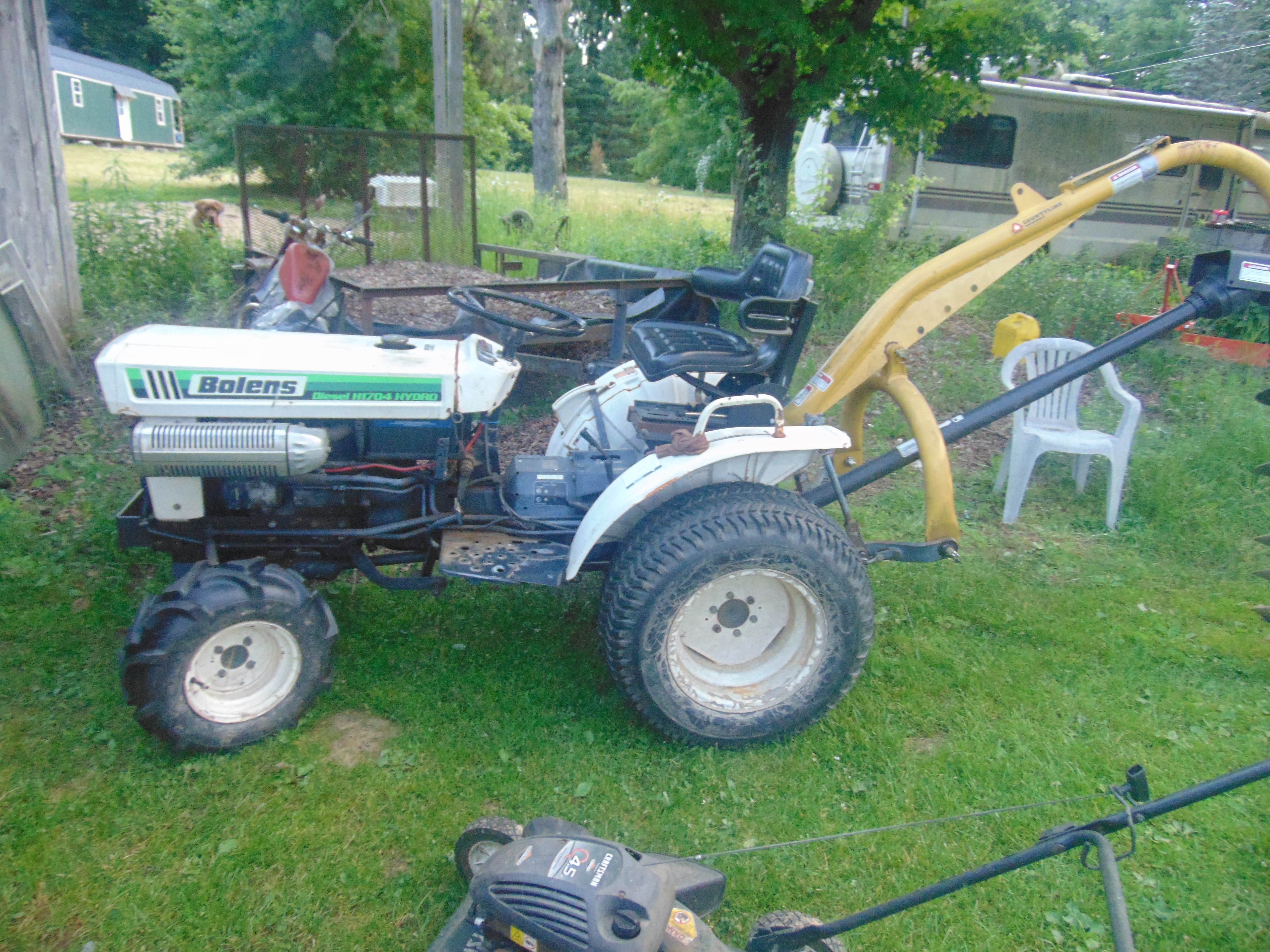

This is the hydrostat.
Good evening: Opinions on the parts availability situation for Bolens/Iseki? And also sources of paperwork (service manual, parts diagram) Looking at what is supposed to be a Bolens 1704, although the information I have found says that this should be a hydrostat, while the tractor itself is a gear tractor. Had a Mitsubishi tractor a while back and parts were a bit difficult to get for that. Here I am looking at another orphan. Thanks.
