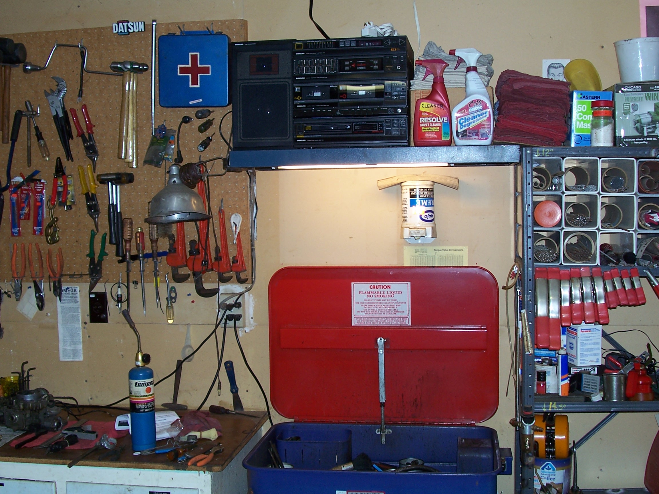

I've got your basic stand alone big tub type. Got it before HF had stores here, at that time (89) there was a fuel distributor up in Woodburn that had solvent at a pump, you filled up containers.
I put a regulator on the shelf next to it with a plastic hose so you can percolate a can with bearings at 1-2 psi and not spend a lot of time brushing and swishing.
