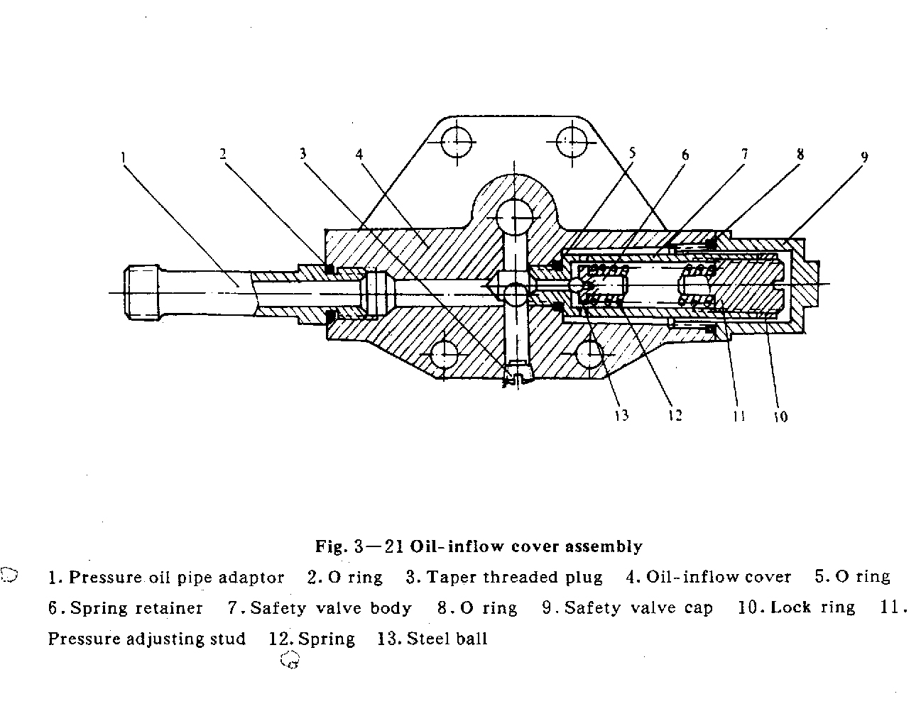

Now that I have one maybe someone could answer some basic questions..
Oil inflow:
#1 sitting on the tractor, is this located on the right side of the seat.
#2 is the filter the last or first to get oil from sump

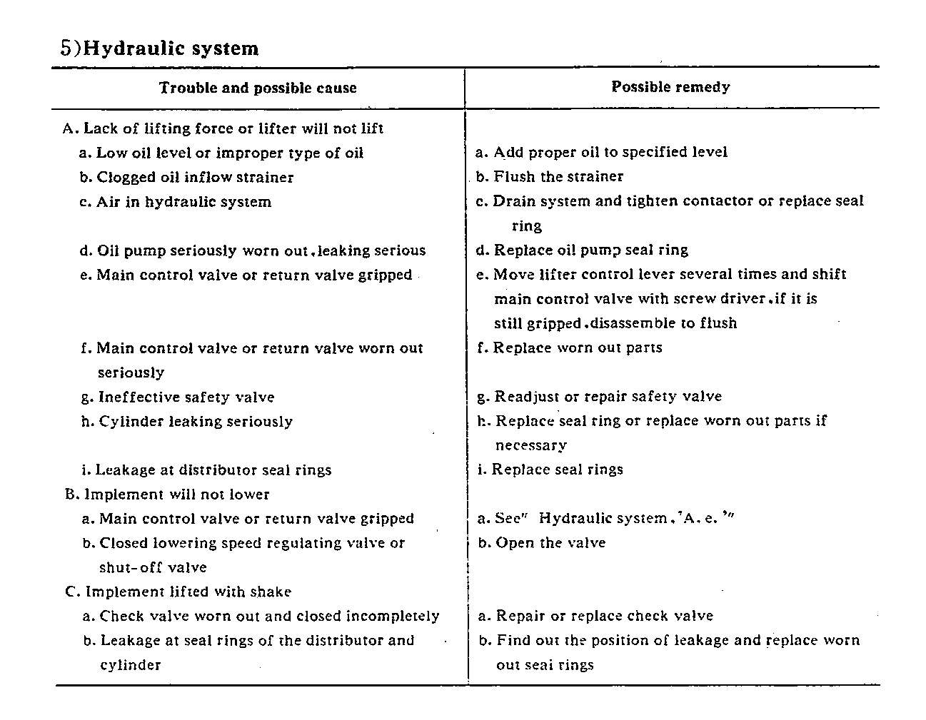

Letter 'E':
What exactly are they referring to as 'Main control valve or Return valve'?

Letter 'E':
My guess is it controls the 3 point and typically is on the right side.
It looks like a typical Chinese hydro system. Where there is a strainer prior to the pump. When its prior to a pump its refered to as a strainer. On my Jinma its set up like this. Reservoir, strainer, pump, systems (FEL 3 point steering), then back to the reservoir.

I believe Chris is correct, but he may not realize that you have a PTO pump. I thought you'd have figured that out when I asked earlier if you'd visually followed the lift lever linkage. Makes sense that they'd call it a main control valve. And yes, it's logically on the same side as the lift lever. The return valve is the one sticking out beneath the front side of the seat; the one that's missing its knob.
