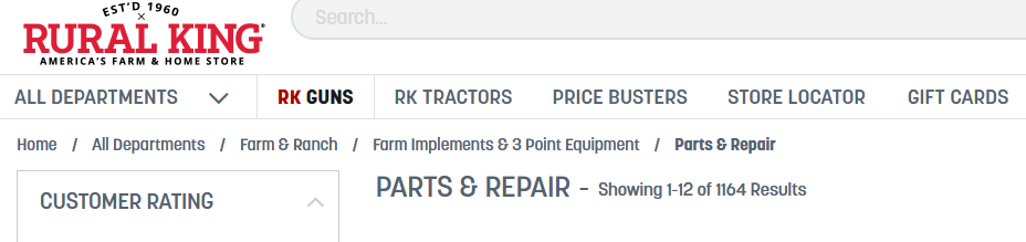

Today I discovered that some parts for the RK can be ordered on line. I had always went to RKTractors.com before and looked at the parts catalogs there but I saw no way of placing an order. Today I was looking at their main website for Pat's quick hitch and when I looked at the different departments I noticed one marked parts and repair. When I opened that one up it shows the common parts such as filters and so forth with a price and showing available to ship to home. As a test I added an oil filter to my cart to see what the shipping would be and it's high. The only two methods available are FedEx and USPS Priority. I marked the USPS and the shipping cost added to the order was something like $11.95 which is outrageous for a $7.99 filter. I wish I would have tried adding a couple other items to the order to see if the shipping cost would have gone up or if maybe it's a flat shipping but I didn't think of it until I had closed the site down. If it's a flat shipping rate that wouldn't be bad if you had several things you need with the price of fuel the way it is.

I tried the site this weekend trying to get a filter and hydraulic filter based on published SKU numbers. Shipping was up to $13.xx so it goes up with item count. However, it would not let me complete the order - out of stock? I did look up the engine oil filter on line - KOMATSU YM129150-35153 at $4.72 and $16.50 shipping +tax... LOL. Quite a bit more than at RK. Lots of other compatible finds on google, but I had to laugh at that low price.

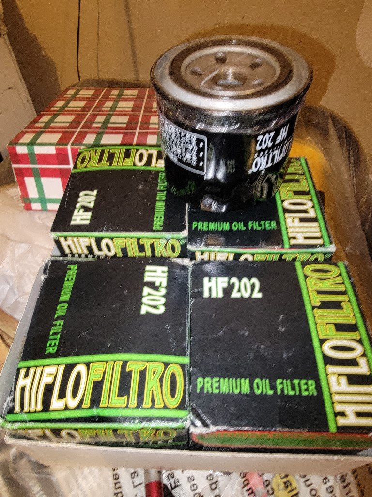

So I got my engine oil filter from RK and looking at my stash I see that except for color it looks exactly like a Honda HP 202. But it is cheaper at RK with a TYM label.
