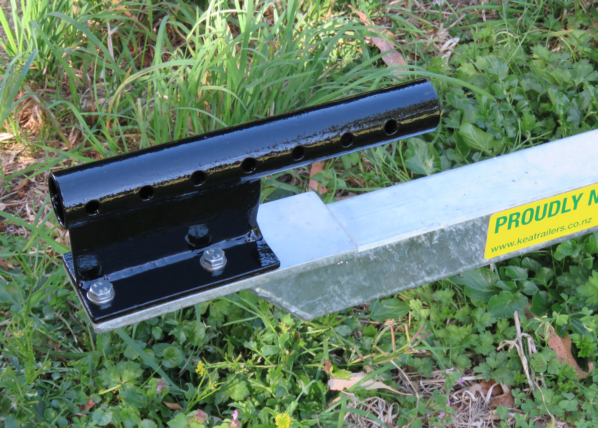

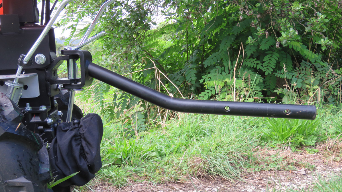

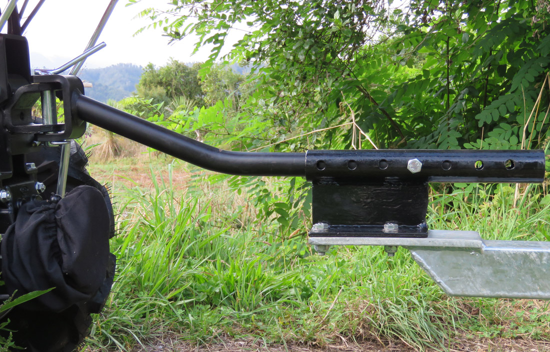

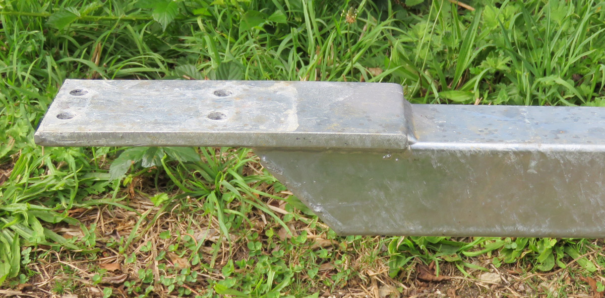

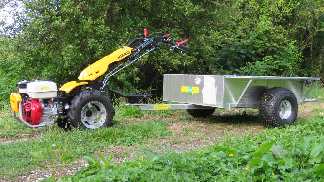

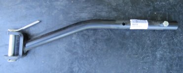

Here are some photos of my way of attaching the trailer to the BCS Curved Coupler (92247720).
BCS-Curved-Coupler_01.jpgBCS-Curved-Coupler_02.jpgDrawbar.jpgDrawbar-Adapter_01.jpgDrawbar-Adapter_02.jpgCoupler-Adapter_01.jpgCoupler-Adapter_02.jpgPasquali-XB40-Trailer_01.jpg

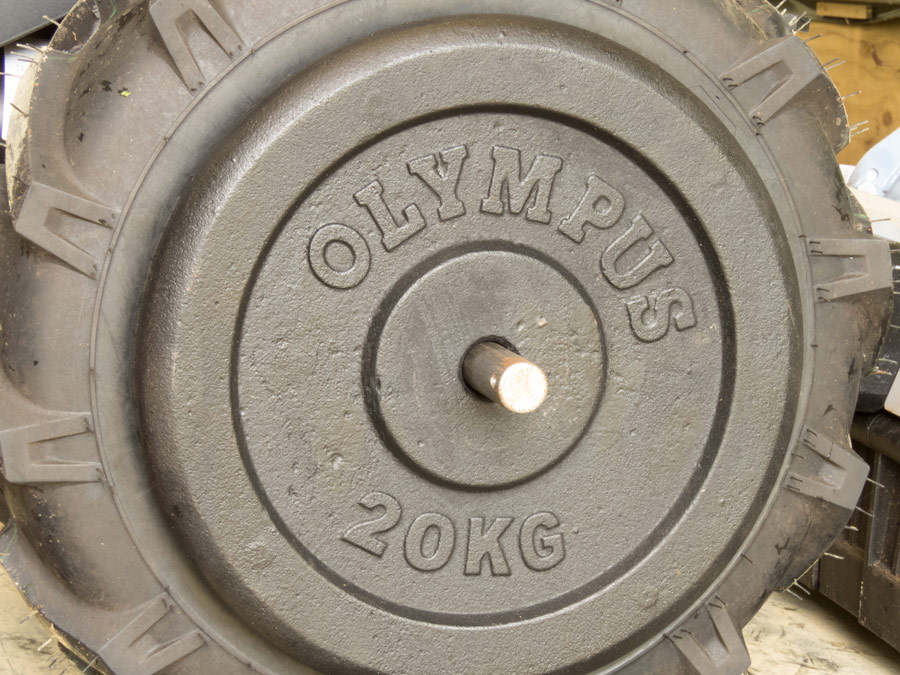

At the moment I am looking at the least costly option and considering making an adapter to use weight lifting plates rather than the BCS weights you are referring to as they would cost me way to much.
Even with my standard 5.0-10 wheels, I should be able to add about 37.5kg in weight plates plus the weight of the adaptor.

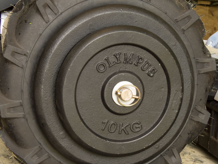

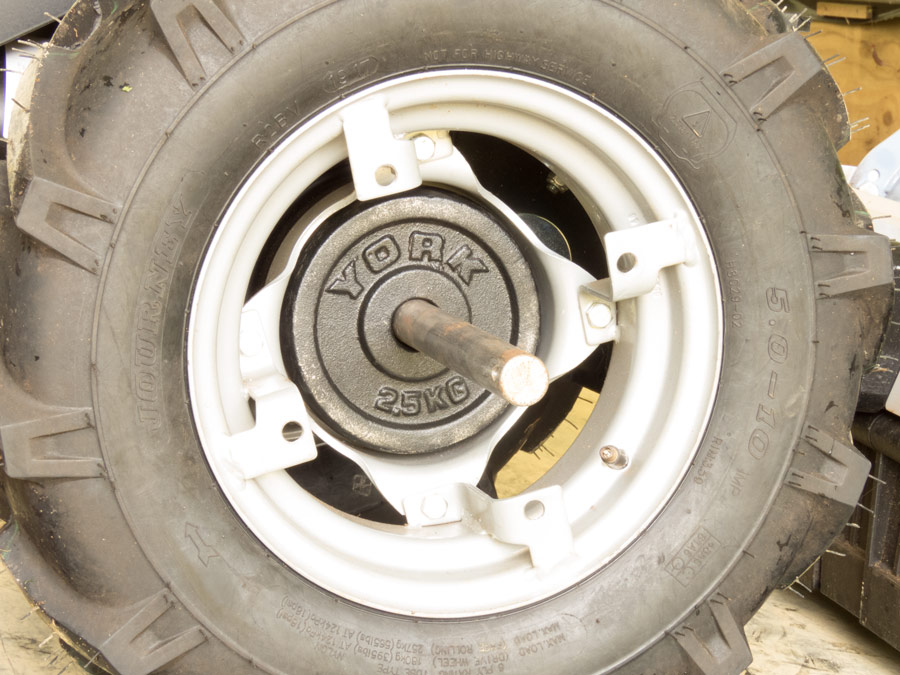

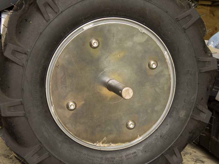

Thanks for all the suggestions. Yes, the Earth Tools Wheel Weight Hangers is the best solution and I would definitely buy them if I was in the US. Did not make much sense to have something like that shipped overseas so I put this together and it works great. Getting the right weights to fit inside the small wheels was bit tricky as the diameters vary between brands.
Weights-01.jpgWeights-02.jpgWeights-03.jpgWeights-04.jpgWeights-05.jpgWeights-06.jpgWeights-07.jpgWeights-08.jpgWeights-10.jpg
   / Pasquali XB40 (CBS 740) Photos #20
That's a very clean solution Tandem. I like the steel plate that's bolted to the rim, since it helps support the bar too. :thumbsup:
