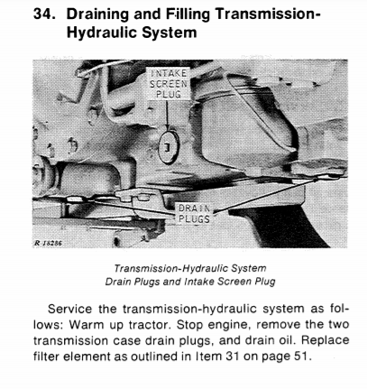

Do you understand how the closed center hyd system operates on your JD 2020?? How long since hyd reservoir screen has been checked/cleaned?
I don't understand how air could possibly get in tractors main hyd system just by rebuilding FEL control valve. Yes repaired FEL control valve circuit will have air in it but that air upon cycling FEL cylinders would be sent directly to trans case(hyd reservoir) not to the frt pump. You're correct JD doesn't offer a hyd bleeder valve nor is a bleeder valve needed.
2020 hyd chattering is probably caused from frt hyd pump have low supply of oil or stroke control valve not operating as designed BUT probably not caused by air in hyd system from rebuilding FEL control valve.

Sorry missed reporting some important points in previous post. Also replaced some hoses and fitting. Checked fluid level and it was low. (proper check requires checking oil level with tractor RUNNING at fast idle. Had been checking when engine off.) It required almost two gallons to top off. Yes, know of the screen and it was removed and cleaned. Purchased this tractor used in 1997 and as with old tractors things wear out or break. Over the years I have rebuilt a lot of the major systems. The last few years it's the hydraulic system, new pump, hoses, connections. Hopefully pretty much the entire hydraulic system. Couple years ago in was the cooling system, water pump, radiator, etc. Electrical and ignition system was also a few years ago. Which I converted to an electronic system.
