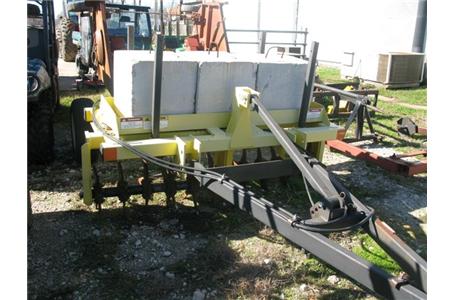

I have had my eye on this one at local dealer $5995 airway.jpg 8'airway

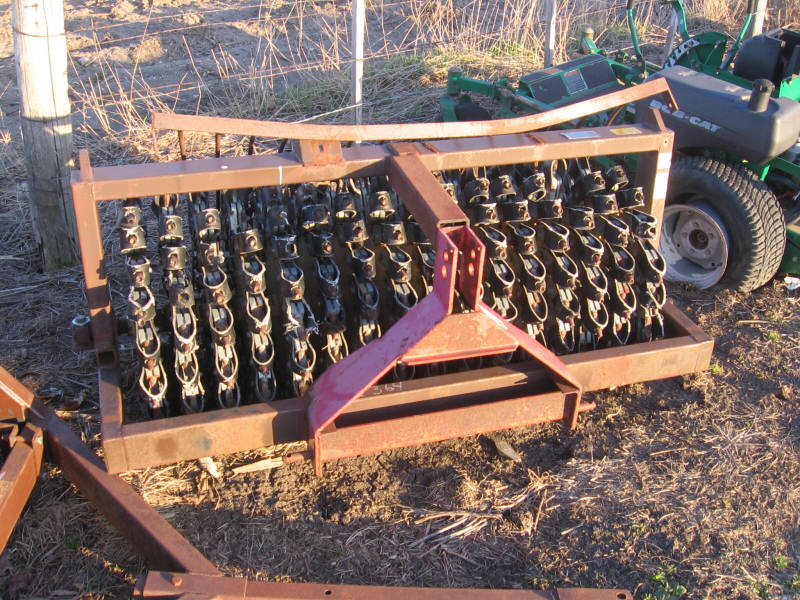

Cantoo, would you mind sharing the brand name of the aerator in the picture you supplied? Thanks
/ Pasture Aeration #7
Aeration needs to reach the root zone. We use core aerators (as above) for our lawns at the state parks. They help with root growth. Not being able to use pesticides or fertilizer, this process is our best bet for healthy sod.

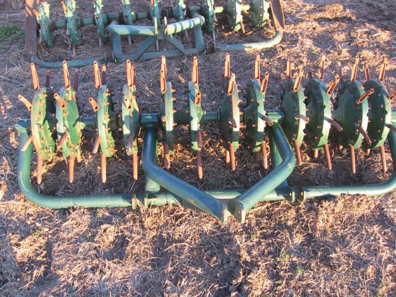

The green ones I think are Ryan brand aerators. The last 2 that I sold went to North Carolina. I had a couple of these too.
Around here farmers are using aerators in front of and behind liquid manure spreaders to aid in getting it into the soil instead of running off.

I have a tow behind Ryan lawn aerator that has the same weight disks. So I can confirm you're correct. I didn't know Ryan made a 3 point aerator before. Having the disks rotate independently makes turning easier. The spoons are replaceable but not cheap.

For that many acres, you would be better to buy an old one if you can't rent one. RD rancher is right on the time being close to bush hogging but fuel usage and the chance of damaging the machine would be way less so adjust your price accordingly.
They also make tow behind ones that have a hand operated hydraulic pump to raise and lower them, depending on your property type if you don't have a tractor you could tow it with a truck.
The aerator type are pricy, the one I had was the slicer style and I wasn't impressed with it. 4" wide and tuff looking but everything worked, bought for $500. Sold it for more.
