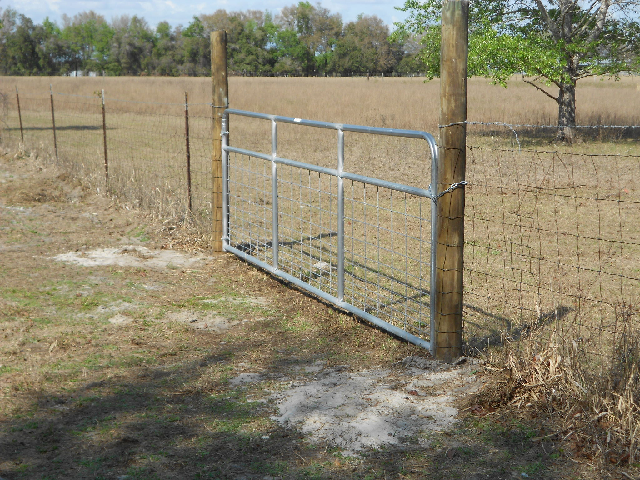

I finished my pasture gate project this past week. It was nothing exotic, just a 12' wide metal tube gate that I put into an existing barb wire fence line. Total price with incidentals was about $250 with the bulk of that being the gate itself. Used my MF 1529's front end loader to lift the gate into position while I ran the hinge bolts through the post. The Mrs. thought that was a lot better idea than her holding up the gate. :D

Looks pretty dang good. Nice work. I partially bury a concrete block under the latch end to carry the weight of the gate day in and day out. You do have a brace section at the hinge side which helps a lot. I would X brace that the other direction as well. I would also put a brace section at the end of the barb wire fence on the latch end with a wire rising to the left to hold the tension. Otherwise that side of the fence likely will start pulling away and put strain on your latch as well. Just my :2cents:

You can't see it in the photos, but I only have 25' of fence going from the latch post to the end of the fence. Do you think I'm going to experience that much of a tension issue on that post?

Looks good! In general, I’d agree on the double posts both sides. But based on how nice everything looks so far any little bit of slack and you’ll end up adding a diag brace/second post. Not a big deal now. If something is going to show up it will probably be next spring.

In this photo, the latch post wasn't yet installed. That post is now located where the first t-post (to the left of the wooden hinge post) is in the photo. You can see the 25' of fence that exists past that post. Am I correct in my understanding that the 25' of fence is most likey going to experience sag in the not to distant future?

Depends on frost line, soil type, wire tension water table etc. We may be over thinking it and it may be just fine. It’s an easy fix if you start to notice anything moving. The other option is one of these-
Wedge Loc Corner & Inline Brace Set Amazon.com : Wedge Loc Corner & Inline Brace Set : Pipe Fittings : Garden & Outdoor
They are quick and would be fine for a short run.
To be clear though- if it was mine I’d leave it until I noticed movement....it may not happen.
/ Pasture gate #7
How deep did you set the posts?
No worry about frost here but I always put the posts in 4' and don't have problems with sagging.
