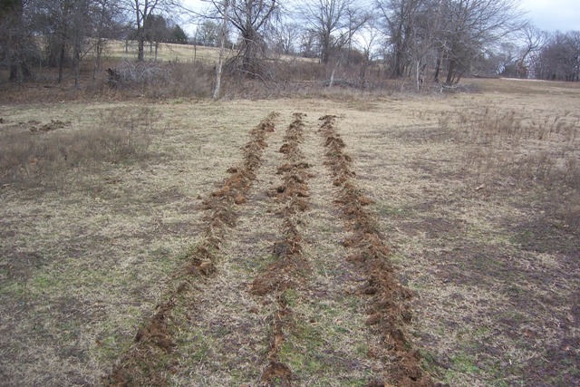

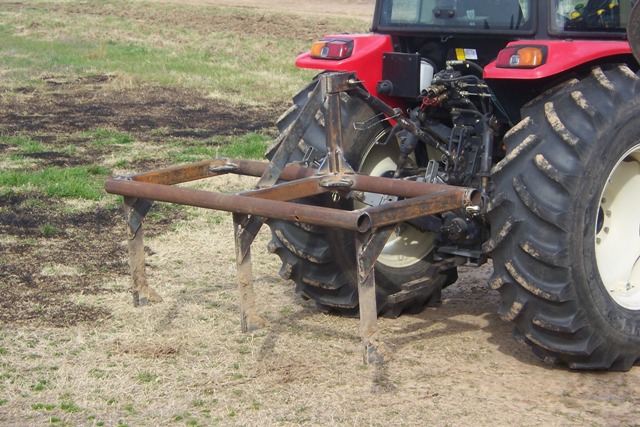

The Hay King renovator has coulters that slice the sod. That way, you don't tear up the sod in the first place. Coulters also allows the plow to run deeper with less resistance.
Yes thats correct and thats why I was saying I had the problem with the boxblade ... I have since added coulters to the unit I built and today I hope to finish the break away shanks ... I didn't do that at first and planted a shank in the ground!!!
I'm still fine tuning and will post some up to date pictures.

Are those formerly box blade rippers? I have two plans ... one tilt the bb forward so it will not collect or add length to my rippers by bolting some metal stock to them.if it work could even weld the additional length
What is a good depth to try to achieve 6+ inches below? or more

These were the bars from old combines that the sickle sections bolted to. I'm going as deep as 14-16... A bottom plow will go 12" deep and I want to break the old plow pan, a disc will go 6" and devolope a disc pan ... so I breaking the disc and plow pan.
Some folks don't realize a disc can compact the ground.
