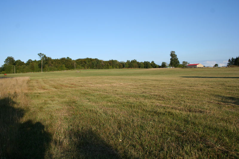

Thanks for the input. I have around 15 acres which I would like to renovate this fall. I can not simply disk or plow this entire cow pasture. The pasture is simply too rocky. There are large rocks just peeking out of the ground every 20 or thirty feet over the entire pasture.
Over the weekend my sons and I cut the pasture, pulled chain harrow (great for rolling the surface stones), and picked up all the stones (baseball to basketball sized) we could find. I hope to spray with 2-4-d this week to get rid of many of the broad leaf weeds. After that break up the sod a little to expose soil for the new clover/grass/trefoil seed. I do not want to go any deeper than 1 to 2 inches because of the rocks. Soil compaction does not seem to be a problem in most of this pasture.
Attached is a photo of my pasture. It is really hard to tell from the photo the real condition of my pasture.

Well, if you're using round-up, pasture renovation is going to be a helluva lot easier. I elect not to spray, so it takes a lot more mechanical action.
   / Pasture renovation with modified with rototiller #19
Ever try a Harley rake? The beauty here is shallow penetration, leveling, and somewhat packing of the soil. It can get the sod balled up in front if it's rooted heavily, but if you let it dry it can knock it to bits. It will also cull out the stones for you.
I've been through the bottom plow, followed by rototiller (big mistake) and would definitely recommend a Harley rake. You can pitch it too to create small drainage troughs...
