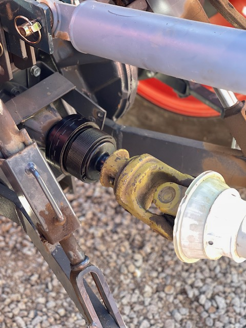

One aspect I like about Pat's QA is the bolt on application. This means I can remove it and the tractor is unchanged.
One thing I didn't like was having to extend the top link connection 4 inches. Again I made a spacer I could remove if I change my mind about this modification.
Below you can see a bit of the top link extension and the PTO extension which is in the form of a quick attach also. It is super easy to change attachments now. I marked the spacer bar that comes with the Pat's QA for each attachment. Just set it to width and back in and lift.
I did mod the PTO shield angle and reinstall.
