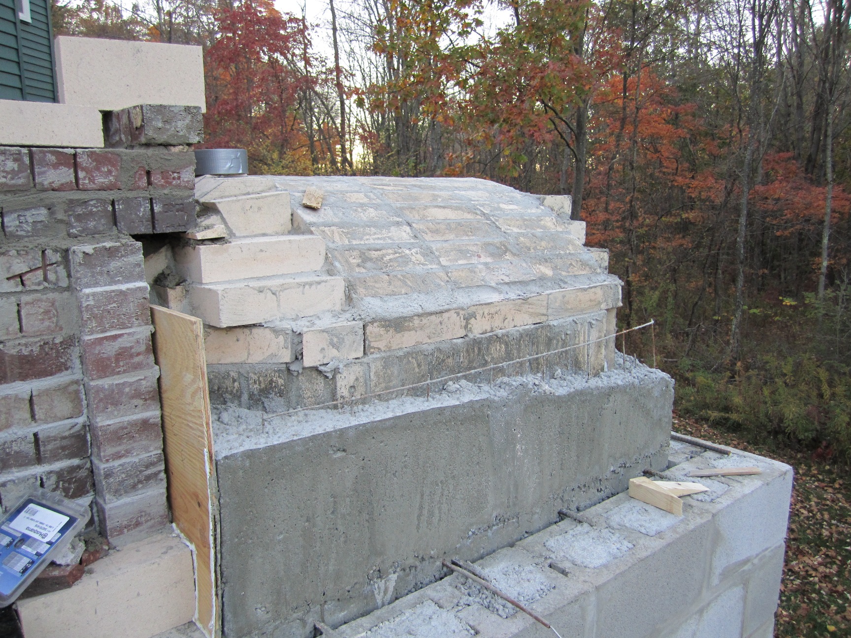

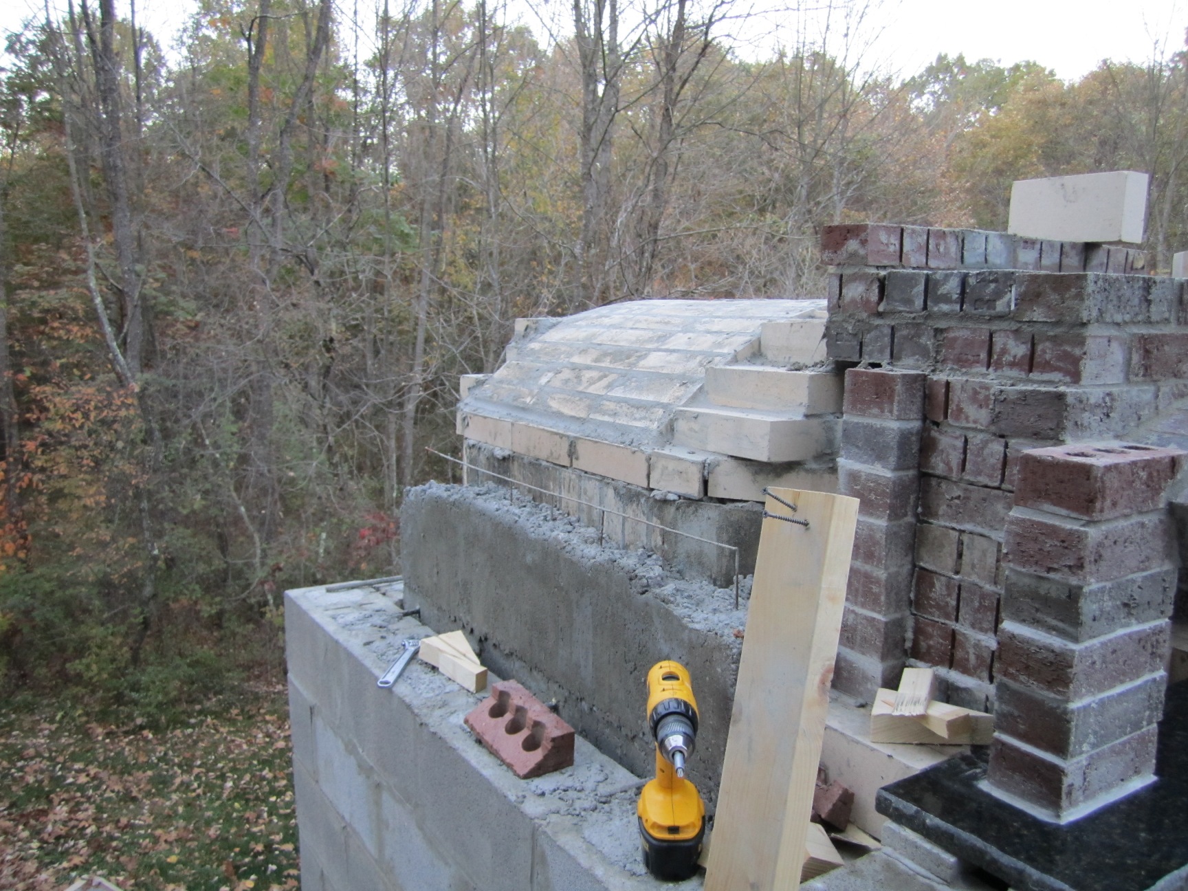

Now things get a bit more interesting. I removed the forms to clean up around where I had poured the first part of the oven's cladding. This oven works by heating the mass and then allowing the mass to radiate the heat back into the oven chamber. More mass = longer available cooking times (as long as things are insulated well). This cleaning is in preparation for the rest of the cladding.
In these photos you can see how the oven is supported on the blocks with the rebar.

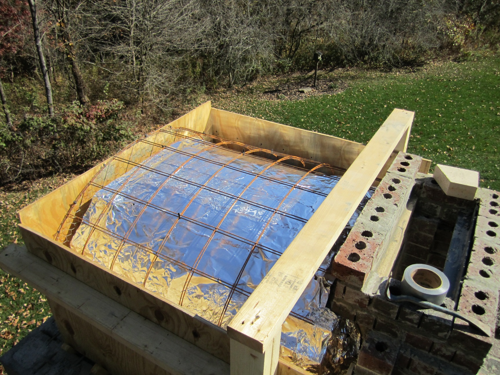

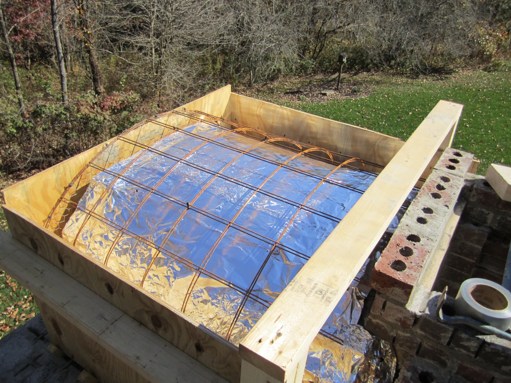

These next two photos show the forms back in place and ready to pour the rest of the cladding. The tinfoil is there to provide a slip barrier for the 3" to 4" of cladding I am about to put on top of this baby. Without the foil there would be considerably more cracking when the oven was heated up. Wire mesh is in the concrete for support.

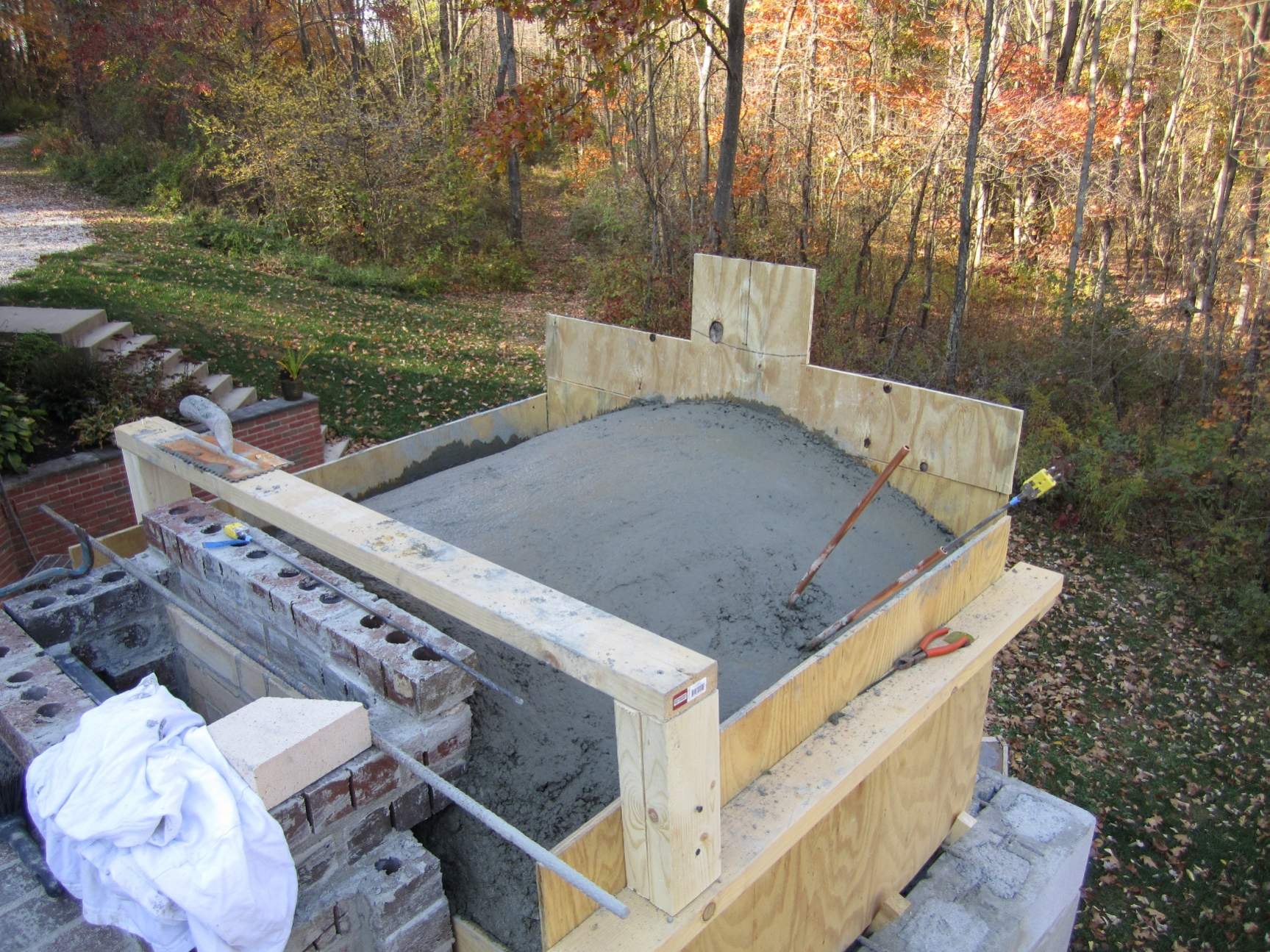

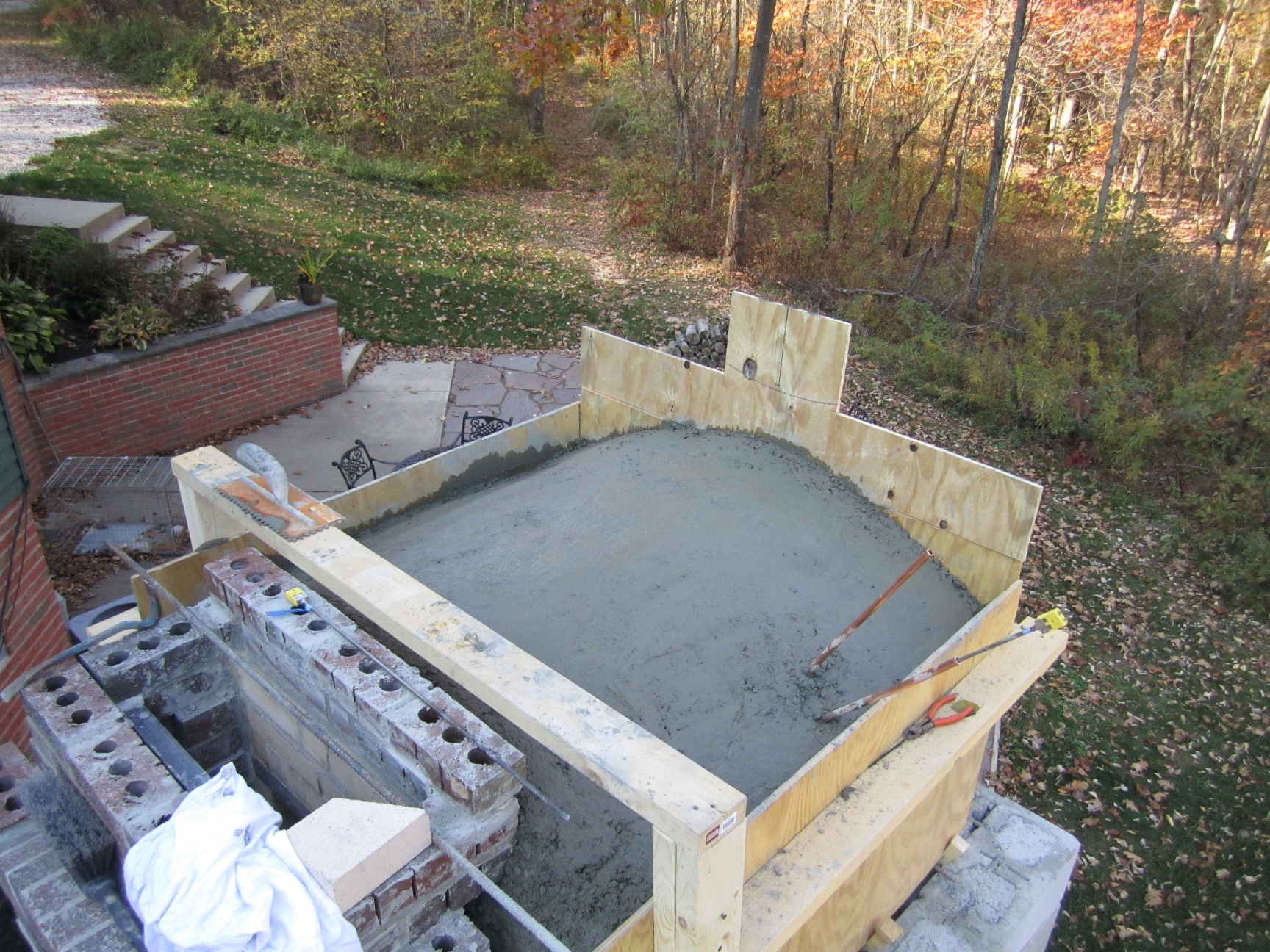

45 concrete blocks @ 28 lbs (I think) = 1,260 Lbs
3" concrete hearth = 700 Lbs
Firebrick for hearth, walls, and arches = 2,000 Lbs
What better to put on top............another 800 Lbs of concrete cladding.
Rented a cement mixer and hauled it up a ladder, one 5 gallon bucket at a time.
The two copper tubes are to allow for the installation of thermocouples.

Great job. I have really enjoyed following the progress of this project. One thing I am curious about is all that weight being supported by the rebar. Is that the only support for the oven? Looking forward to the final product.
They say the rebar is all you need, but I left supports under the oven as insurance.
