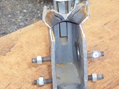

The reason the hold down didn't "hold down" anymore was because of this.:eek:

I was ditching and grading etc. Don't really know what happened to cause this. The other side Pats was bent and starting to rip also. Pats said it was the first one they had seen do this. Hey...I'm good at this stuff. Thats why I'm a professional, and run a successful business...
Don't try this at home Kids.:rolleyes:

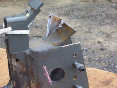

Another view.

:) The good news is that "Pats" is a very well run business. Talked to Vicky, and she said that they would replace them. Sent the very same day! And that was said before they saw the pictures.:)
She's also sending two new "U" bolts, that are grade 8, (hardened).
It is really great to deal with a concern that truly stands behind their product. No nonsence. No delay. No BS. I'm impressed!
This Pats is a Cat. 2.
I think I will also look into adding some sort of "fail-safe" do-gigger on the latching part.
