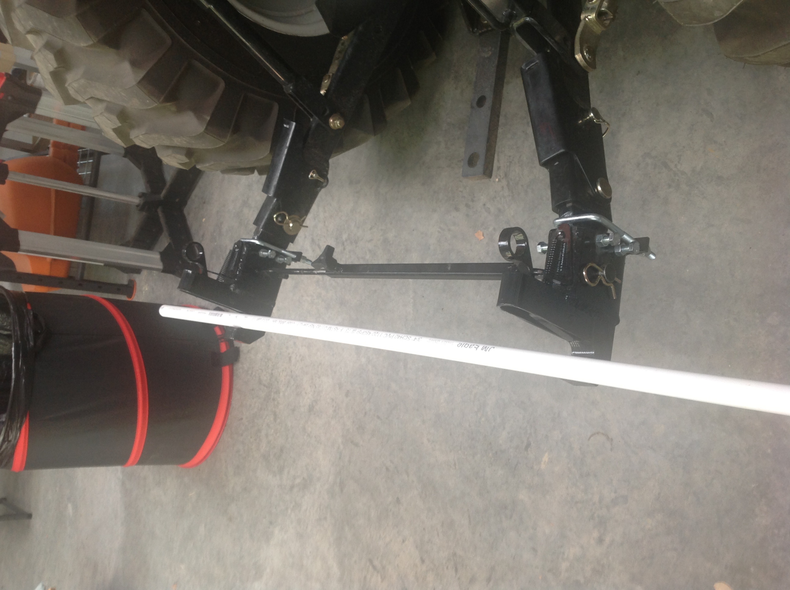

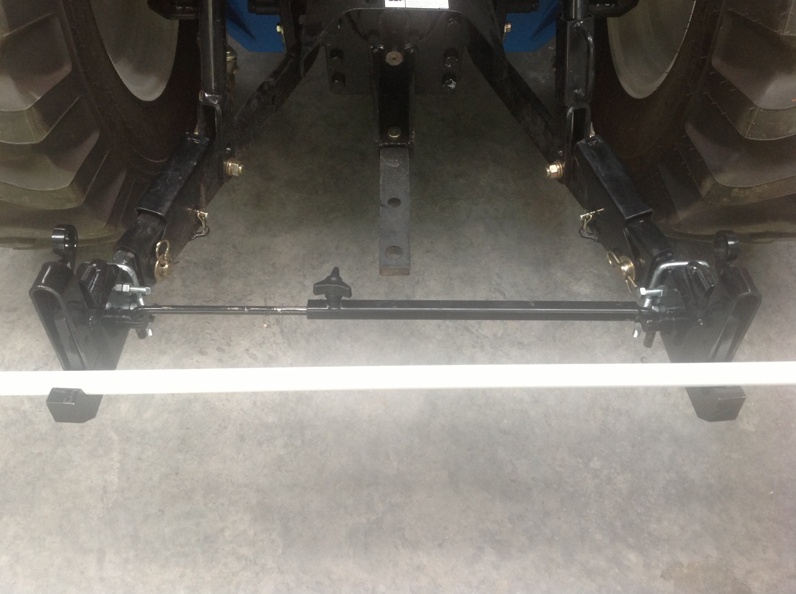

I installed these on my R3039 and have the hooks adjusted as far inward as possible and I still cannot get the hooks lined up to be parallel with the pins on my shredder. My shredder pins and my other implements are about 27" appart. Anyone else have this issue? Looks like I need more bend in my end links.

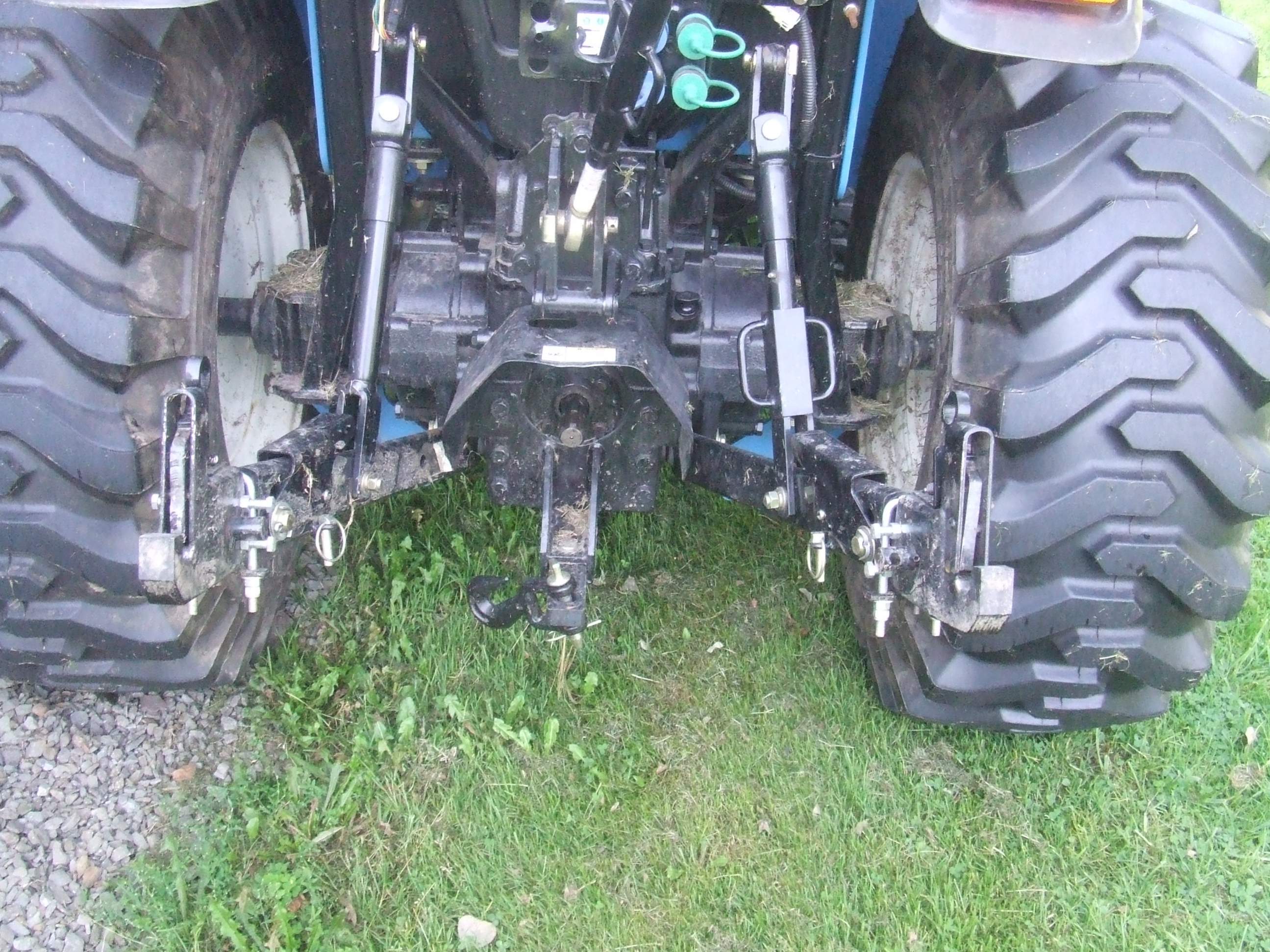

I have them on my 3039 no problem, at all,
however i never use the spreader bar with them, will try to get a picture of how i have them installed
jeff
fan 039.jpgi
Dumb question, but are you sure you had the big u-bolts loose enough when you were adjusting the set bolts?
I quickly ditched the spreader bar, after slightly bending it in the first attempt to line up an implement with a PTO shaft. I'm not sure why, but the geometry was all wrong with my finish mower. I still have to get off the tractor to hook up the PTO, and top link, so slightly adjusting the lift arm ends, and pulling up until they engage isn't a big deal.
After trying to get a set fit on my MF, and then putting them on my LS, I think the weld-on style is better, if you can do the work to install them.
   / Pat's Quick Hitch...anybody have them on their LS? Opinions? #14
Yep, I installed the U bolts last. I did do some grinding on my end links so I could put more angle on the hooks, still not perfectly parallel but I can hook up to my shredder now. I think if the the Pat's QH where a 1/8" wider I would have been good without grinding. Oh, I also switched them and that made some improvement also.
