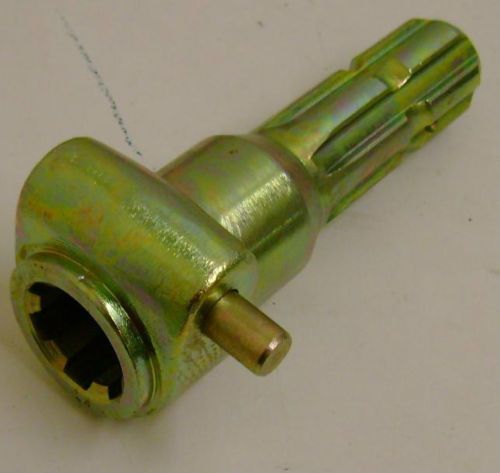

On the Cat2, you'll gain roughly 4" of extension to your lift arms. Once PEC is mounted correctly, ball swivel is essentially defeated. Wedges of various sizes are included with the PEC, which - when installed per instructions - render the PEC device rigid. That 4" should remedy the issue of tire strike when operating blades at a latitudinal angle. But it may become an issue with PTO-driven implements. Many PEC owners by a PTO shaft extension (adapter) for those occasions.
A no-cost alternative might simply be to widen your rear track.

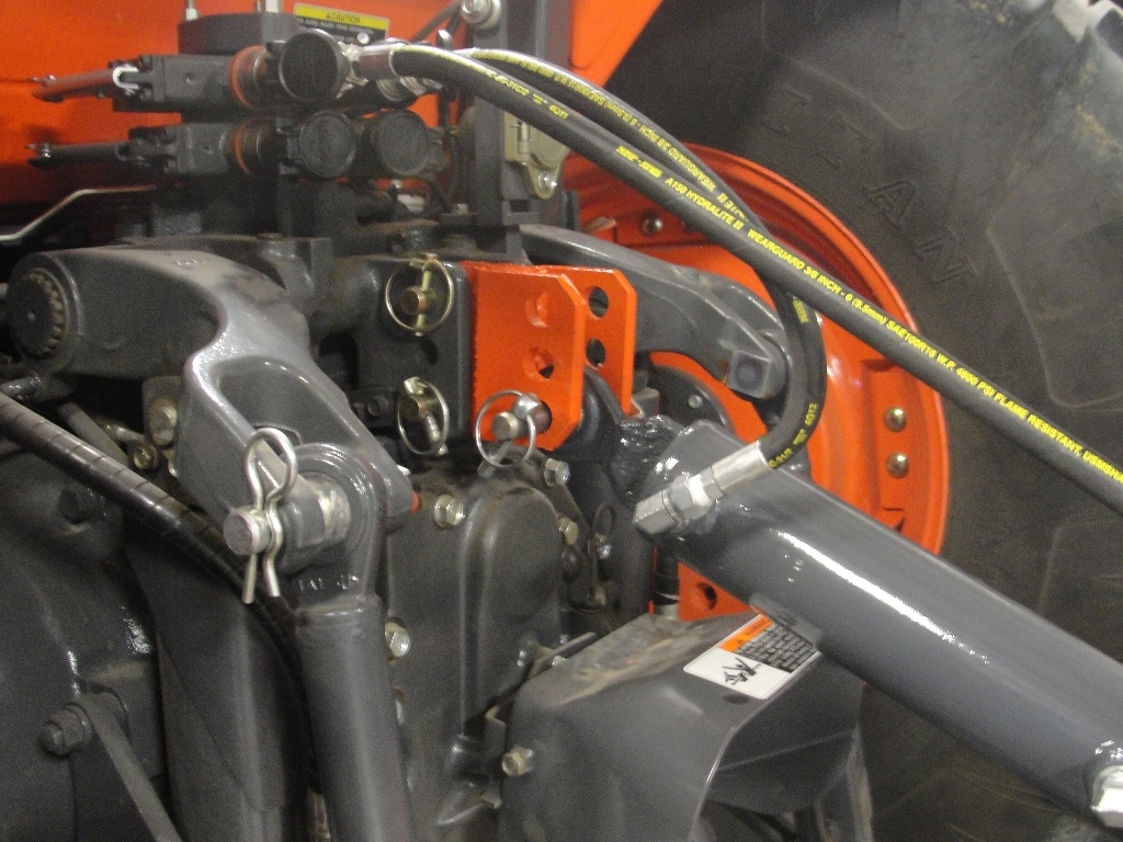

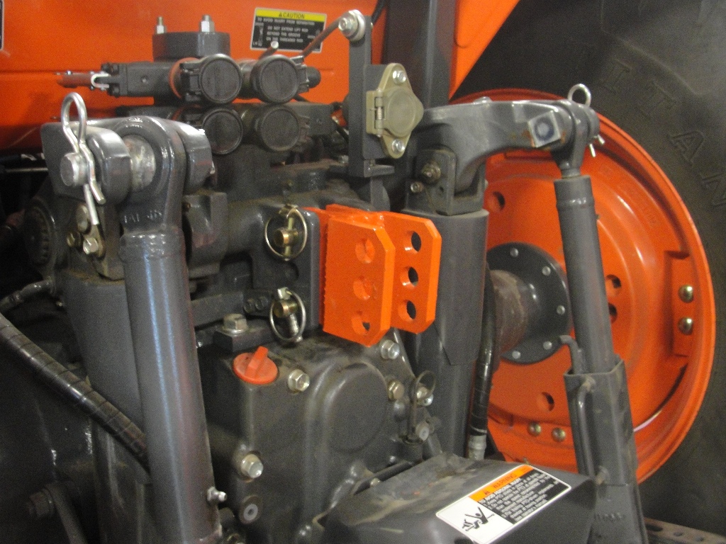

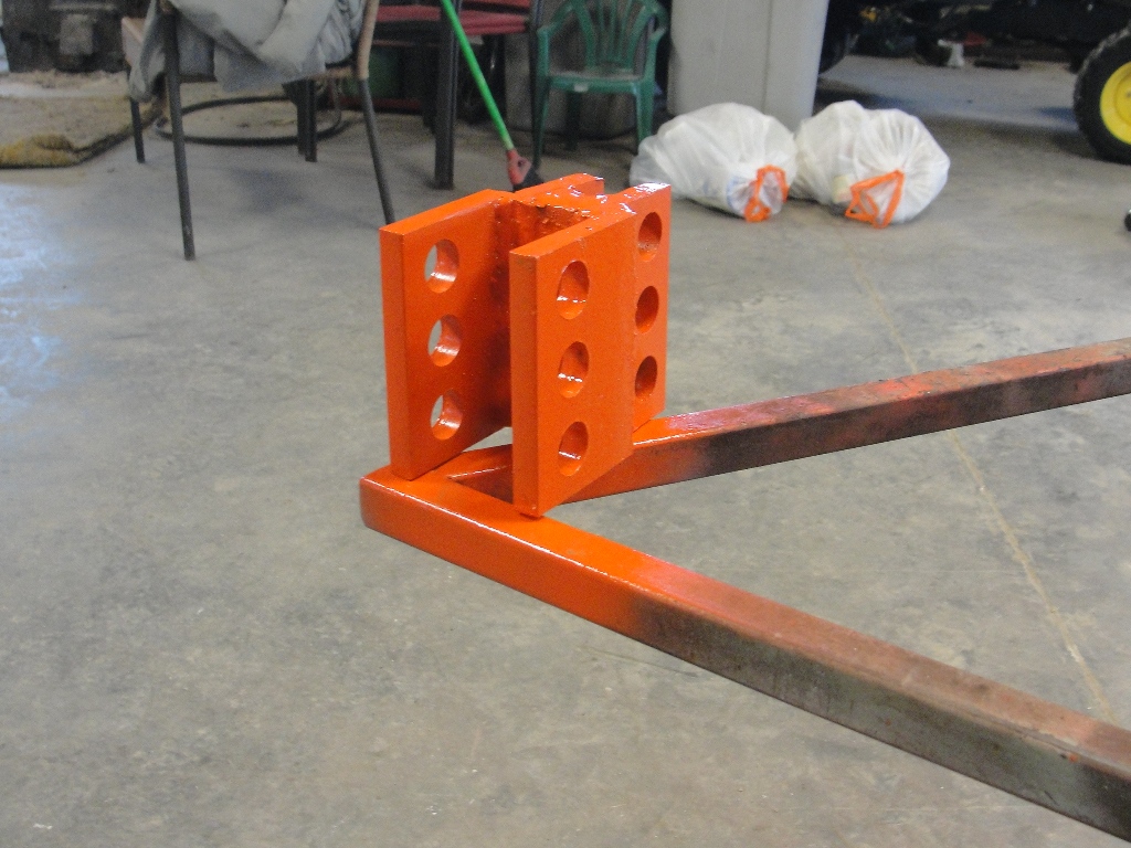

Here's a solution to that problem if you are a fabricator. I built this one. Maybe someone on here knows of a commercial source for such a device???

ovrszd, I like that ext. looks real close to the john deere top link hook up on the 5320. does that extend your top link about 3 inches?
Yep. Thought I might need it when I started using a QH. Built it and threw it in the chain box on the tractor. Haven't used it yet.
