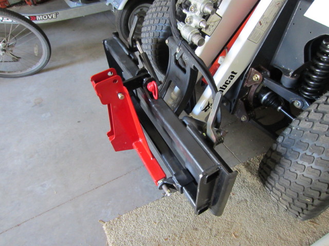

I wanted to install the Pat's system on my SSQA to 3pt adapter and the easiest way would be the weld-on version. Well, they don't sell the weld-on version any more. Then I thought I could use the standard CAT 1 version but needed the dimensions of the pocket that fits over the 3pt arm but I never got a response back.
Not sure if you're still working on this, but mine are off awaiting new bolts. If you need dimensions of the Cat 1 'pocket', let me know. Toukow
   / Pat's Quick Hitch #7
Thanks!!!! I sent a PM today.
