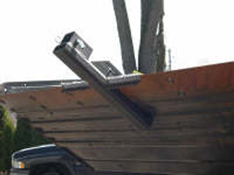

   / Payne's Hitch Receiver #8
Could you weld some "wings" on it like this? It would help prevent rotation during a "push" condition.

   / Payne's Hitch Receiver #9
I have had the same problem with a home made one myself. the 'wings' are a must. But I also made mine with a hole drilled in the bucket and pin through it.I trust this method far better that the 'clamps' on idea. I assume with wings and flat ground the clamp ones would do ok. But the pin or bolt through it is the way to go. I have also used this hole int he bucket to mount other attachments that I have.No regrets.
