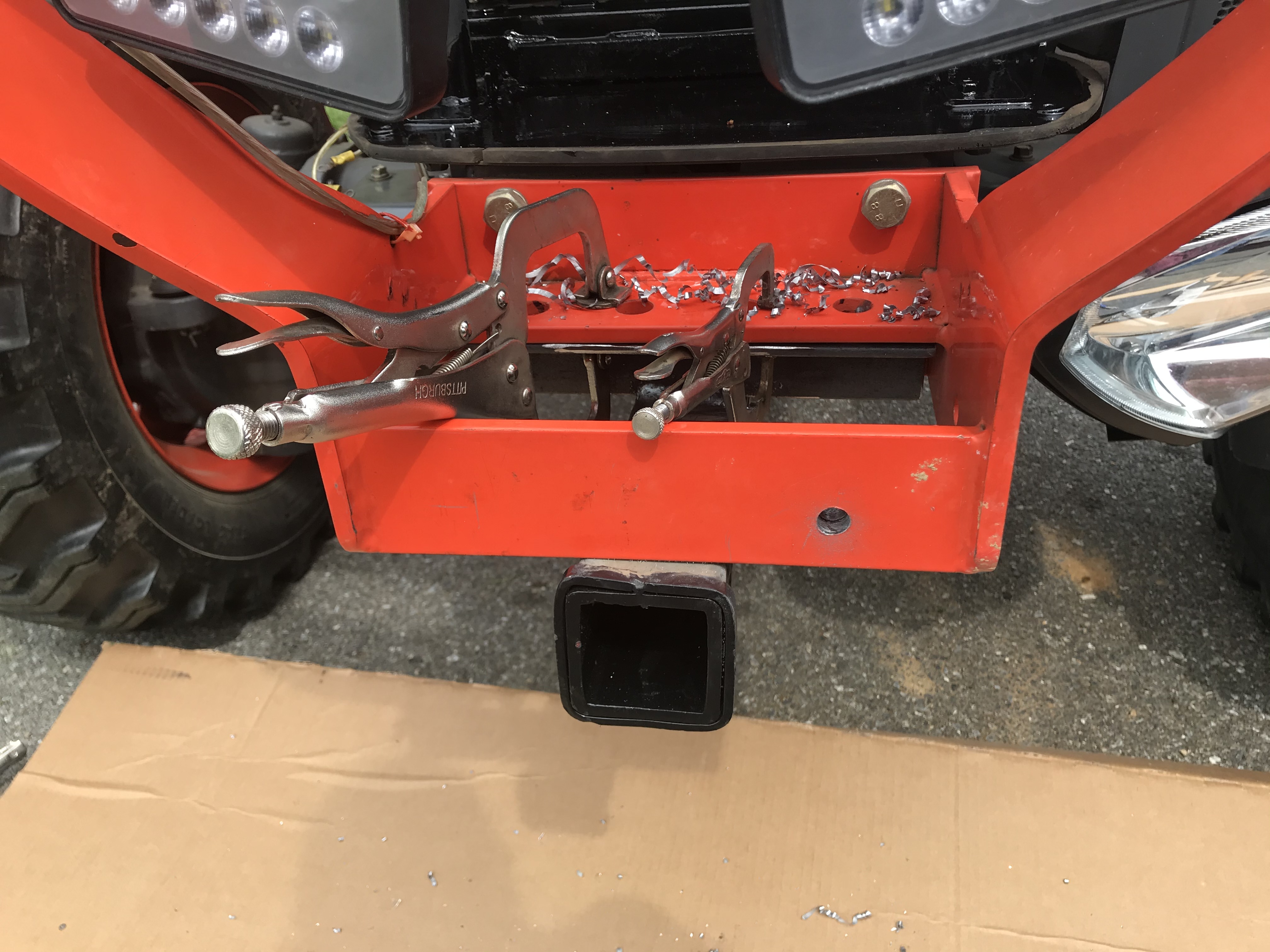

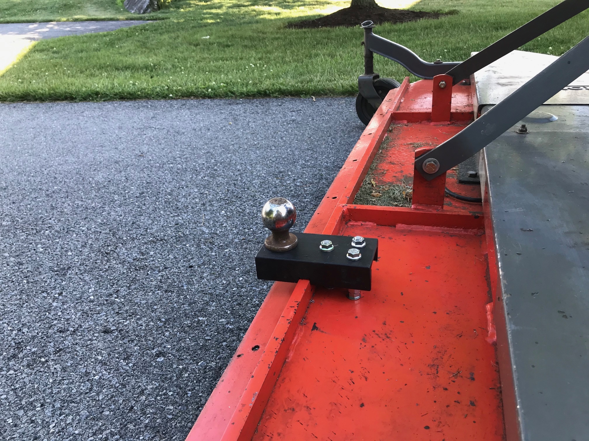

Have a receiver on the bucket and a receiver on the brush guard. Mounted a ball on the RFM so I can move the utility trailer and generator for mowing. Had a ball on the bucket of the last tractor.
