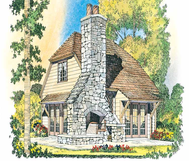

hi all --
-- i am looking at building a hobby house near my pond, only 1,000 sq. ft. total, 2 floors.
it will need heat when i go out there -- ie, heat on demand, and i don't see using it every day in the winters, etc.
any suggestions on going wood vs. pellet stoves?
thanks!
eric

Being in NY and having plumbing you will need some sort of regular furnace type heat right? Or do you intend to have this stove provide even freeze protection such as a thermostat operated pellet stove?
So the wood appliance is more for that extra kick and for fun? Then go wood.
Pellets aren't all they're cracked up to be and with cheap wood in the NE and expensive pellets I would rather burn wood in an appliance that needs no motors, bearings, or electronics replaced on a regular basis.
Plus, unless you like the look of a crack pipe fire, the woodstove is nicer to watch and silent.

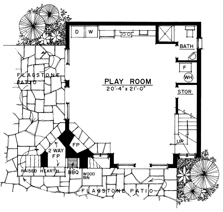

hi all --
-- i am sorry, i didn't provide all the infos --
-- i am not running plumbing out to this little cabin -- it's going to be 700' off the road, or 400' from my house --
-- i can't justify running water and setting up septic out there yet at all, so the place can freeze up cold in the winters.
that said, i will have electric out there.
so, you're thinking wood then?

I still don't get what the point is. The intended use of the hosue is pretty important.
Will you go out there for a few hours to read, or do some sort of craft and then come home? So you would want rapid heat up and then shut off? Then I would go with a propane forced air unit, electric wall heaters, or even a pellet stove. Rapid warm up, forced convection heating, and ease of use are important here since you don't want to spend a half hour messing with the stove and then leave an hour later.
Will you go out for a day, or overnight with no plumbing? If so, the longer time frame lends itself to the woodstove. For the pleasure.
My home is a combination of thermostat controlled electric wall heaters and woodstove. So I am biased that way if you are looking at longer heat cycles.
A propane stove can be very attractive and capable heater. Check out the vermont castings line.
