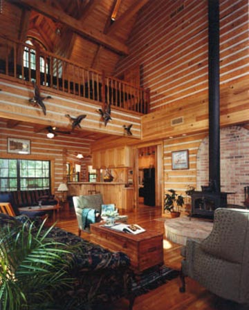

We use a Vermont Castings "Defiant" woodstove to heat up our 3,800 sq. ft. cabin.
