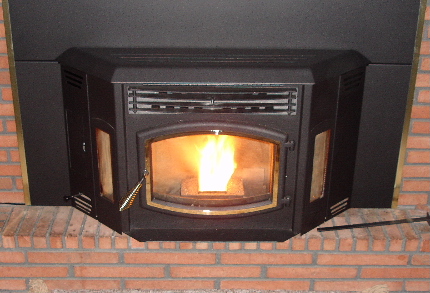

I installed my Breckwell P24I 2 week's ago and could not be happier. Mine also uses 1 bag every 12 hours and keep's the house at 70 unless the wind is blowing. I am not sure if I am saving any money because pellets were $5 a bag and that was buying 3 ton's. Didn't have much choice to pay it though because the place where I bough mine was the only place that had any and when I left they only had 2 ton's left and were not sure when they were going to get anymore.
